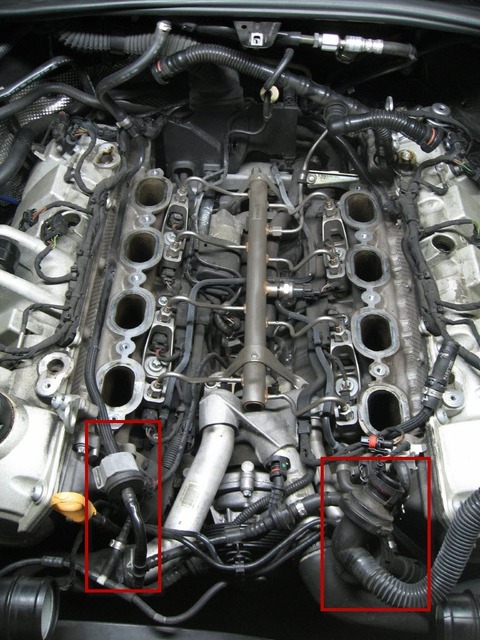

This is the cause for the P0441 code. The photo shows 957 engine. So for the 2006 955 that evap purge valve (red square, left) will actually be on the opposite side of your 4.5L motor. And, NO - the intake does NOT need to come off. Here is the eBay link for the part. Only the rear and throttle engine covers need to come off:
http://www.ebay.com/itm/150673680378?_trksid=p2060353.m1438.l2649&ssPageName=STRK%3AMEBIDX%3AIT

No difference. Use my eBay thumbnail link on my previous message, with photo. The part is a long tube, with a small valve at one end.
