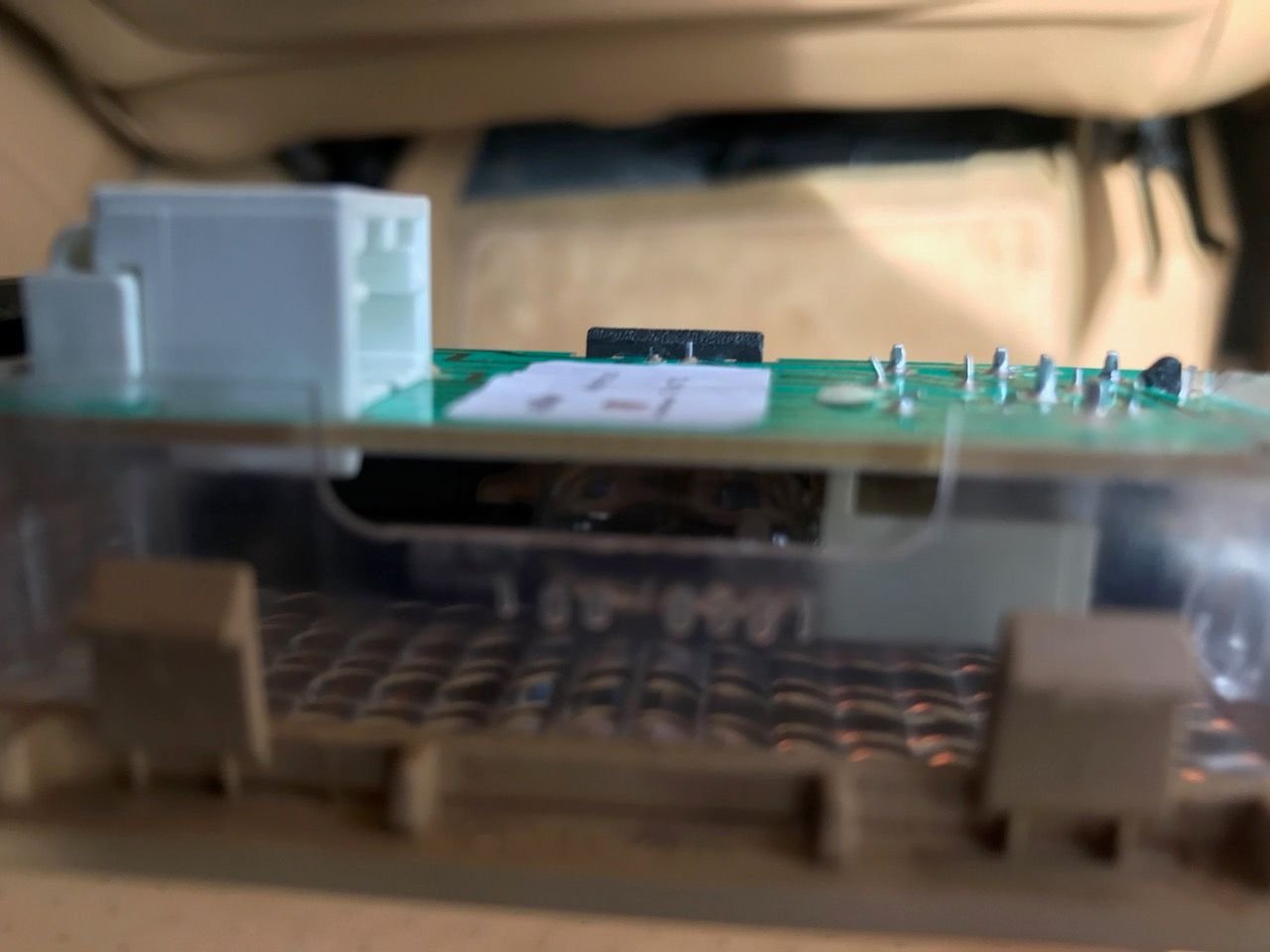

1. The rear Map lights. Now these are held on with a torx screw and once removed you can pry out the light housing. BUT the actual bulb is hidden under what looks like a logic/fuse board which is held in all around by plastic clips. It looks like if you remove this board to get to the bulb you will either break it or disconnect metal pins that seem to touch the board. So how the hell do you get to this bulb ? Do porsche think you will never need to replace this bulb ???

These are the photos, as you can see the bulb is hidden under the fuse board and I can't see , without maybe breaking the tabs, you can replace the bulbs. I am sure some like minded people have replaced these so guess its not impossible

Don't those black tabs flex a bit? It looks like bending the side ones outward would release the board.
Yes and no. Yes they flex but then the white clear tabs also hold it all in and me being all ham fisted will probably break them !
I was just wondering if anyone has attempted these lights and bulb changes and if so any tips
I will have a go gently and just pray that nothing breaks !!

Well all sorted
Grabbed some cheapy shorter LED bulbs for the dome lights at the front which go in a lot easier than the first LED and all working lovely
then found out how to remove the fuse board from the map lights
It turns out that you push the clear plastic tab (circled) and then lever it out in the direction of the arrow

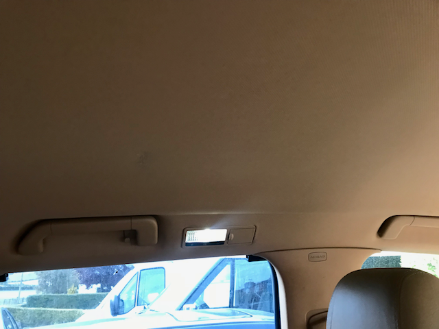

Simple !!
and much better
