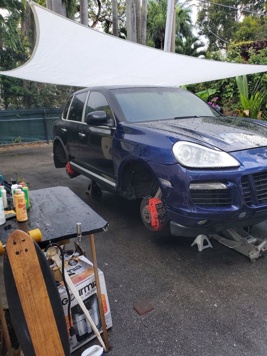

I'm having the EXACT SAME symptoms. Along with terminal 30 implausible and i have Zero brake lights, running/ turn/rev lights work. Did you ever resolve your non- wheel specific ("A") speed sensor code?
Scanner sees front 2 wheel speeds but doesn't even have the rears as an option to see, which is weird. Scanner see brake switch activation and brake light switch activation but no brake lights turn on.
Things I've done:
Replaced both batteries with H8.
New Cardan shaft
Re-spliced every connector under both sides of carpet.
Checked All fuses.
Replaced 433 relay.
Replaced all 4 wheel speed sensors.
Cut and checked FR ABS harness.
- there is more I just can't think right now haha
More to come:
I purchase a $1200 Autel Scan Tool because the icarsoft POR-11 wasn't specific enough. Seems this scan tool pointed me to look at a couple relays i hasn't taken notice of before. Upon inspection of said relays, I noticed they were burning hot... I didn't bother testing them as this was last night, I'm replacing them with new layer today, as preventative maintenance for any future failures.
I purchased this at auction and it seems the previous owner had curbed it really bad. The air suspension is slightly lower on the front right and from researching forums I decided to buy a new valve block, going this will solve the air suspension issues. But again it's locked bc of the ABS code so I can't even test its functionality until I resolve the BRAKE PROPORTIONING WARNING...
Also there was water intrusion into the left brake light when I received the car and the brake lights actually still worked under water.. when I replaced the tail light assembly is when all brake lights stopped working, again reverse, blinkers and running lights work.
I'll try to update later after I replace these relays.
