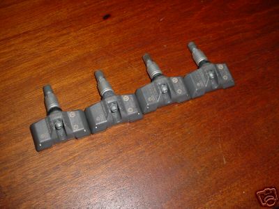

Can I buy someones takeoff 19's if the rims have TPMS mounted? My Cay doesn't have that option. How are they mounted? Can I remove them? Pic's?

This is what the TPMS sensors look like. You should be able to remove them from the 19's (if you dismount the tires, obviously) if you don't have the TPMS system. They attach through the valve hole in the wheel. I would think you could purchase the 19's, and sell the sensors someplace (i.e. the classifieds here or on eBay) if you don't need them.

thx for the pic... exactly what I was looking for!
