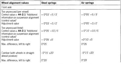

The dealer aligned the wheels and camber at Normal level.. I now know I should have instructed them to do the alignment at low setting because I want to use it more at that setting. To bring it back to the dealer, they will charge me $300 to re-do the alignment. An independent shop will do the alignment for $140, but they were asking me for the values to do the alignment properly. I wonder if anybody can provide me with the proper alignment values to align wheels at lower setting.

just get them to align to factory specs but just at a lower ride height.
they will need to just adjust camber & toe - pretty easy job
$140 for an Indy? and $300 for the dealer? DAMN...
If your indy with the alignment rack doesn't have a machine with specs already in the software I would be weary... and for $140!?
Porsche alignment specs are only for the normal ride height position. Using these specs but at a lower ride height will change handling characteristics. (unsure just how much of an impact) However, they are probably the best specs to use to ensure good tracking and tire wear.
