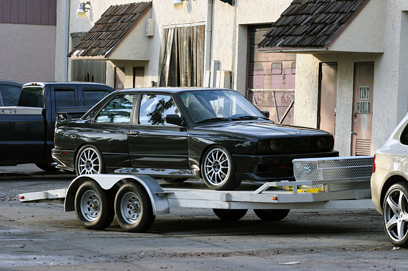

I use mine almost exactly how you intend to use yours. I have an '05 Cayenne S towing an E30 M3 with an aluminum trailer. I absolutely love it. I towed the first few events without the electric brakes hooked up and while acceleration was no problem at all, I did have to give myself some added room for stopping. Last weekend we finally got the Prodigy electric controller hooked up and its much better.
I know that some of the issues we had with hooking up the controller had to do with the fact that I have a late model 05 and on those and 06 model cars, the brake switch is nowhere to be found. 04 should be no problem and you can read about the details on the connections here...
http://forums.rennlist.com/rennforum...ferrerid=20609
Here's a few pictures of the Cayenne, trailer, and race car.
Good luck in your search...

nice e30 hyboost!
