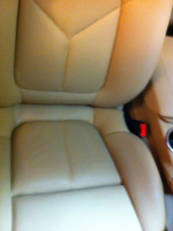

My package from Amazon arrived this afternoon and since I had a few hours to kill before attending tonight's festivities I figured I might as well start the new year with clean seats in the Cayenne. UPS was kind enough to drop off a box this afternoon with the following items in it (all ordered from Amazon):
  • Lexol 100 pack Quick Wipe Leather Cleaner Towelettes (link:
    Amazon Amazon
  • Lexol 100 pack Quick Wipe Leather Conditioner Towelettes (link:
    Amazon Amazon
  • 100 pack Large Blue Powder-Free, Fully Textured Nitrile Gloves (link:
    Amazon Amazon

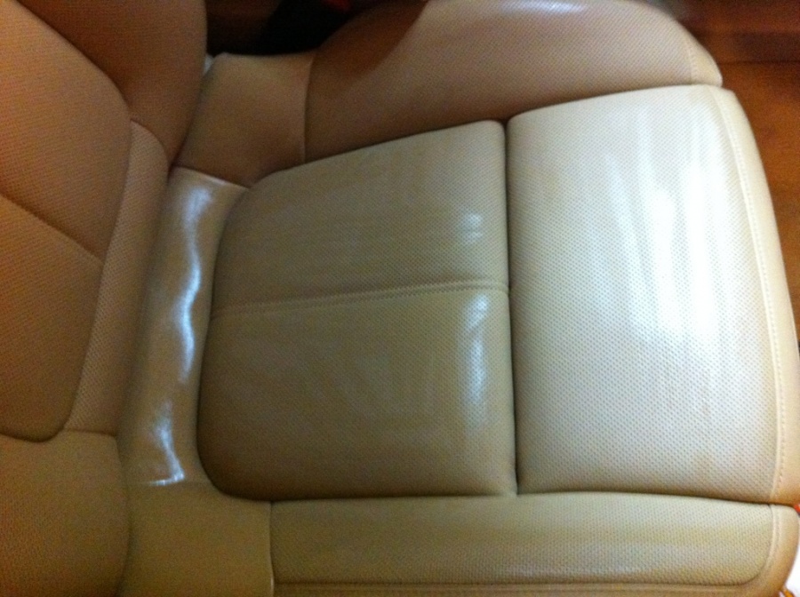

After opening the boxes I was ready to tackle the dye transfer from my jeans onto the beige seats. You don't need anything else beside a packet of cleaner, a packet of conditioner and a dry towel per seat.
Open a packet of cleaner and run the moist towel all over your seat. You might need to scrub and rub it in a bit harder where there is extra dirt (of dye transfer) on your seat. Don't rub it too hard onto the seat surface where it is perforated because you don't want any moisture accumulating in there. Once you have scrubbed your seat down leave it on for a minute. I would not leave it on any longer because I do not want it to dry. Once the minute is up dry the seat with a towel/clean cloth.
Next you want to open a packet of conditioner and rub it all over the cleaned seats. Again, don't rub it too hard into the perforations on your seat because you don't want it to be trapped in there. Once you are done and you have the seat nice and moist you want to wait a few minutes for the conditioner to soak into the leather a bit. Also, at this point you want to make sure you don't have any streak lines because you don't want the leather to dry like that. Eventually it will fade but I personally don't like it; if you do you can ignore this step. After the few minutes are up dry the seats with another dry towel/clean cloth. Some residual moistness will remain on the seat, which is a good thing, it will be completely absorbed by the leather in a few hours so don't worry. Don't expect to put the conditioner on your seat and then drive the car off. I'd let it sit overnight.
After this you are done. I've attached a couple of shots I took while working. I've never used Lexol on cars before but, according to my wife, we've been using it on our leather couches for years. The whole thing took me about 30 minutes to do and I plan on doing both the cleaning and conditioning once a month from now on. So far Lexol has not let me down and I get to wear jeans in the car again.

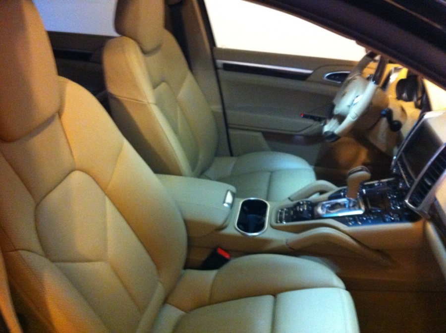

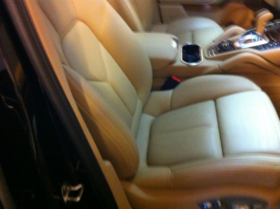

Here are two more of the cleaned interior...
