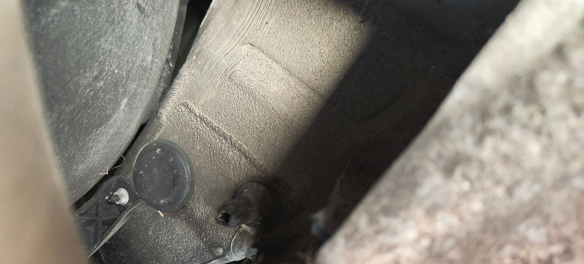

Solved the problem in my case
In my case ,i was at the car wash and when i came back to Collect the car jumped in the car and was a warning that the boot is not closed, went back to the boot open it again close and the same thing,i thought maybe the cleaner forced the boot and it destroyed it .
Opened the boot again and found some debris under the flapping metal remove the trim ( if you don't know watch an instruction how to remove it there are some plastic clips that you may break).
Cleaned everything and it looks that is closing properly.
Also it did have some water inside the spare wheel space, unclogged the diesel draining,and went under the car and cutted the noses of the sunroof drainage,one of the plugs when i squised water was coming down,from the last wash or rain it was more then 24h so no water supposed to be in there at all.
If you do have the same issue it might help, hopefully.
Some pictures are attached to understand better what I mean.
