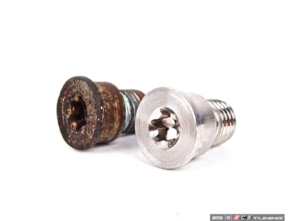

The factory rotor set screws are easily damaged during removal and by the excessive heat and elements that they’re exposed to on a daily basis. If the screws on your rotors are corroded or damaged, replace them to make your next brake job a bit easier. These stainless steel screws will not rust, and can be used again and again when changing your rotors.
Plan ahead. Install stainless screws on this brake job, and you won't have to drill them out on the next one.
