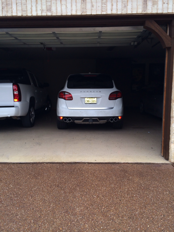

Nevermind got it

Is it the shiny piece between both tailpipes?
Old Jan 9, 2014 | 08:04 PM
solrac6262's Avatar
Joined: Jul 2009
Posts: 1,219
From: TX
Rep Power: 71
solrac6262 is a name known to allsolrac6262 is a name known to allsolrac6262 is a name known to allsolrac6262 is a name known to allsolrac6262 is a name known to allsolrac6262 is a name known to all
V shape stainless steel piece
no DIY, buy the skid plate, you positioned the thing on the actual plastic and you need to cut with a razor blade the black plastic, in order to fit a few tabs that go inside the cuts once inside, you need to bend them to hold the skid plate..
first you have to get the full bumper off

2 hour job with 2 guys lots of fun and getting the bumper off is very easy
