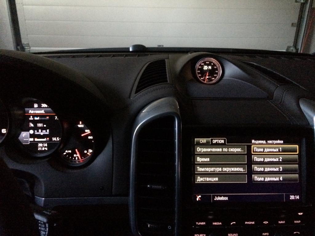

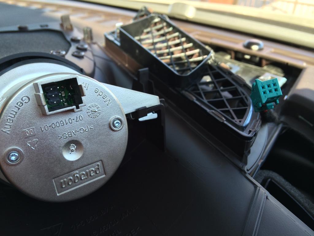

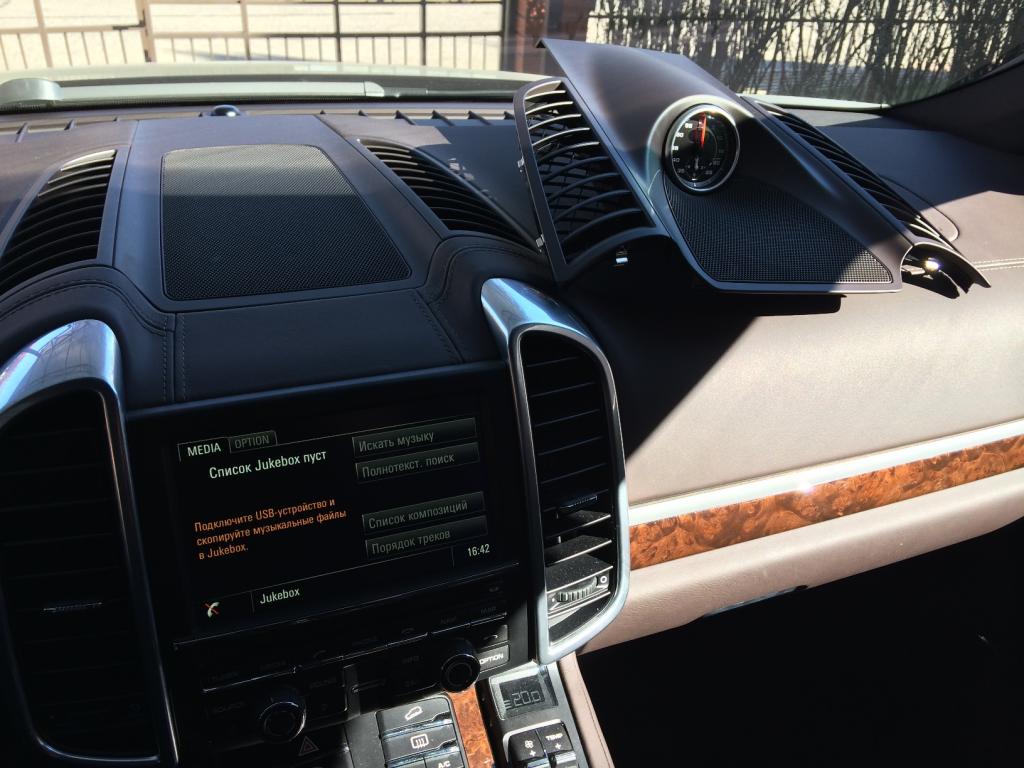

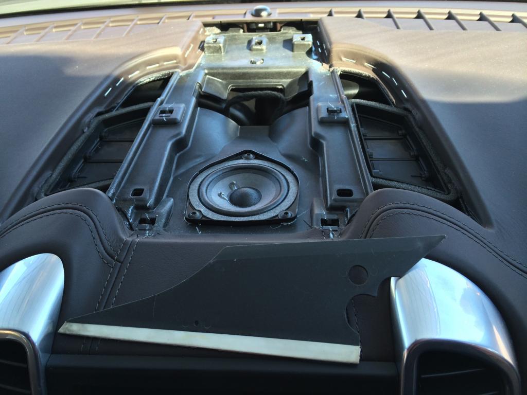

omg... ))) what you mean with this words "useful review"?? there cant be more than three lines... what to write about? ))) how to pull up panel? or how to push dealer to program my car? ))))
this for you boys http://www.ebay.de/itm/190884796457 it took so hard to find ))) they are americans so you can call them and ask how many they sold. this one http://www.ebay.de/itm/380856850202 also sold many of, but without cable. this http://www.ebay.com/itm/351062556034 also trusted seller
and please - just stop this "modern car is so complex, wiring are missing"..

actually they say that its a plug and play, well, splicing 3 or 4 wires plug and play. Apparently no dealer coding needed. I am also looking into this. and spoke at length with the guys selling the kit online as well. I wanted to add the chromo/watch combo..
