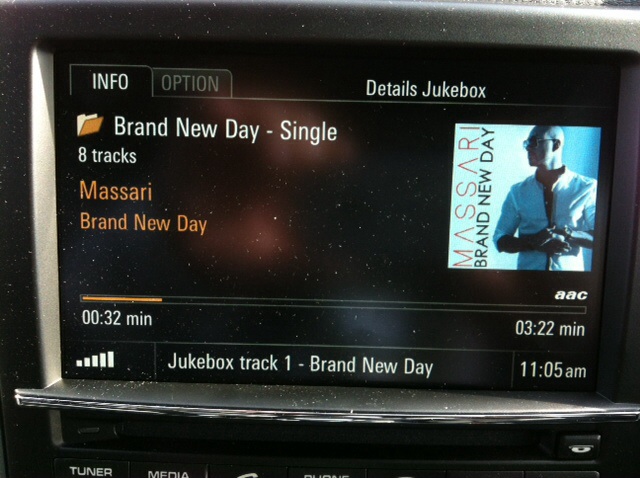

Harlequin, album art and Jukebox are introduced together for car built dates starting Nov 2012. It is strange that you have the Jukebox but not the album art. My album art shows up on Jukebox, iPod or USB sticks, and CDs which contain metadata music files. Store purchased audio CDs and songs played through Bluetooth do not show album art. My software version is only 4.52, not as new as yours. So you should definitely be able to get album art. Most of my songs are bought from iTunes and they all contain album art.

Harlequin, you may want to plug in your USB stick into a computer and see if the songs contain album art. The way I do it is I copy and paste my iTunes songs into music files outside of iTunes, and I use a free program called MP3TAG to 'tag' the metadata onto each song. And then I copy and paste the songs onto a USB stick. I have over 500 songs in my Jukebox arranged in different folders and they all contain proper album art. I have also ripped many of my old CDs into my computer and I search online for JPEG images of the album art, best resolution is a 600x600 square photo, I then use MP3TAG to tag the album art onto the songs. You can easily search online to look for album art for any of your songs that do not have them. Hope this helps.

Oh wow you do some serious work to get the art going. Isn't the image you see for the art small on the PCM screen? It seems like a lot of work for a small image?

You can get a bigger image by selecting show Details. I don't know about XM since I do not have it. I do have Porsche Online Service and it does show artwork for every song and any audio program.

OK TGED I have the answer. I took a few songs and played them on Windows Media Player and I see the album art on there. But when I take the same song and bring it to the car on a USB stick it doesn't show album art. I also went to the show Details page and still see the ever present music symbol but no art. So it must not have been in my hardware and I am also thinking that mine might have been built in Oct 2012 when they were just starting to add juke box.

Harlequin, can you find out what format and resolution your album art pics are? They need to be JPEG with a resolution of less than 700x700. Album art feature is not hardware related and I think your PCM should be able to display it.
