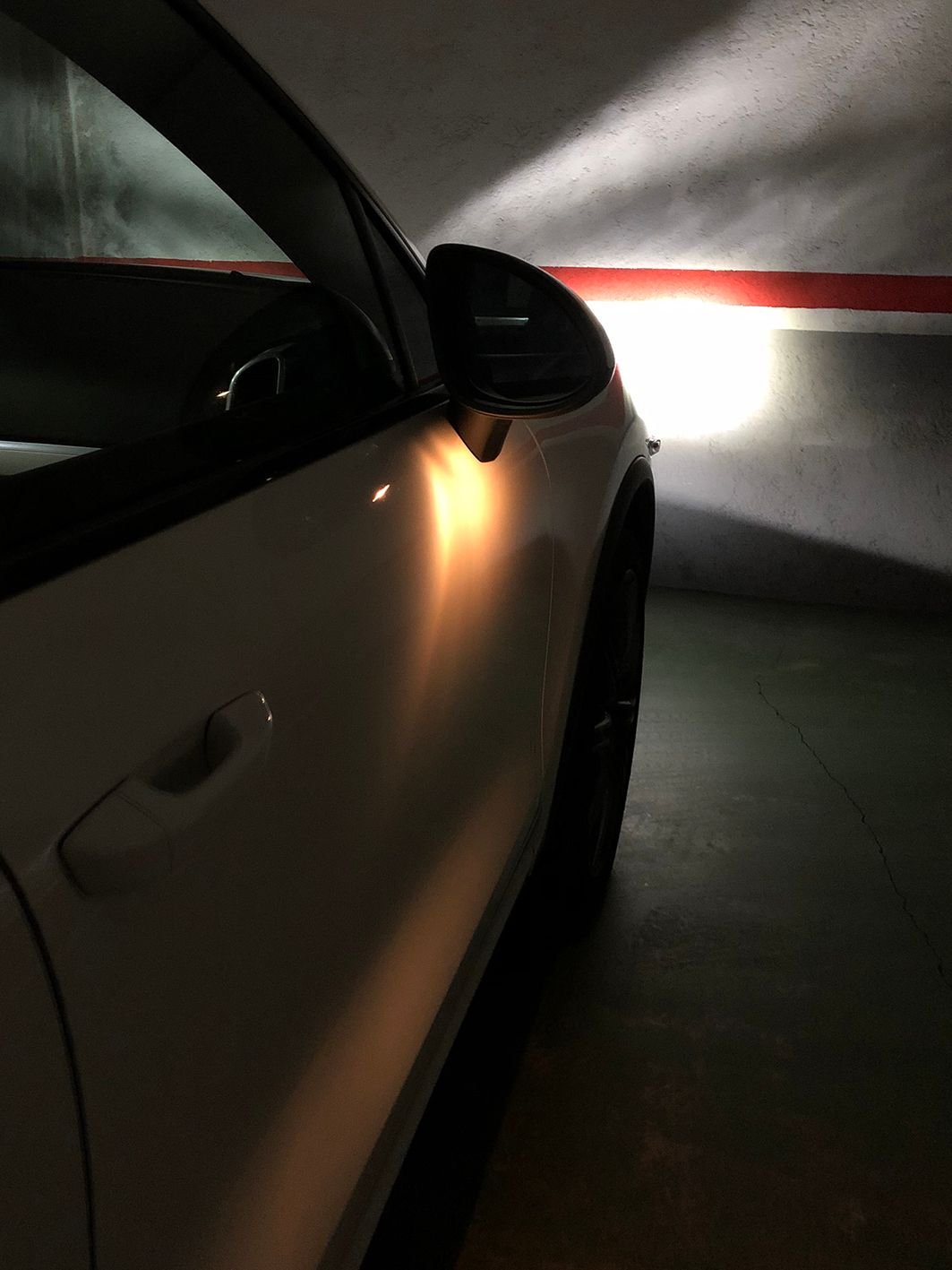

Regarding the puddle lights in the mirrors, this replacement is the most appealing IMO. The yellowish light doesn't match up to the LED daytime running light.
Replacing them is quite easy. Using a plastic prying tool, gently lever out the mirror glass. The glass is held in place with pop off retaining clips. Next, disconnect the electrical connectors. 3 torx 10 need to be removed in order to release the rear cover and gain access to the bulbs (be careful, it is also fitted with three locking tabs that must be pressed gently). Thats it! I have taken them out many times without any problem.

Just doing some spot-testing with mirror bulbs. The result is extremely worthwhile IMO:
Before
After
Before
After
