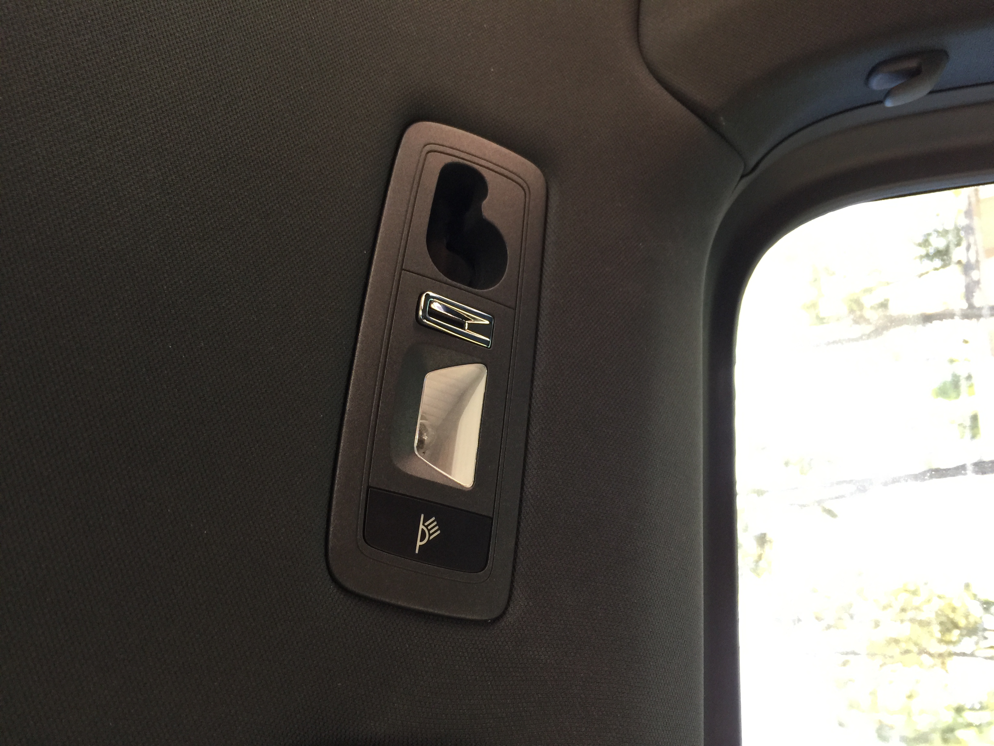

how do I change the light above the rear doors?

the rear footwells are a ***** and I haven't been able to change those out yet

I'm keen to know how to do those above the rear doors too?

Everything comes off with some prying. Definitely not for the faint of heart. A few times I thought I was going to break something but it was just the pressure clips doing its job.
