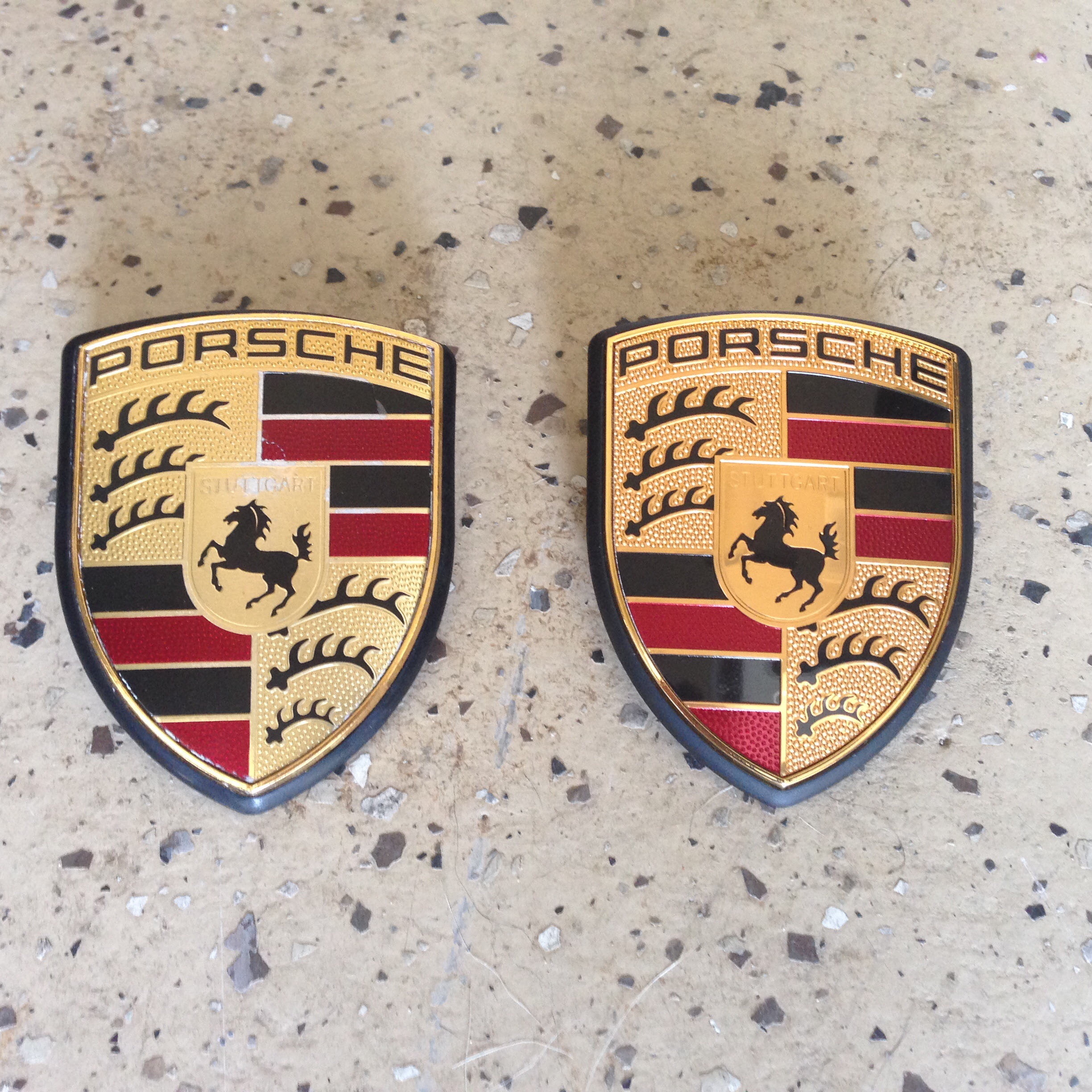

My original hood emblem took a rock dead-center so I replaced it with a new one from Suncoast. While a simple repair, I learned a few details worth passing along. For starters, the original 958 Cayenne crest was replaced by a new part that is much nicer than the original smooth crest. The new version has texture to it and has nicely defined details. The old part number stamped on the back of the original crest is 997.559.211.00 while the new crest is stamped 991.559.211.00. The parts number on the box the new crest came in was 95855960102. As stated in other emblem threads, an 8mm 1/4" ratchet is needed to remove and replace the speednuts that are recessed on each side of the hood latch. Make sure the hood is level during removal and install, and a piece of electric tape over the new crest helps hold it in position while setting the new speed nuts.
