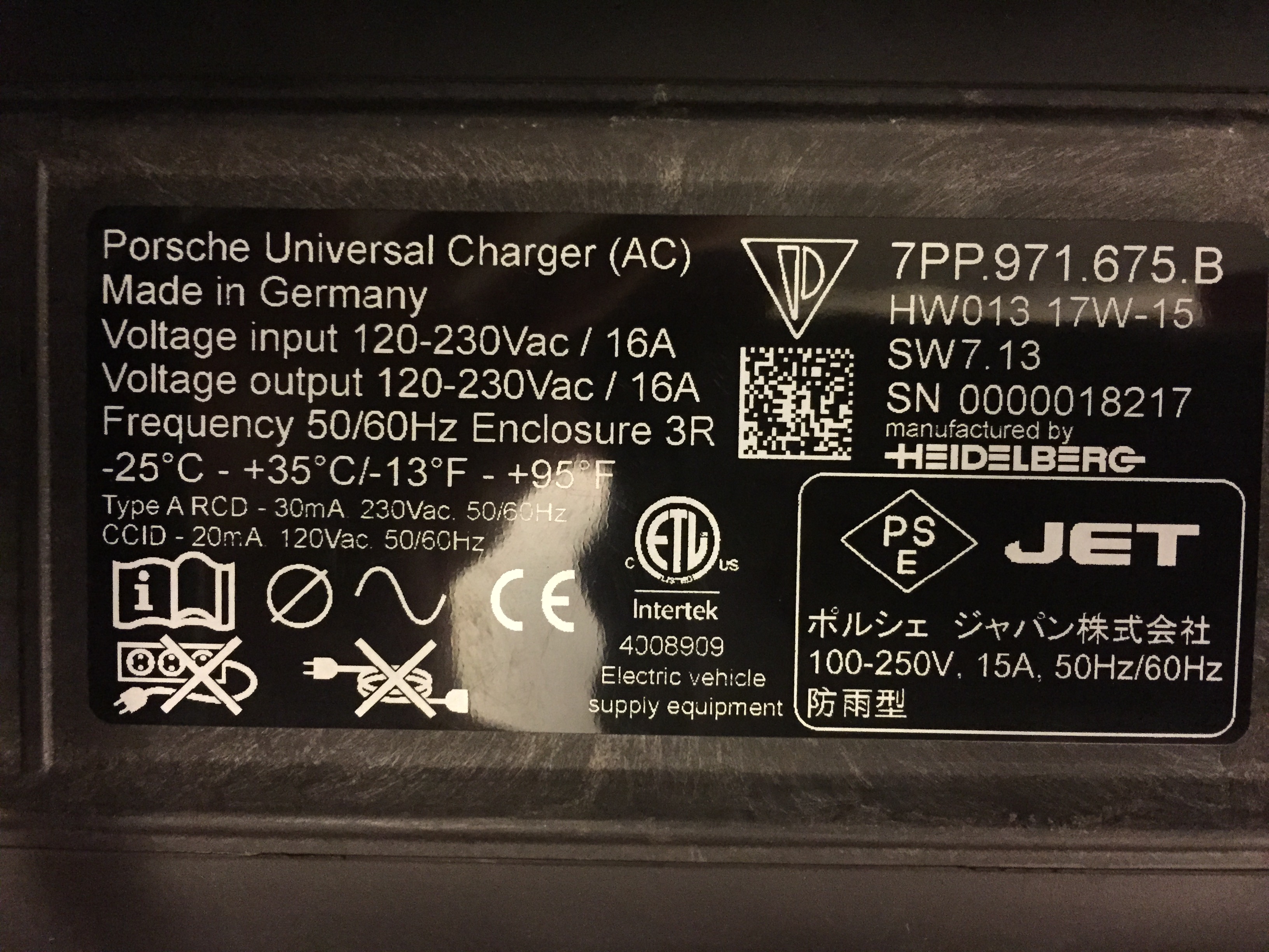

Thank you so mine is 3.6kw given it is standard one , I ordered mine from UK if I set my breaker to be 30-32 amp would it makes charges faster?

You can't charge faster then your charger's capacity (3.6kwh). So anything over a 20 amp dual pole breaker is a waste of $. Unless you plan to add another higher charge rate EV in the future that may utilize it.
