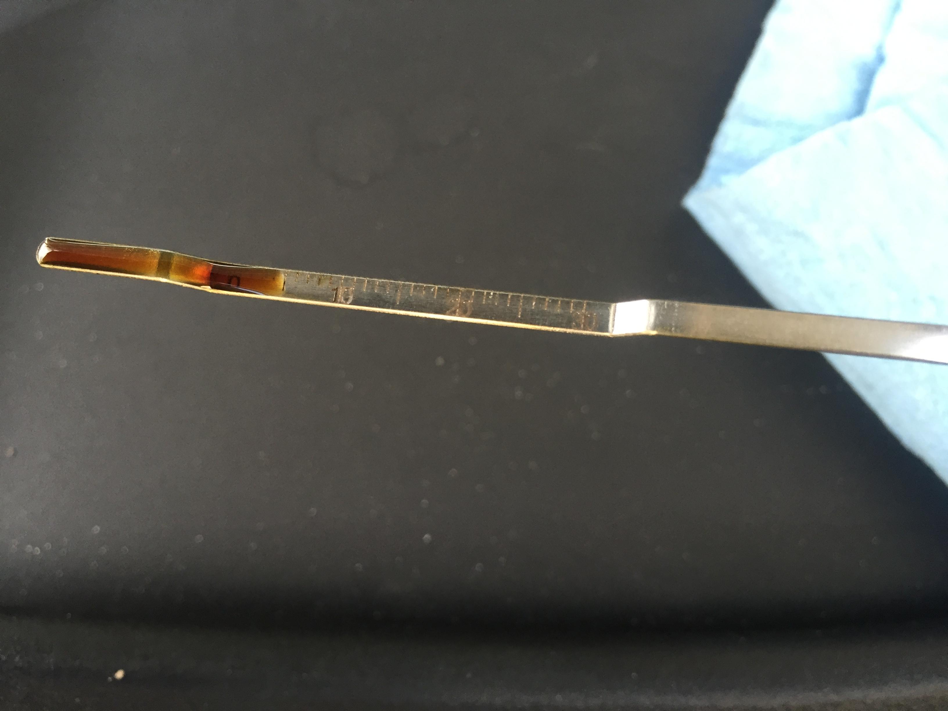

Arrived today and thought I post some pics of this thing.
My driveway is on an incline so this reading is probably not accurate. I'll check the reading on level surface this weekend.
Originally Posted by Qu4ttro
Wait... where would you insert this tool? I had the impression that our engines did not come with a oil dipstick tube.
See the pics where the tube is located.

I did the oil change yesterday. Good thing it's only a yearly thing because getting the oil filter housing out is such a PITA. Oil spills everywhere. Every time.
I poured in 6 qt of the Total Quartz INEO 5W-30. Ran the car for a bit and checked the oil level with the dipstick. It looks pretty accurate. I then added another 1/2qt. Does anyone else run this oil? Its got the Porsche C30 spec and a lot cheaper ($6.52/qt) than the Mobil 1 ESP formula. I'll get an oil analysis on this oil during next year's oil change.
Don, I checked it out on my icarscan and the data read something like 2.11 inches. There is another data PID "oil warning level threshold" right underneath that with a reading of around "1.18"
Another thing I noticed is that the icarscan will allow you to get a reading right away. I think it forces the sensor to get a reading instead of driving it around for awhile. This must be similar to what the PIWIS does. I closed the hood, turn the key to ignition and checked the oil level and it gave me an instant reading. It also displayed the reading on the multi-function display.
