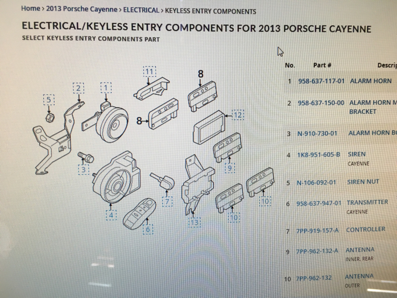

Well I decided to not get the PCCB's.. And I'm concentrating on new stuff. I'll keep posted on the Entry and Drive feature which is a must. I had to go and pick some packages, small boxes, and had my hands full. DARN IT!!! I had to put them on the floor, reach my key on my pocked and unlock the CTT then open the door, then bend to reach the boxes on the floor and drive home. I thought to myself why the heck I'm I waiting to make Entry and drive the first on my current list?
Well I need Serg124 help on that wiring to the antennas =)

Quote: 6 antennas total porsche parts program called PET - can be downloaded from torrents.
I only see 5 antennas on PET my friend
Reply
Jun 19, 2016 | 02:36 AM
really? ))) watch better!
Reply
Jun 19, 2016 | 08:28 AM
Quote: really? ))) watch better!
jajajajajaja i think I need to go to the doctor =D
I saw it on PET when I click the Rear antenna, it says QTY = 3
Now what to do with the OEM wiring for those antennas... Grrr
Reply
Jun 20, 2016 | 01:28 PM
no oem wiring. plugs pins wires
Reply
Jun 20, 2016 | 01:32 PM
Quote: no oem wiring. plugs pins wires
So it will be same as the Steering Mod. I'll need the plugs (connectors) and make the wires and pins... Interesting, not as easy as I thought. Might need and electricians help and rely again on my best friend called PIWIS 3... Talking about PIWIS I'm thinking on acquiring a PIWIS 2 that way it'll be easier for many stuff

Jun 20, 2016 | 02:00 PM
  #27
Serg
can I visualize all the plugs on PET? I'm out of office can't check PET myself.
Reply
Jun 20, 2016 | 02:04 PM
  #28
no, in WDS only. and vag etka
so why you need own piwis? ))) if you have extra 3000 send them to me ))))
