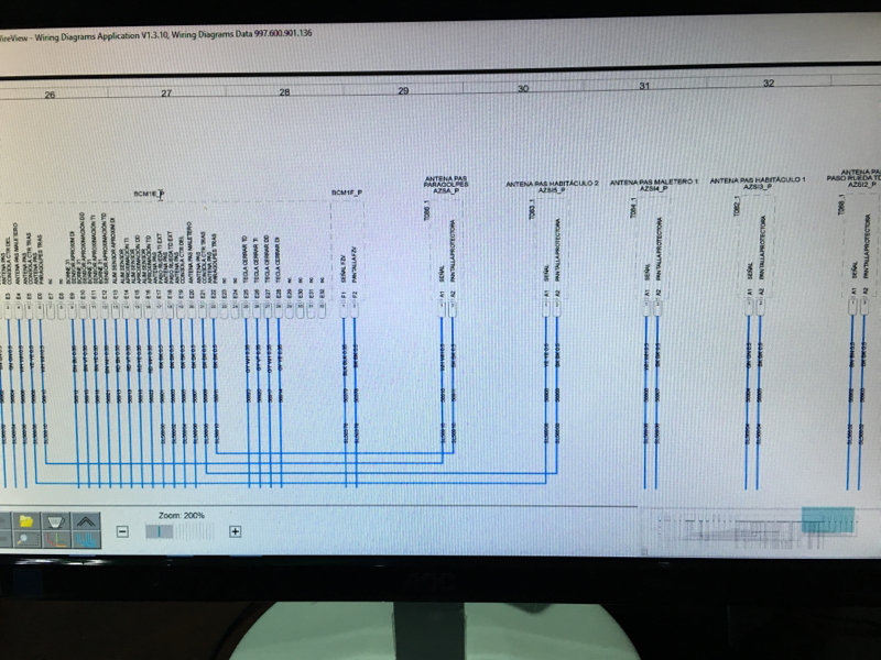

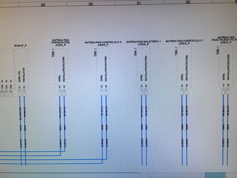

Ok, I've been looking closely Porsche WDS and if I'm not mistaken I don't need plugs but I'll need to make the wires for the specific pin slots on the existing connectors, of course assuming those pin slots are empty because they're reserved for Entry and Drive. I do think I'll need the plugs for the antennas though. Looking for it at the moment.
Hope I can hear anyone's thoughts on this.

got them on WDS. They are common 2 pin plugs. I've seen them a lot. Most of this plugs can be found as Audi parts )))) Now as per wiring them to the main module should not be hard. I now which pin each cable goes to. The same goes for the handle wires to the door module plug. Common sense tells me that this plugs if there was no option ordered (Entry And Drive) the slots on the connector corresponding to it it's there but empty. My tech told me it can be done. After that picks programming.

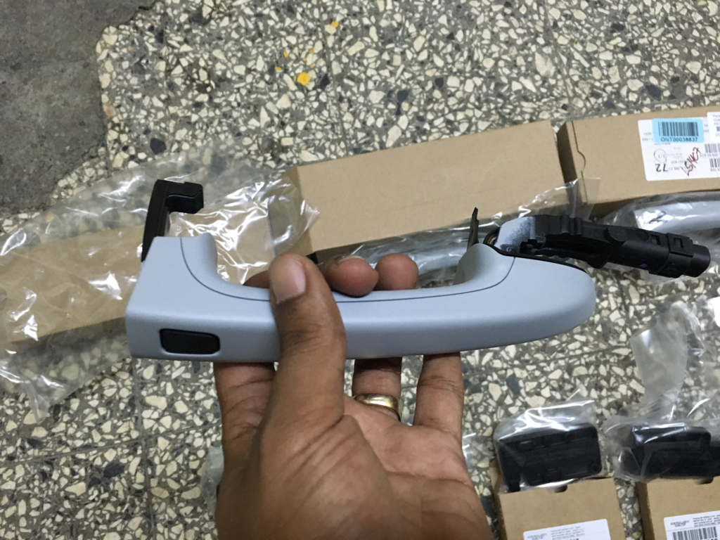

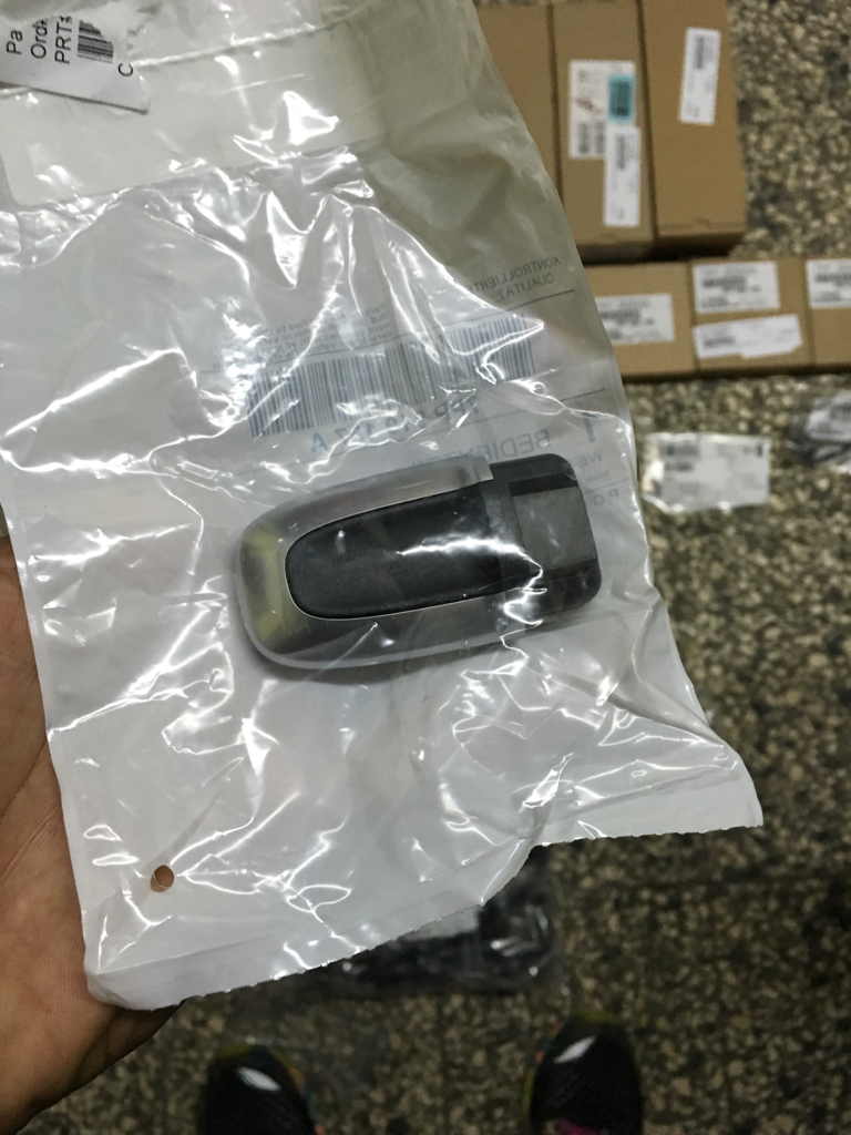

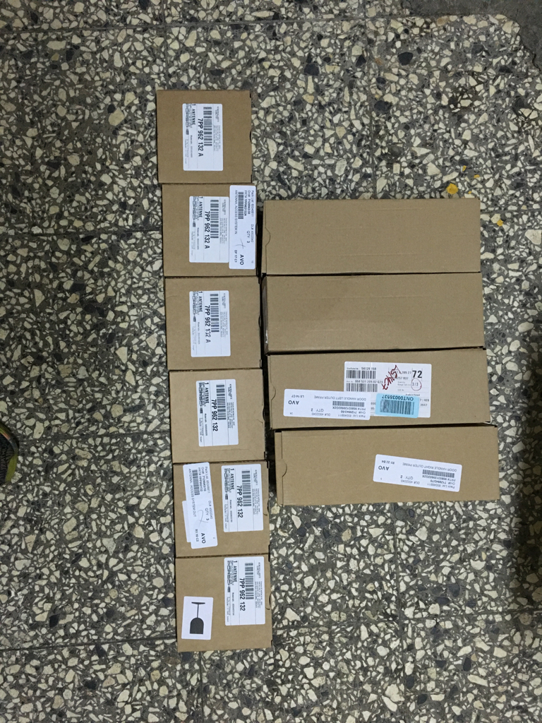

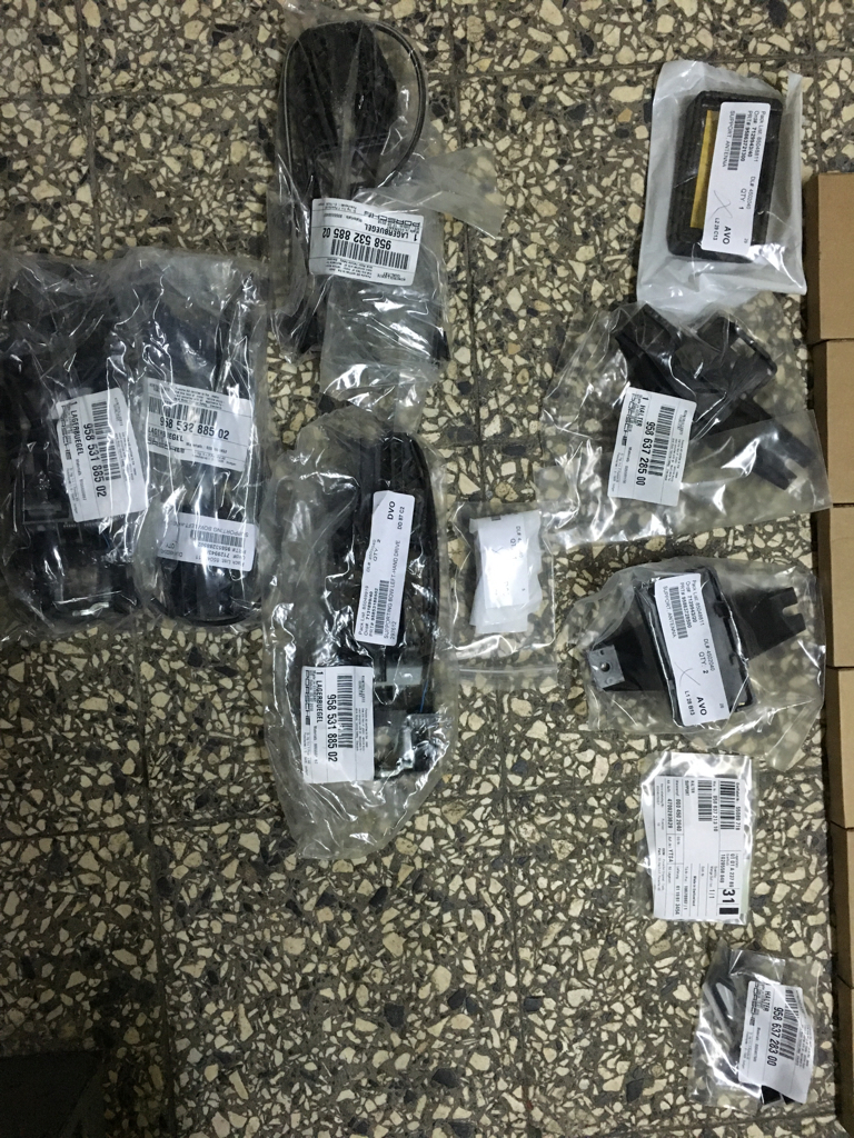

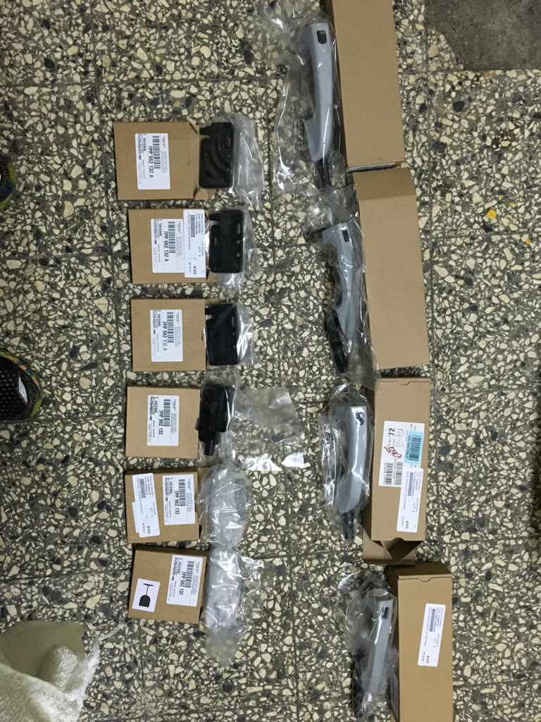

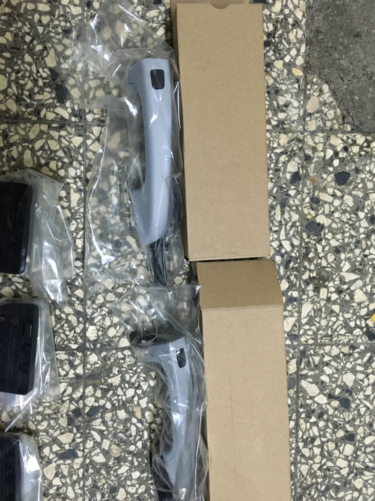

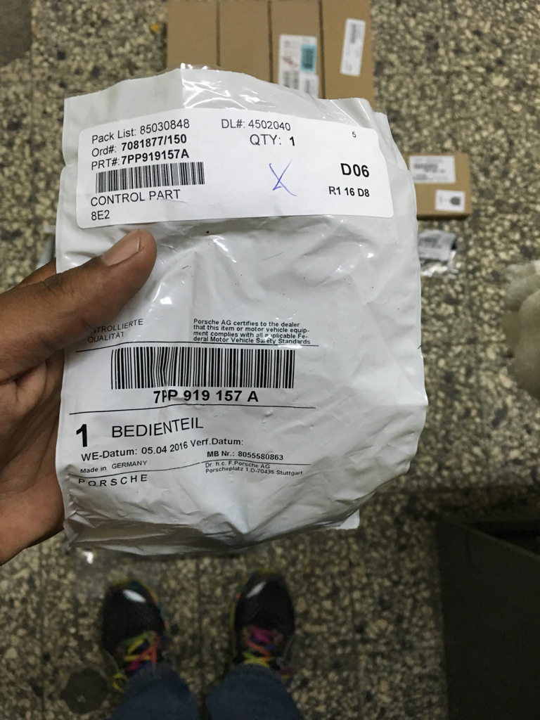

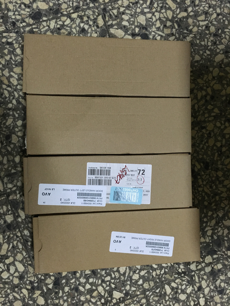

Ok... Let's continue this thread. I got the box with all needed parts thanks to Sunsetporscheparts and Serg124. Name:  image-3543064575.jpg
Size:  837.4 KB Name:  image-2295691506.jpg
Size:  904.0 KB Name:  image-3845543527.jpg
Size:  1.05 MB Name:  image-1584640971.jpg
Size:  1.06 MB Name:  image-1740017408.jpg
Size:  769.5 KB Name:  image-1263667640.jpg
Size:  823.6 KB Name:  image-1880485060.jpg
Size:  1.08 MB Name:  image-412662942.jpg
Size:  962.9 KB Name:  image-3473181922.jpg
Size:  867.4 KB Will keep posted.

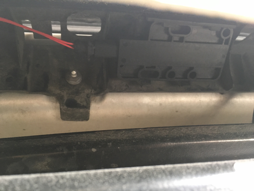

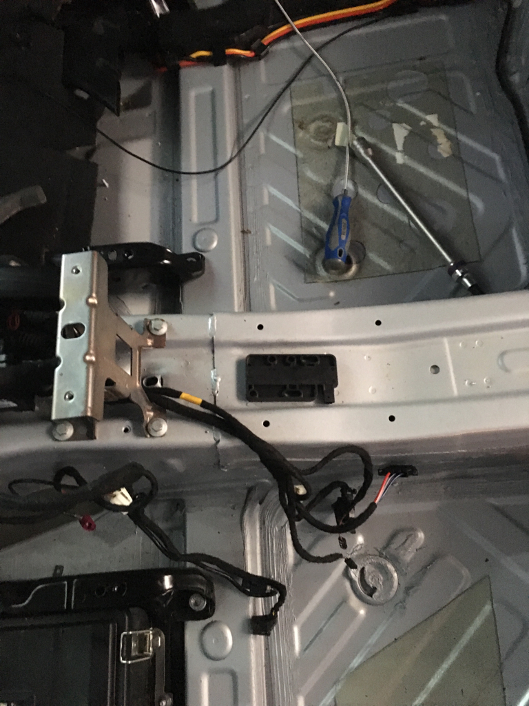

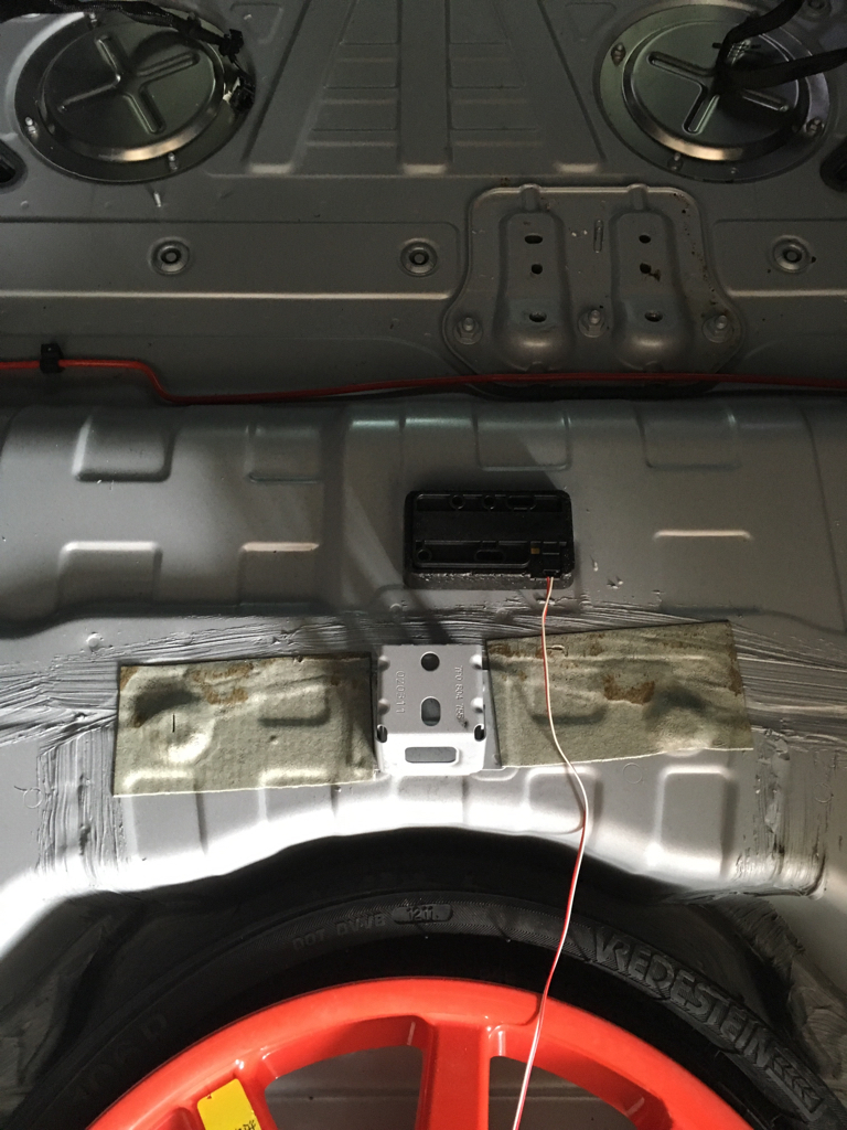

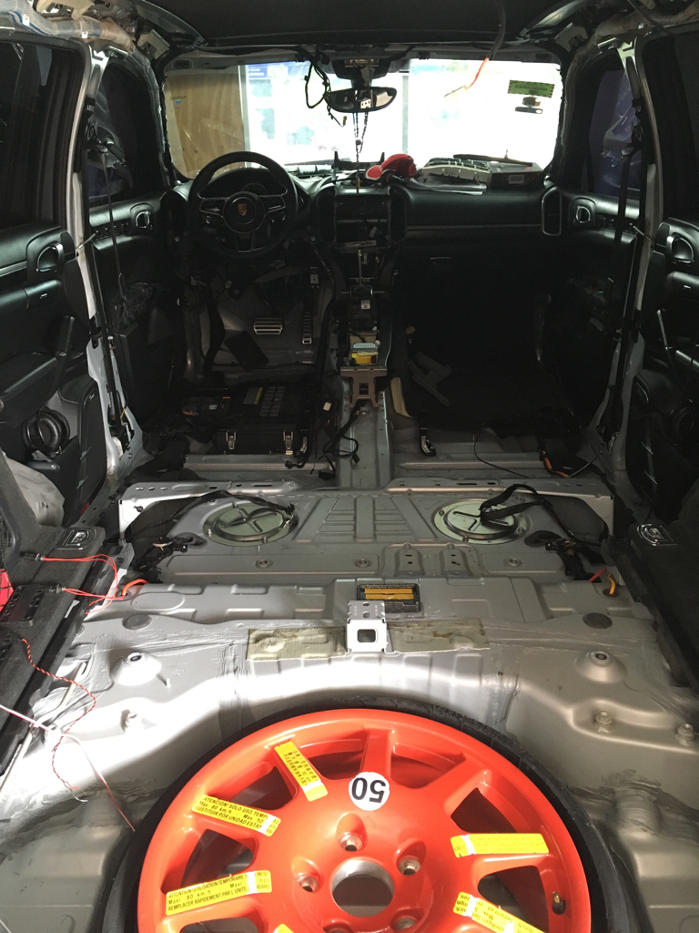

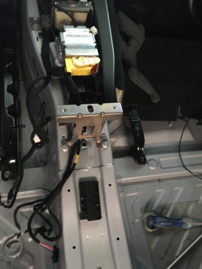

To keep this thread updated the CTT is now without interior waiting to be rewired. Name:  image-678524247.jpg
Size:  815.8 KB Name:  image-4149937002.jpg
Size:  654.2 KB Name:  image-2618546161.jpg

Well, I'm impressed.. that's way further than I would ever go to prevent having to take my key out of my pocket..
More power to'ya..
Old Aug 24, 2016 | 04:17 PM
  #39
amablemiguel's Avatar
Joined: Aug 2012
Posts: 193
From: DR
amablemiguel is infamous around these parts
Originally Posted by deilenberger
Well, I'm impressed.. that's way further than I would ever go to prevent having to take my key out of my pocket.. More power to'ya..
jajajaja I agree but since outside is, well mostly the same as you saw the inside, I took the chance to do it. But believe it or not it takes the same time for 2 to remove the front and rear bumper and do the same for the interior.
