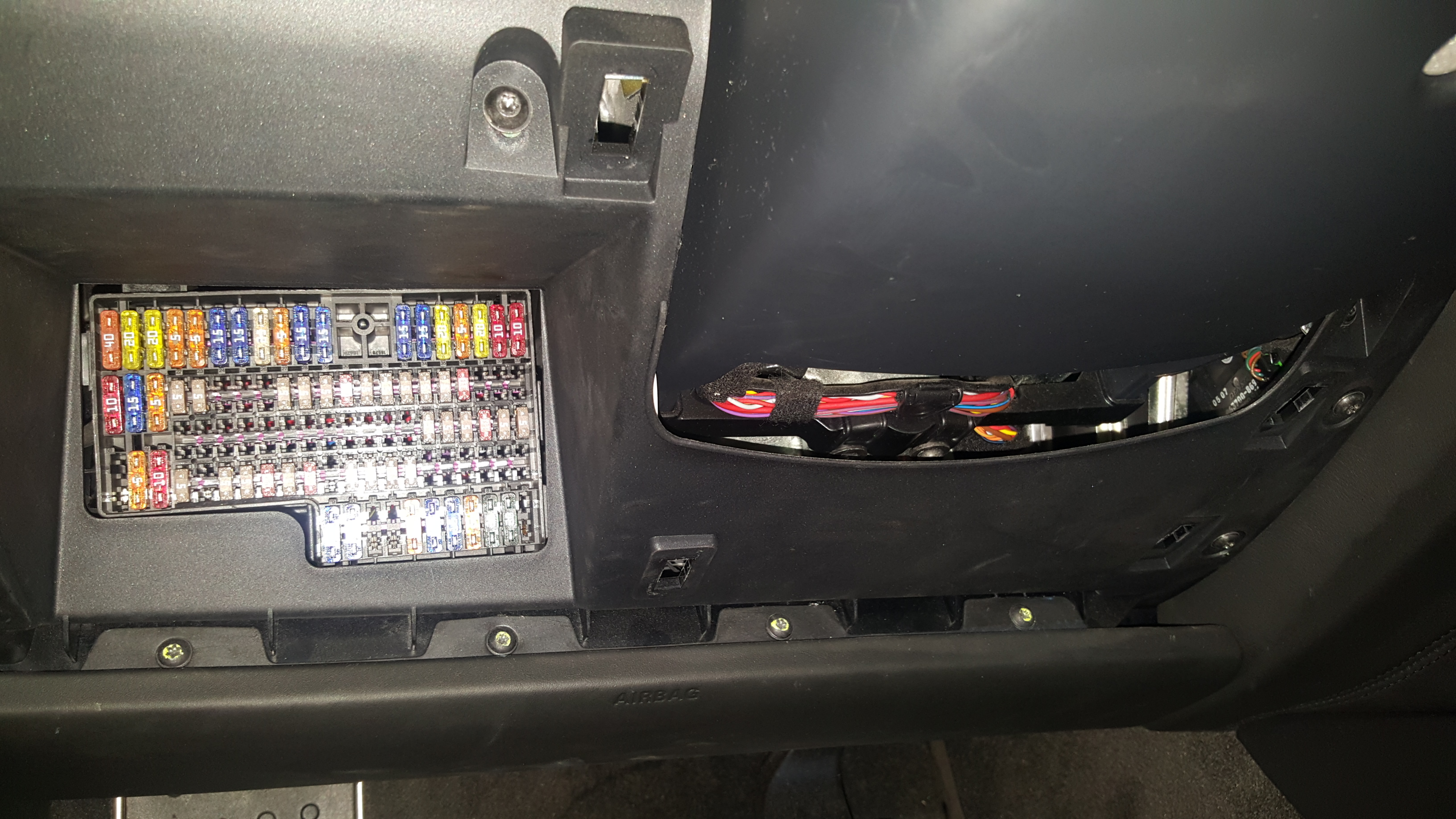

Hmmm, try the fuse box by your knees. It is fuse #18 as in diagram below. It is a 10A fuse.
Old Mar 27, 2016 | 08:48 AM
rdsrllc's Avatar
Joined: Aug 2014
Posts: 37
From: miami
Rep Power: 13
rdsrllc is infamous around these parts
I tried it, Fuse is fine. still doesn't work.

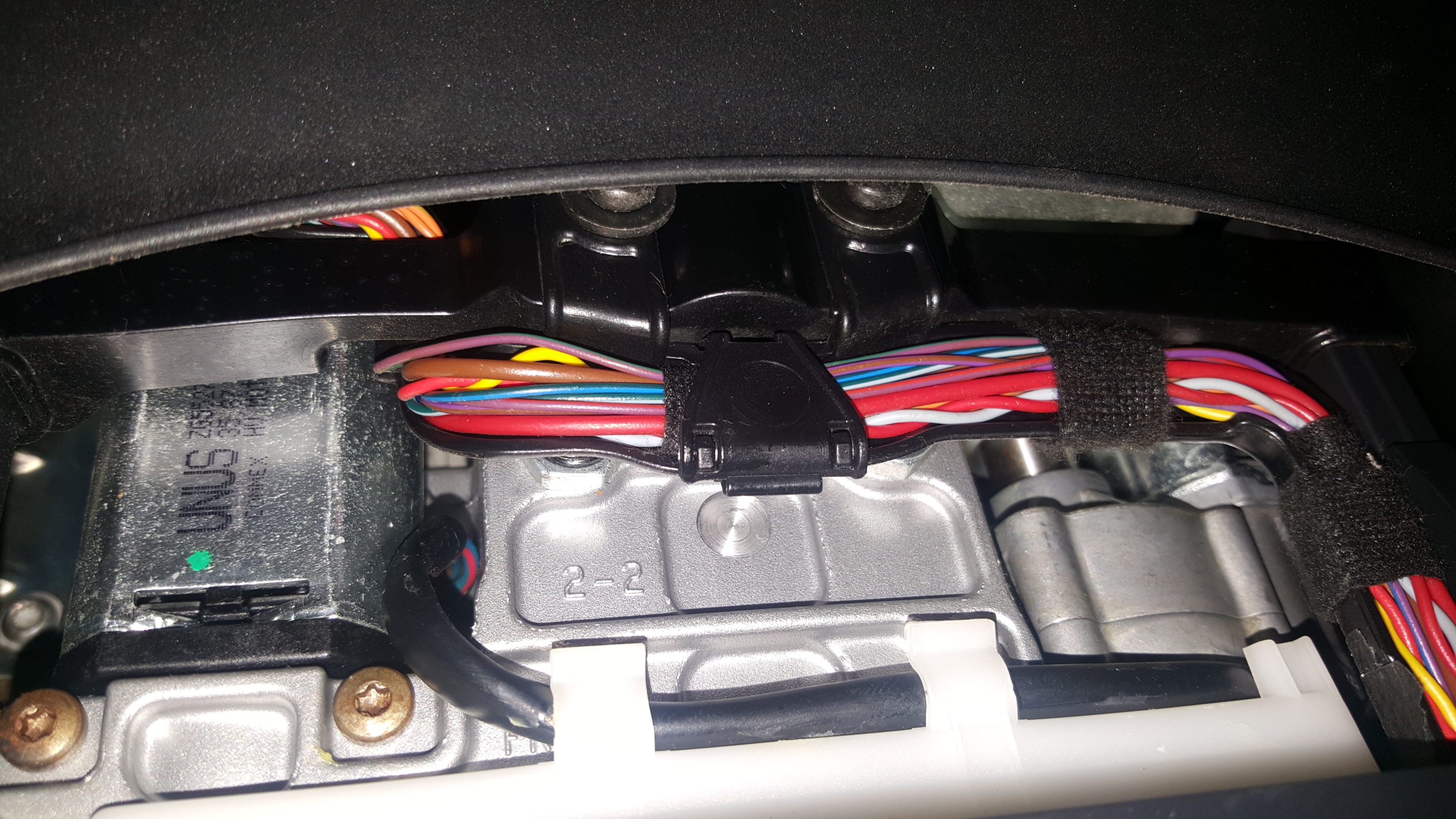

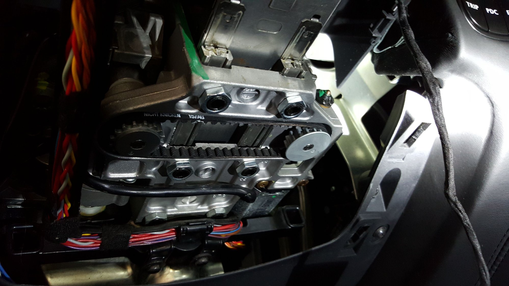

take the steering column cowl off, when operating the button give the cog with a rubber notched belt a little help and it should start working. I take it the steering wheel goes in and out but not up and down ?
Old Mar 27, 2016 | 01:50 PM
rdsrllc's Avatar
Joined: Aug 2014
Posts: 37
From: miami
Rep Power: 13
Yes correct. It goes in and out but Not up or down.
Old Mar 27, 2016 | 01:53 PM
bentleytech's Avatar
Joined: Apr 2013
Posts: 336
From: east sussex,UK
bentleytech is a glorious beacon of lightbentleytech is a glorious beacon of lightbentleytech is a glorious beacon of lightbentleytech is a glorious beacon of lightbentleytech is a glorious beacon of light
then try what i said, when you do get the cowl off, i think there is a plastic cover that covers the gear and its belt.
Old Mar 27, 2016 | 02:32 PM
rdsrllc's Avatar
Joined: Aug 2014
Posts: 37
From: miami
Rep Power: 13
Were it it?
Old Mar 27, 2016 | 02:34 PM
Joined: Apr 2013
Posts: 336
on the underside
Old Mar 27, 2016 | 02:35 PM
Joined: Apr 2013
Posts: 336
in the picture you sent i can see the white cover on the underside. its there
Old Mar 27, 2016 | 02:36 PM
rdsrllc's Avatar
Joined: Aug 2014
Posts: 37
From: miami
Rep Power: 13
Old Mar 27, 2016 | 02:39 PM
Joined: Apr 2013
Posts: 336
thats it, when you operate switch do you see it try and move or a click, using a screwdriver push on the cog slightly just to help it and i always found it started working. good luck
Old Mar 27, 2016 | 02:41 PM
rdsrllc's Avatar
Joined: Aug 2014
Posts: 37
From: miami
Rep Power: 13
I here a click. What's the cog?
Old Mar 27, 2016 | 02:43 PM
Joined: Apr 2013
Posts: 336
ok the belt i runs the cogs, the little wheels each end with teeth, gently apply pressure to one tooth as you apply steering wheel switch, you may have to try both ends but gently, it should start to move
