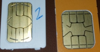

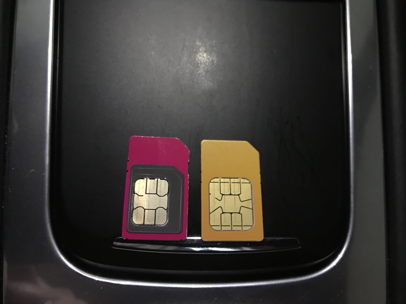

A couple of added info:
The att SIM card is physically different from the 3 in 1 T-Mobile card, of course, but it contains extra fields. I'm not sure if it's relevant to the issue. Some of the fields I know are for different things but they are the same across different devices. See the pic, magenta is T-Mobile as usual. Maybe ask for an old school SIM card? I don't know how the Verizon sim looks like, should be similar to T-Mobile.
Second, att SIM card do not broadcast isp name while T-Mobile does. When connected to my home wifi, it also register Comcast as isp. So as it works with my home wifi, I don't think the isp is the issue.
I do think that the phone number associated with the sim is part of the handshake with google services, the home wifi doesn't have a phone number, so that's one variable.
