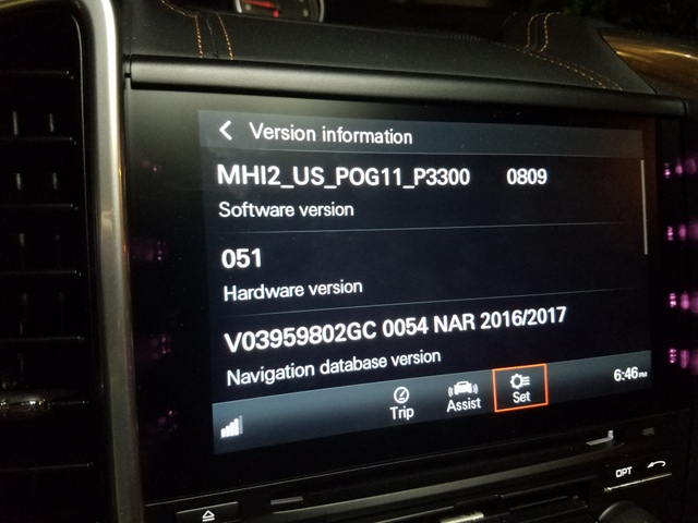

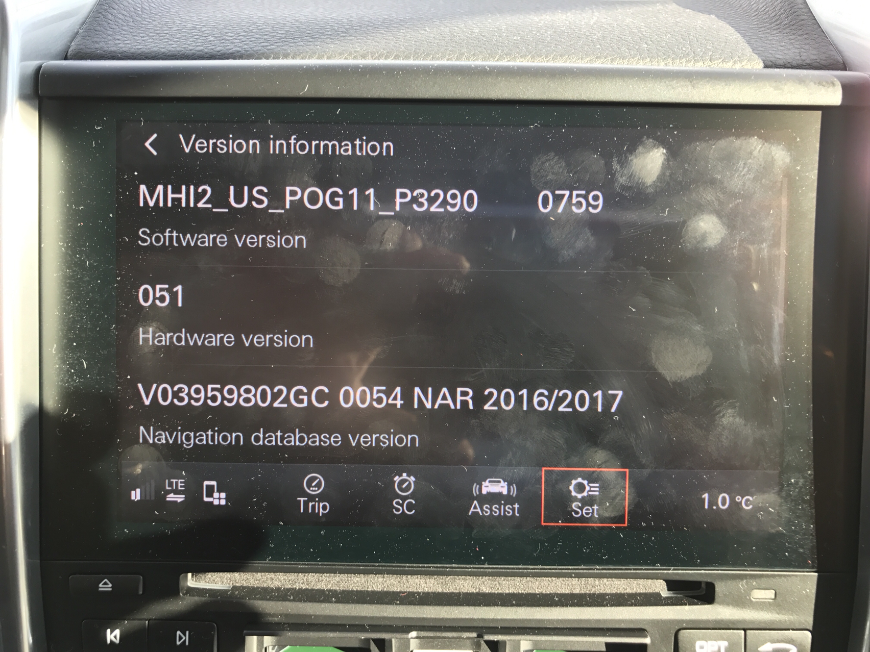

Hmm, well, in my '17 GTS, that's had the Verizon SIM in it since last Saturday, the Online Search returns results just fine. Likewise it's showing traffic for larger roads.
What version of software is on your PCM? Here's what mine reports:
Seems my software version on the Cayenne is a bit outdated . I'll check the 911 but I think the variable is T-Mobile...
Gotta clean that screen...
