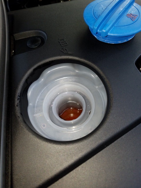

Proper Coolant Level for a 2011 Porsche Cayenne S
I have looked everywhere for some visual indicator on this tank and can't find what the proper level of coolant should be. I am worried it is extremely low. Can you guys with your vast knowledge please look over these photos and let me know where the proper level of coolant should be. I just took these photos and it is 38 degrees outside the engine hasn't been turned over in a day or so.
Thank you.

Actually - for a cold coolant level you look fine.
There is no level mark on the tank, despite what the owners manual says. I went to the trouble of having the shop foreman take a look at mine and asked him to show me the level mark. He had to admit he couldn't find one either.
If you see fluid in the top of the reservoir above the plastic plate you're looking at - you're fine. If you look at the side of the tank and the coolant is at or above the seam in the tank - you're fine. It's hard to see on the side due to the beauty trim plastic that's in the way - and the coolant is so pale in color it doesn't really stand out.
I love how the pictogram on the top of the tank tells you to check the owners manual - which then gives you misinformation.
There is a low coolant warning - so I wouldn't be overly concerned.

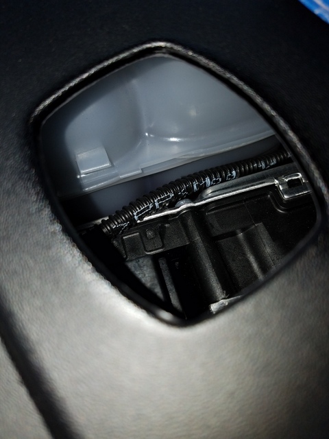

Here is what I can/cannot see on a 2011 Turbo:
Is it here?
Or here?
Must be here right?
Not ANYWHERE..
BTW - have had the beauty plastic surround off whilst changing plugs - can't recall seeing a marker on the tank anywhere. I'm guessing if it's up to the seam in the tank it's OK.

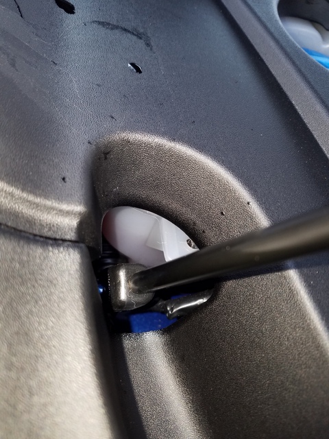

Found Markings
Found the markings on mine. Not really where the manual says. This is a 2011 Cayenne.
You can barely see the line below the seam.
Pointing to the general area for reference. Hope this helps someone!

like others have posted, theres marking on the side of the tank. this is the same tank used in some audi's. if you cant see it well, pull off the black plastic covers.

Had my covers off today (replacing air-filters) - and sure enough - the line is BELOW the seam in the tank. If you're filled to the seam you're fine. With the covers on the line cannot be seen.
