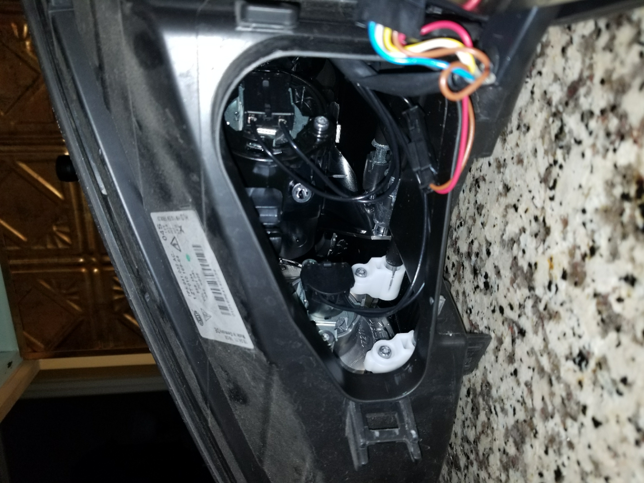

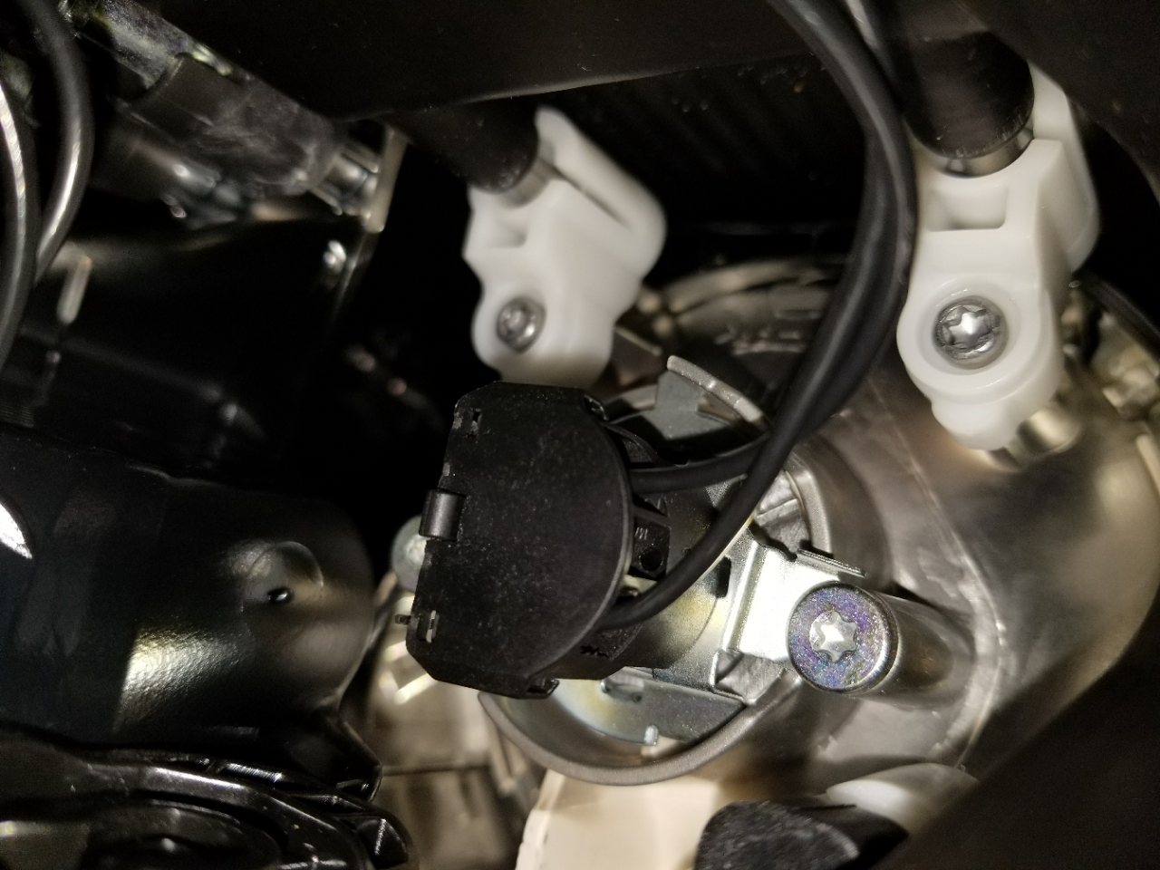

OK, Feeling kinda dumb at the moment, but I swear I cannot get the socket to move. I assume I'm in the right location (this is where the manual says anyway)?

I feel like either we have different headlights or you're going at the main bulb, not the cornering light?
I have a 2012 V6 6MT. Here is what I'm seeing:
Access panel for the cornering light
Bulb holder for the cornering bulb (two wire)

Maybe I'm on the wrong socket. In your picture, is the cornering socket the one on the left with 2 wires, or the one on the right with 2 wires?

Ah!! The left!
