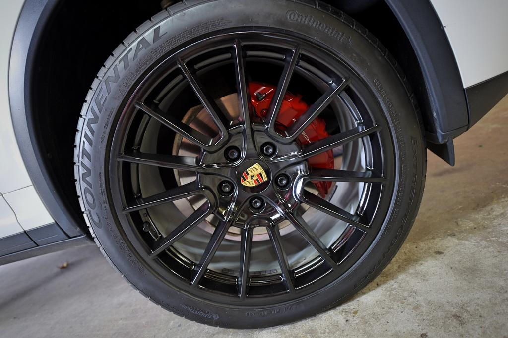

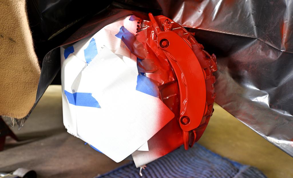

For the past few weeks, I've had to painfully walk by my newly refinished set of black 21 inch Sport Plus wheels. While they sat inside, my Cayenne sat outside with those pitiful 18s still attached. Although the wheels were given plenty of time to cure and could have been mounted at any time, I wanted to refinish the brakes before swapping the wheels. Because of the amount of attention to detail involved and getting the car off the ground was a requirement, it wasn't until this past Sunday that I was able to make time to visit the garage where I could sprawl out a bit.
After getting the OEM 18 inch wheels and tires off the car, which I'm now selling by the way (the thread can be found here), it was time to start the prep work on the humongous brake calipers. I started by blowing out the entire caliper area with compressed air. This was followed by spending some time with both a fine grit sanding sponge and a Scotch Brite over the entire surface area. Finally, everything was thoroughly doused with brake parts cleaner, wiped down with denatured alcohol, and blown dry again so I would have a completely clean area to paint on. The last step, and possibly the most important prior to painting, was the tedious task of masking everything off properly. I used blue masking tape, pieces of notebook paper, trash bags, and old blankets to completely cover everything. The last thing I needed was bright red overspray on my Pure White.
Following two light dusting coats of Dupli-color red brake caliper paint, two additional light coats, and a final medium-wet coat, this is what we were left with:
Once that had sufficient time to dry, out came the stickers supplied from Suncoast. Unfortunately, it wasn't until this point that I realized the decals I'd ordered, even though it was under the 958 section of their website, were not the staggered size stickers that the Cayenne models came from the factory with. The ones provided were all the same size, but installing the decal I had in hand was really my only option unless I wanted to wait another week to finish this project. Fortunately, once everything was said and done, it's hard to tell the text is slightly smaller than before.
Two more light dusting coats of VHT gloss clear brake caliper paint, and a final medium-wet coat, the refinishing was complete -- now it was just waiting game until everything cured.
While I'd been waiting on the wheels to cure and to find time to paint the brakes, I'd picked up some additional hardware to make the stance more aggressive. It was now time to mount up the ECS Tuning 15mm spacers in the front and 20mm spacers in the rear.

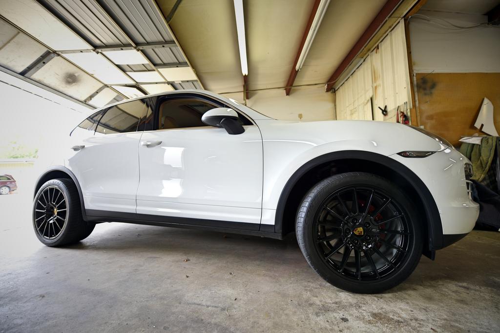

I double checked the pressures one last time before grabbing one of the front ET45 wheels and rolling it over to the truck. Using the wheel pin so I didn't scrape up the new painted items, I lifted the wheel on to the spacer and started inserted the ECS Tuning extended bolts using my non-marring 19mm socket. I finally got my first glimpse at what I'd been imagining for weeks.
The front wheels are ET45with a 15mm spacer, so essentially I'm running a ET30 offset with a 295/35/21 tire. The rear wheels are ET50 with 20mm spacers, so the same ET30 offset with the same 295/35/21 tire. The stance is aggressive, and sits right on the threshold of sitting too wide without the arched fender extensions, but I'm in love with the look currently. Here are some quick shots until I can get the car completely clean and pulled in front of a nice backdrop.
After torquing all the lugs to spec, I adjusted the tire pressure monitoring system to reflect the larger tires, and within a few minutes the system synced with the new sensors and was accurately reading the pressures I'd just double checked. I took it easy on the side roads to ensure no vibrations or noises and eventually took the car near triple digits with zero issues. The difference in ride quality was practically the same, and handling/turn-in seem to have improved due to the decreased sidewall.

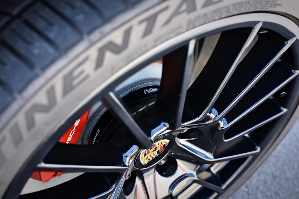

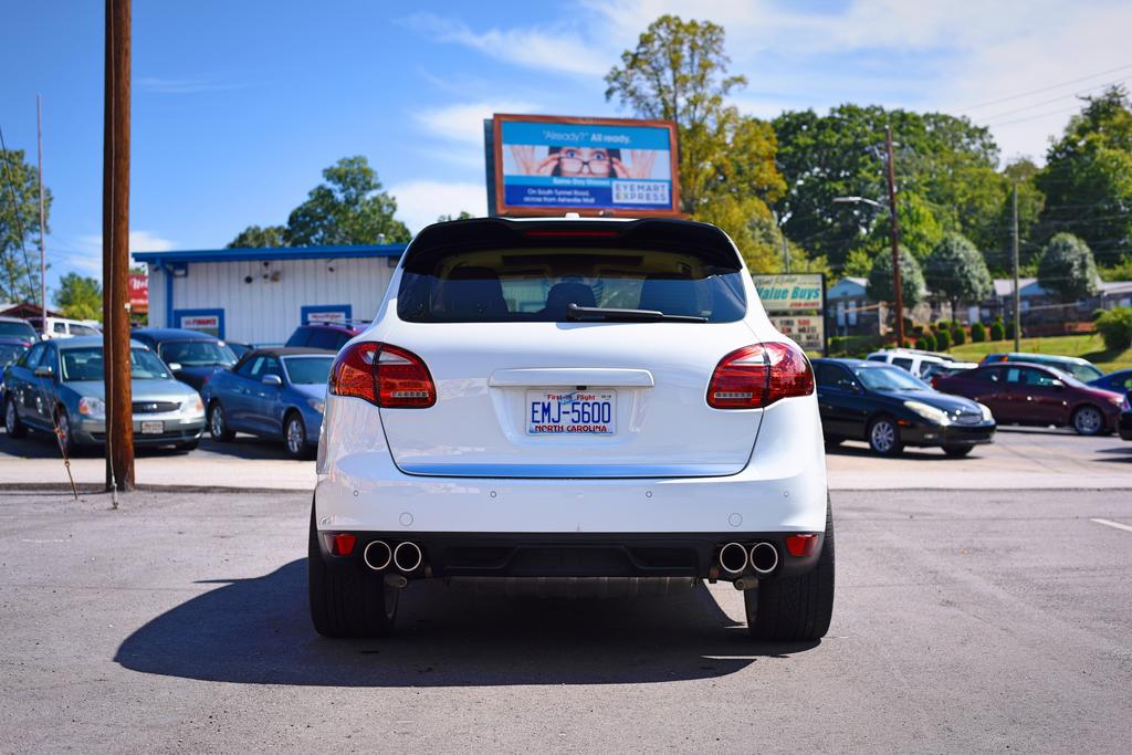

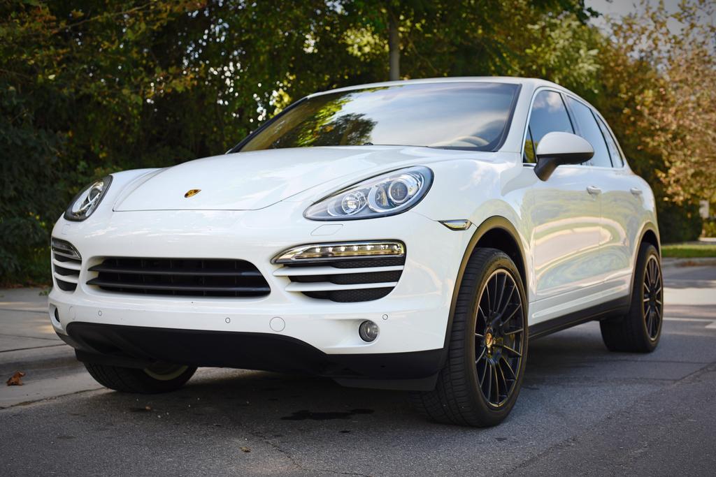

Earlier today I was finally able to find some time to give the Cayenne a wash and snap some proper photos of the new setup. I've logged about 1,000 miles on this new wheel/tire setup and I have nothing but great things to say. The look is aggressive, the ride quality is indistinguishable from that of the 18 inch wheels and 60 series sidewall, and turn in and handling are both improved with the 295 tread and 25 series sidewall. The Continental tires are quiet, do well in spirited driving, and claim to have impressive treadwear.

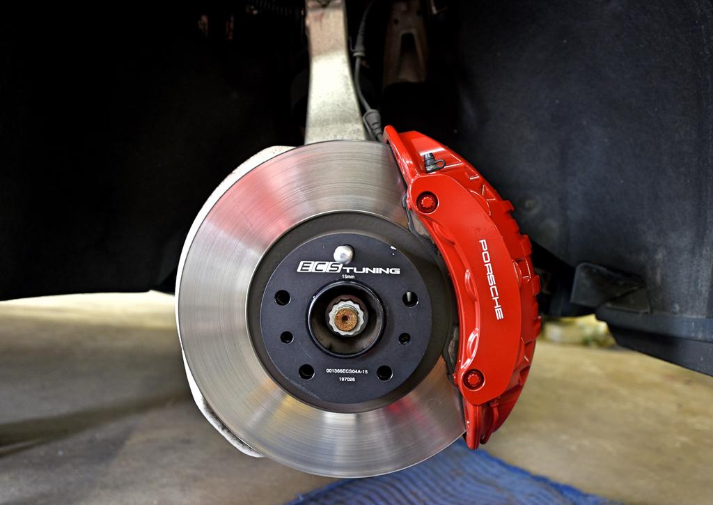

The ECS spacers are just begging for some Pure White paint matched flared fender extensions.
UPDATE: Transfer case is still holding power perfectly with zero irregularities or slipping. In about 2,500 miles I'll be due for another oil change, so hopefully it will be smooth sailing until then.

The ECS spacers do give the appearance of two piece rotors, which was a welcomed surprise. The paint matched arch extensions are pricey, but would really finish off my Base to perfection.

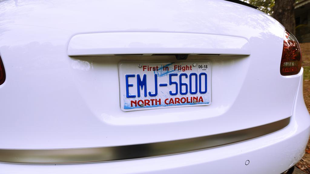

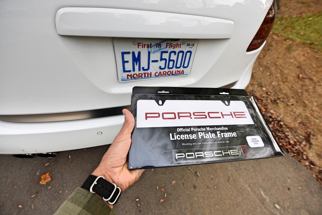

In addition to attempting to get the airbag error corrected, I also wanted to install the Porsche black license plate cover I recently picked up. I've been running just a bare license plate since getting my NC tag a few months back.
This plate came with hardware: screws, spacers, and screw caps. The screws didn't fit the pre-installed threads in the rear hatch lid and the screw covers wouldn't fit the existing bolts I already had. 0 for 2 so far.
I ended up just using the bolts I was using before and left them exposed as opposed to using black plastic caps. This small addition really rounds out the rear end and matches the black/white/polished theme I've got going.

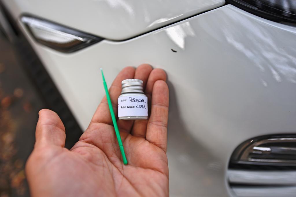

Since it was nice out, I also addressed all the rock chips the front bumper had racked up over the past five years before heading inside. This Pure White paint I picked up off Amazon matched very well and went on easy with the included brush.
