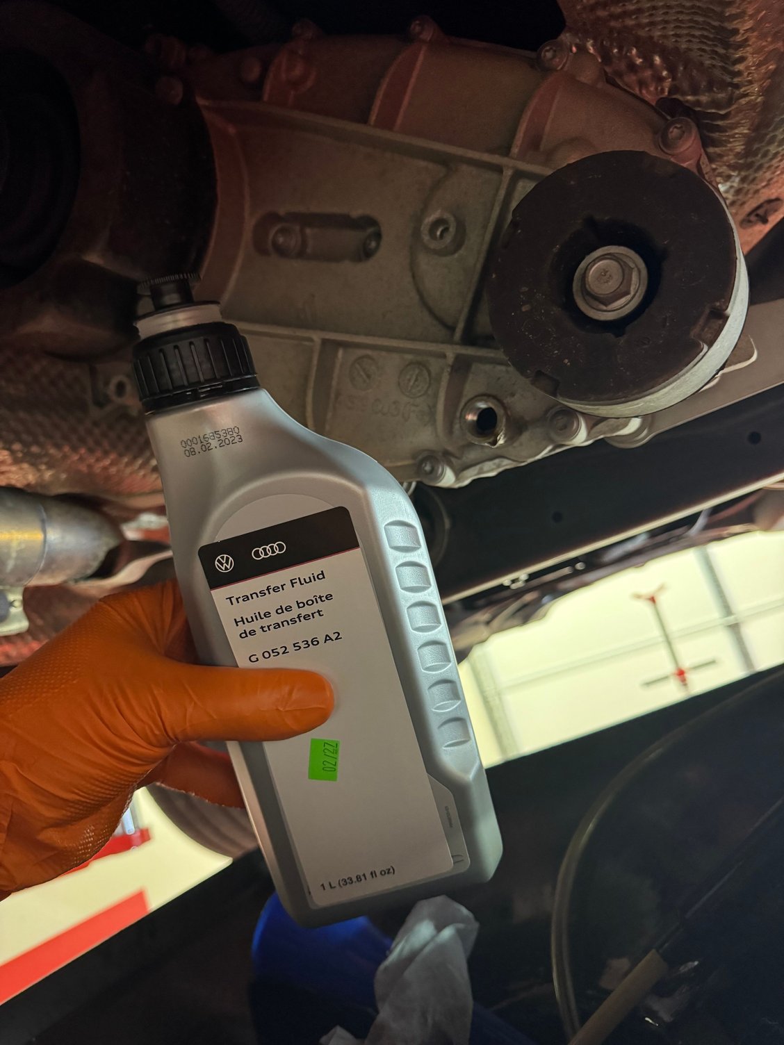

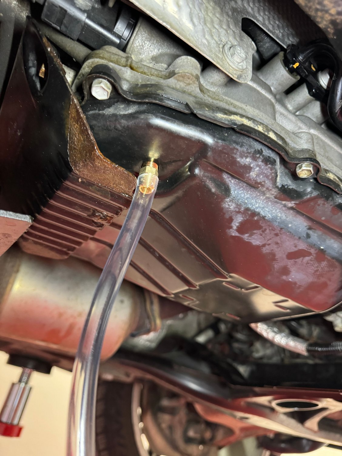

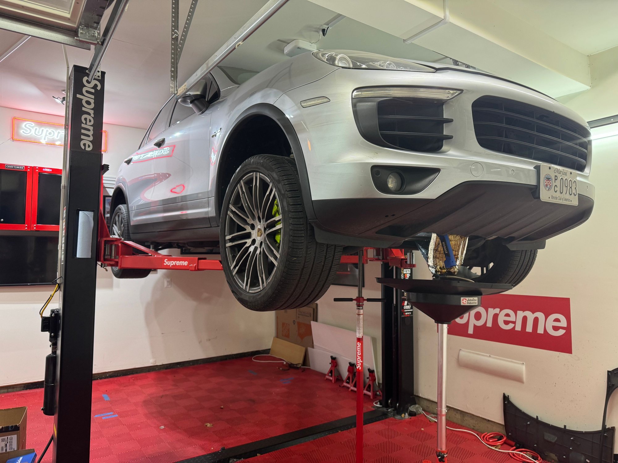

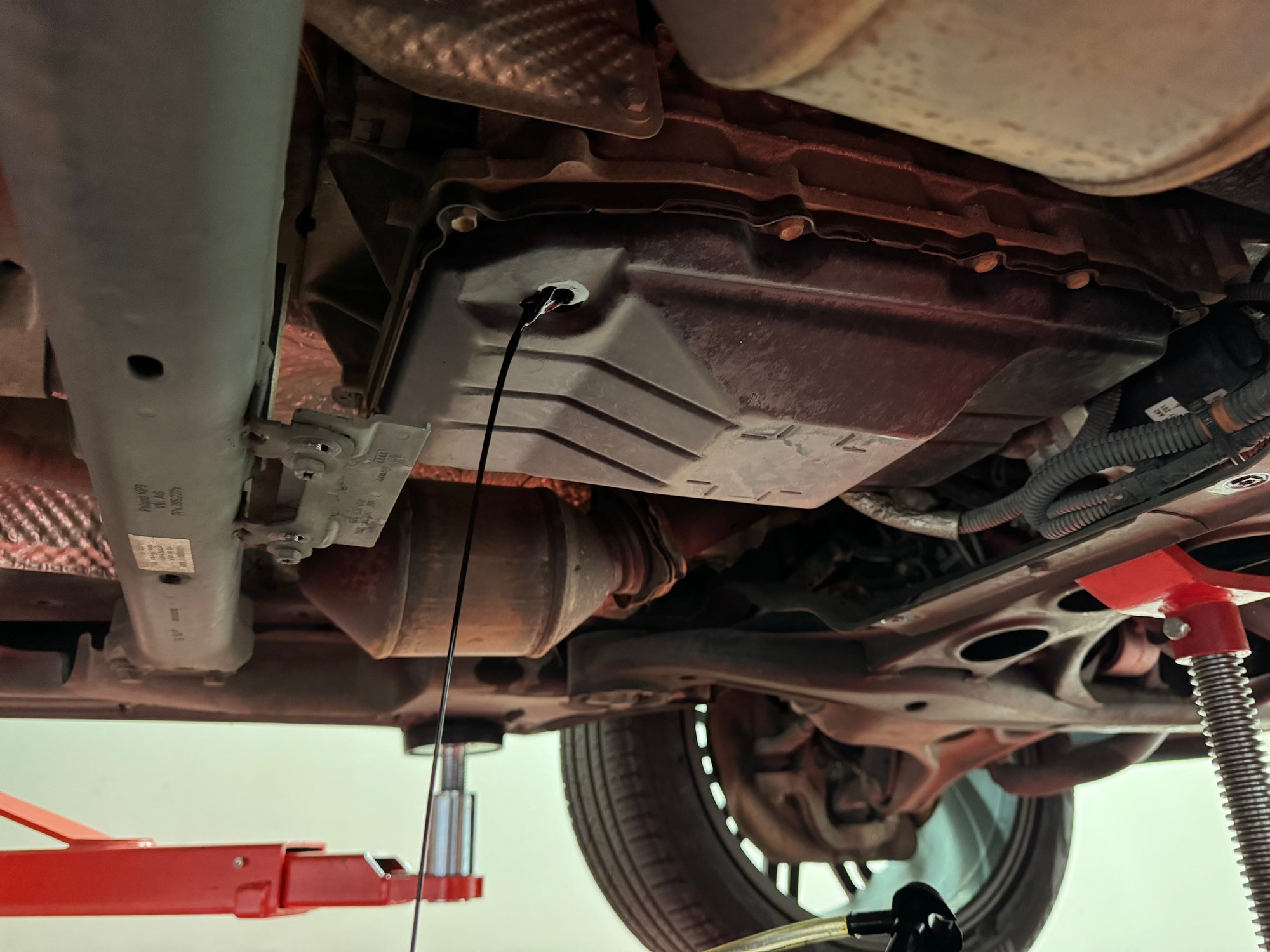

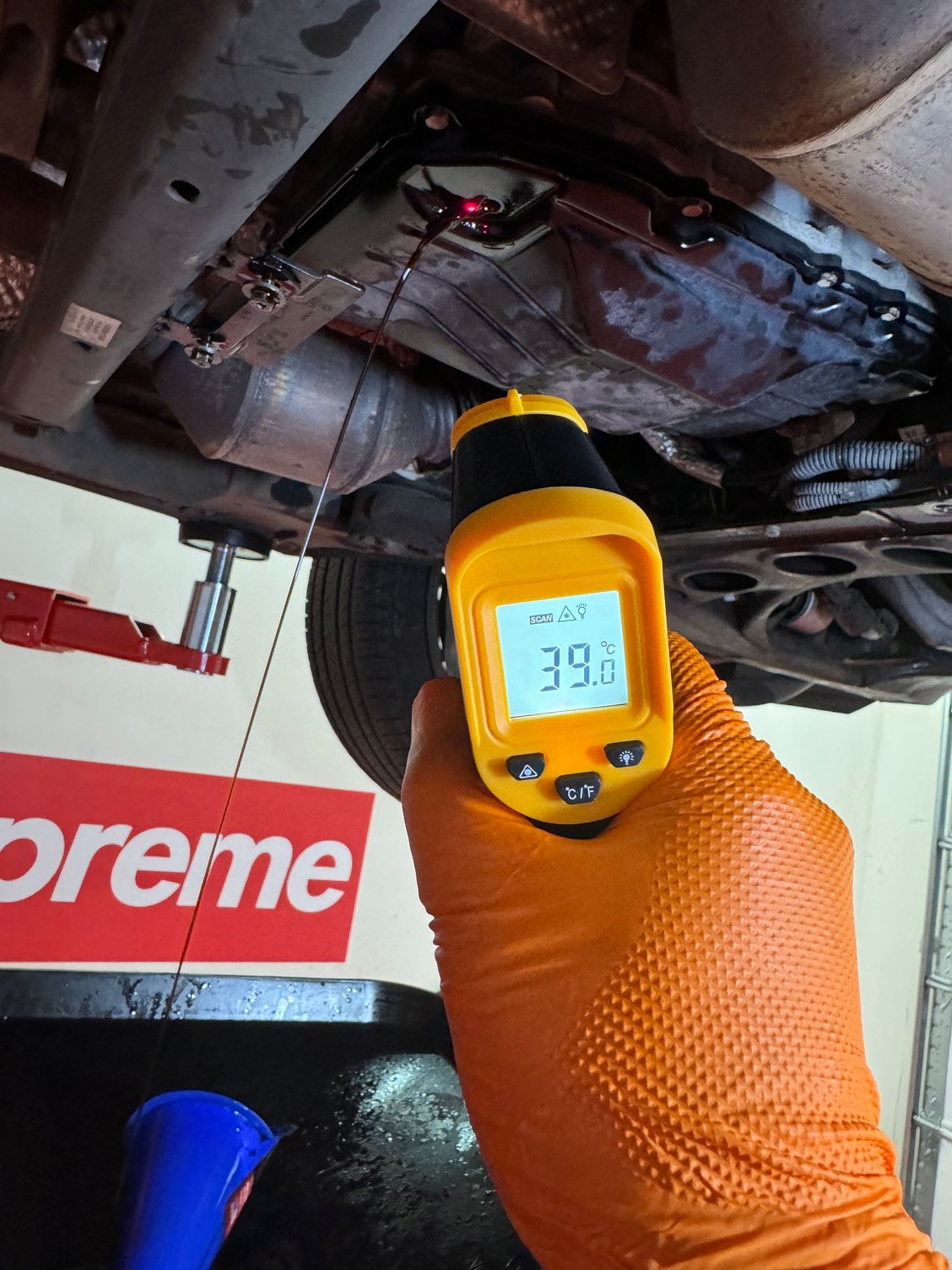

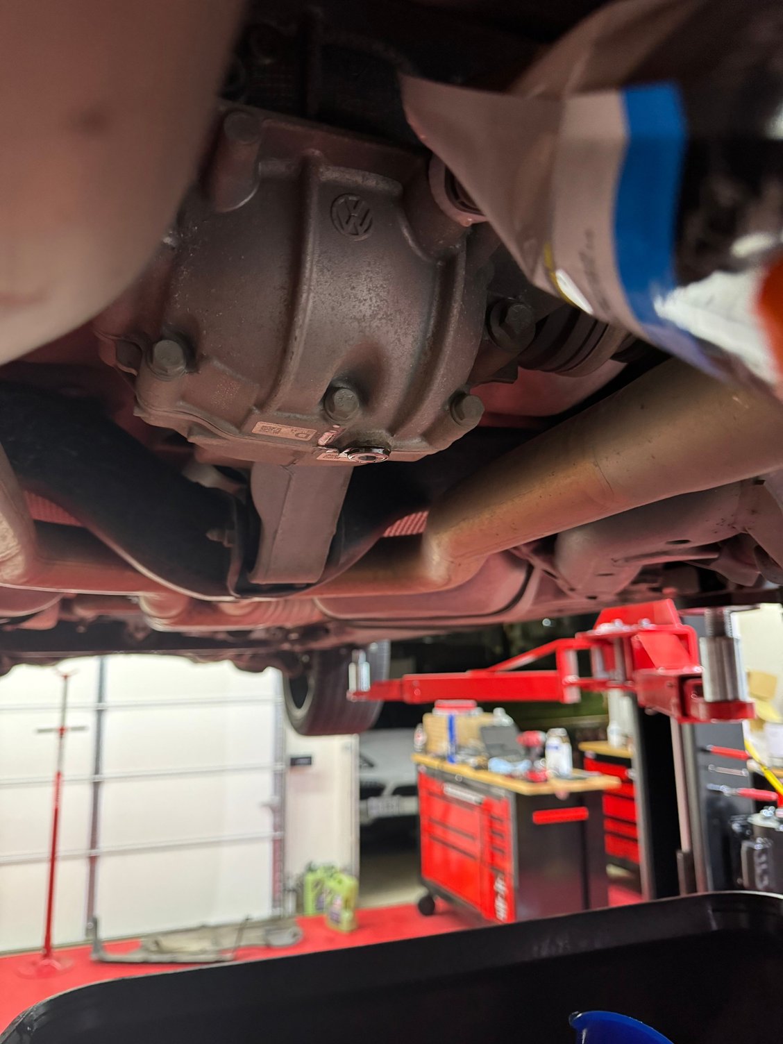

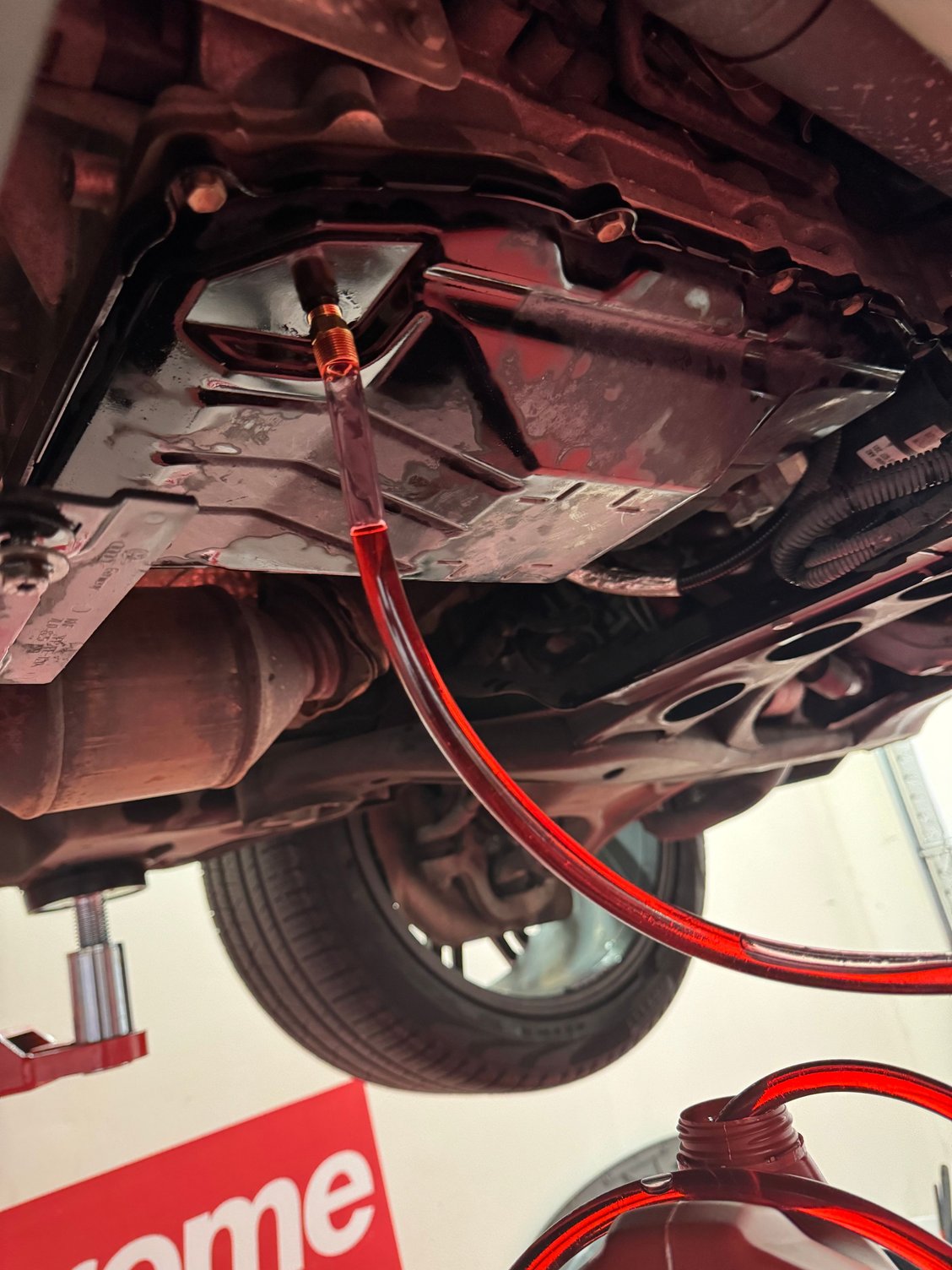

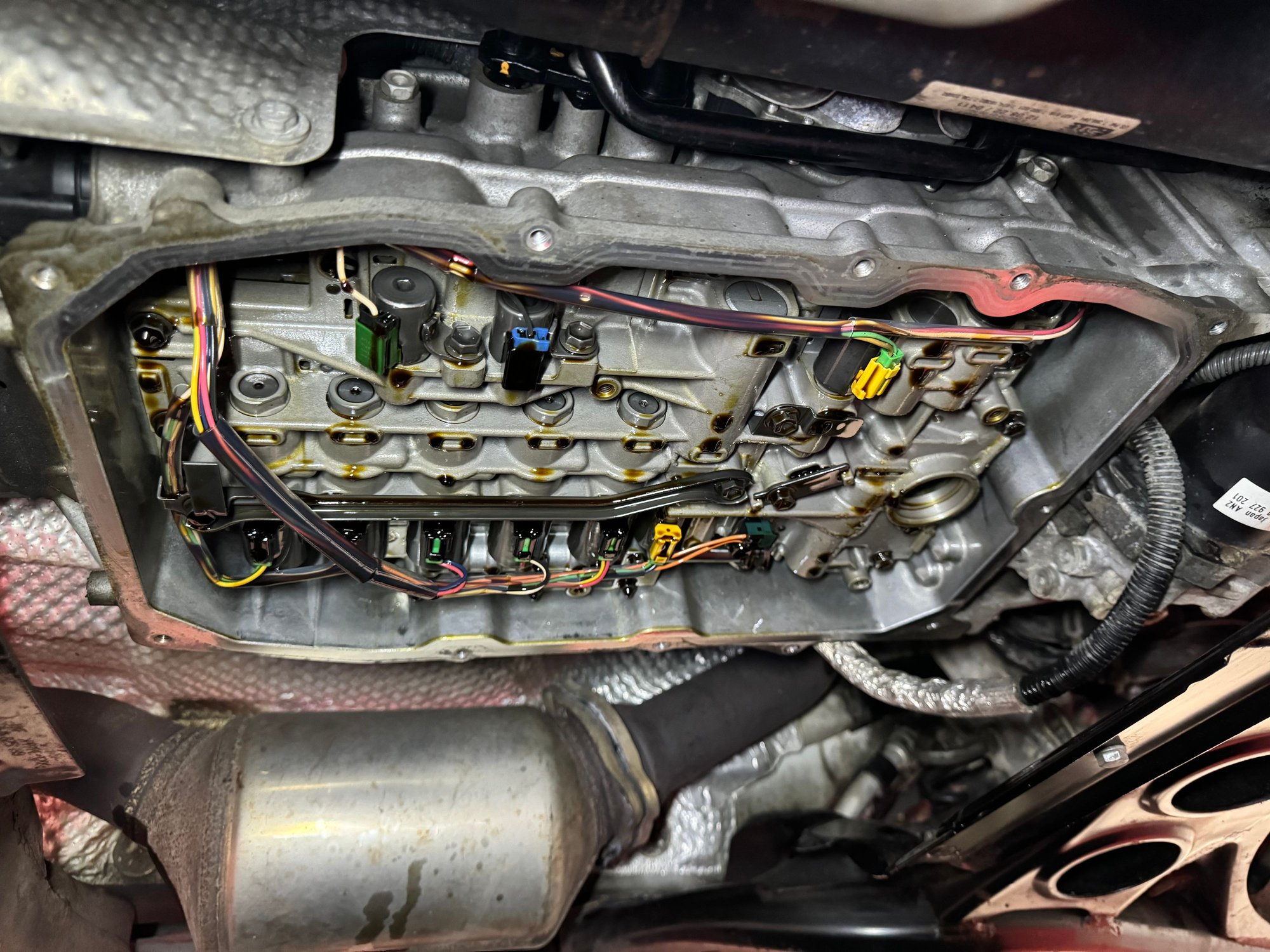

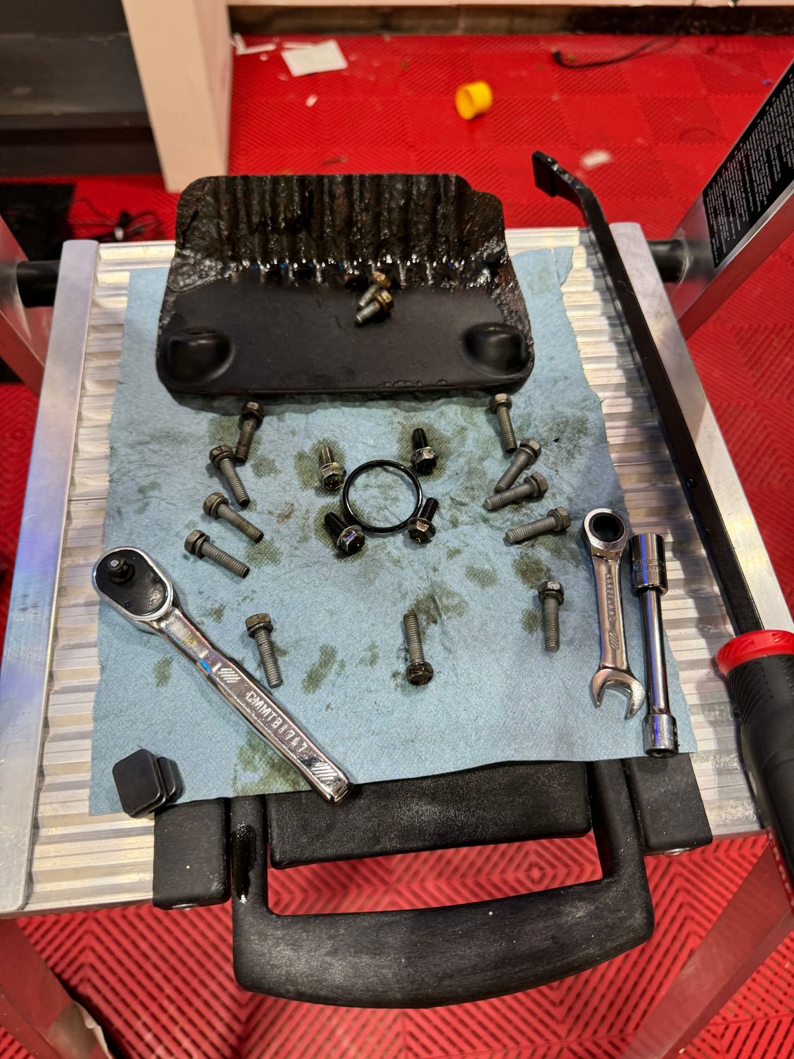

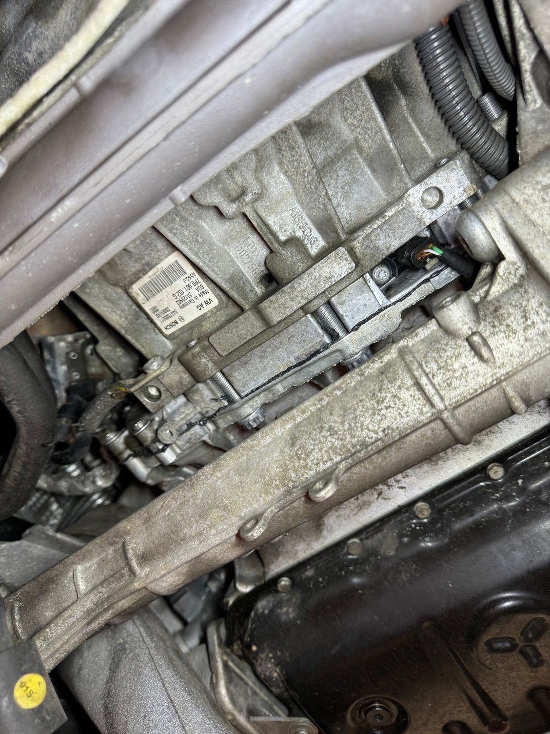

There are a lot of posts with transmissions shifting rough and people change the ATF about 3 times then it stops. I’m living proof it really works. I did it on my 958.1 (rough shifts) and 958.2 just to be safe
Oil and filter change

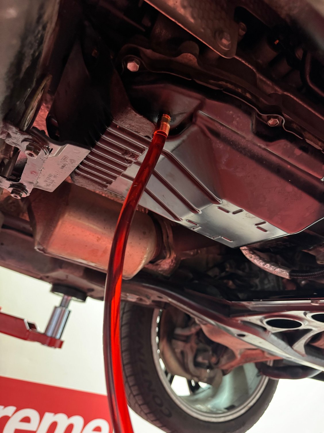

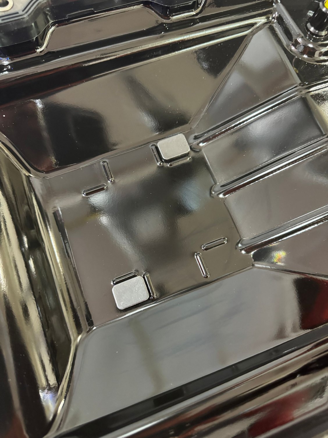

ATF fluid and filter

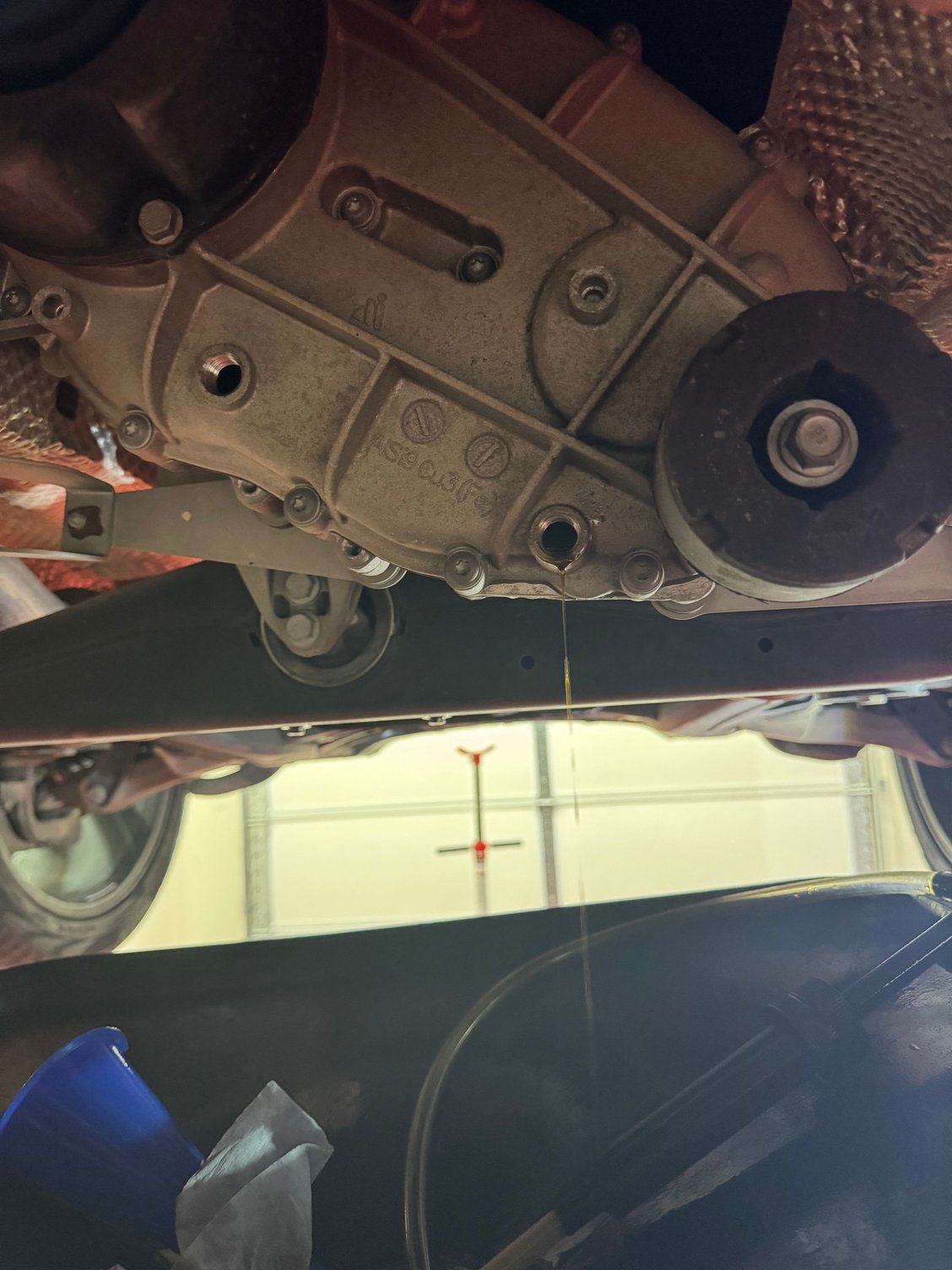

Transfer case fluid
Rear diff fluid

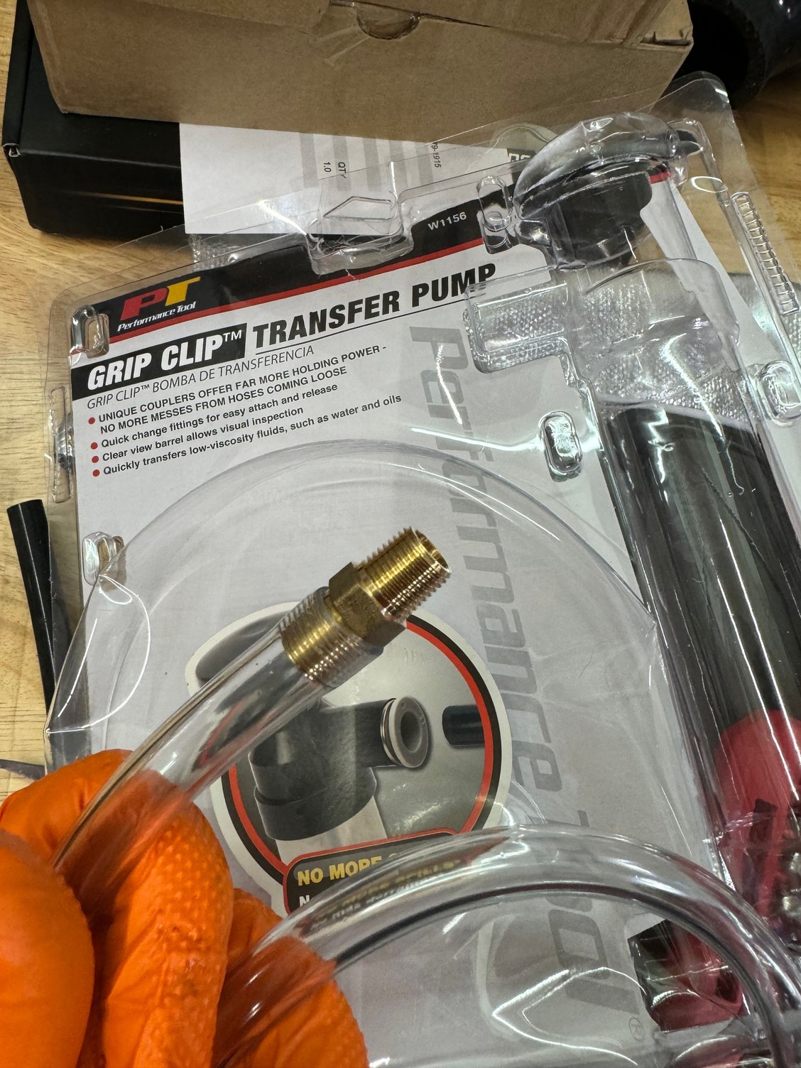

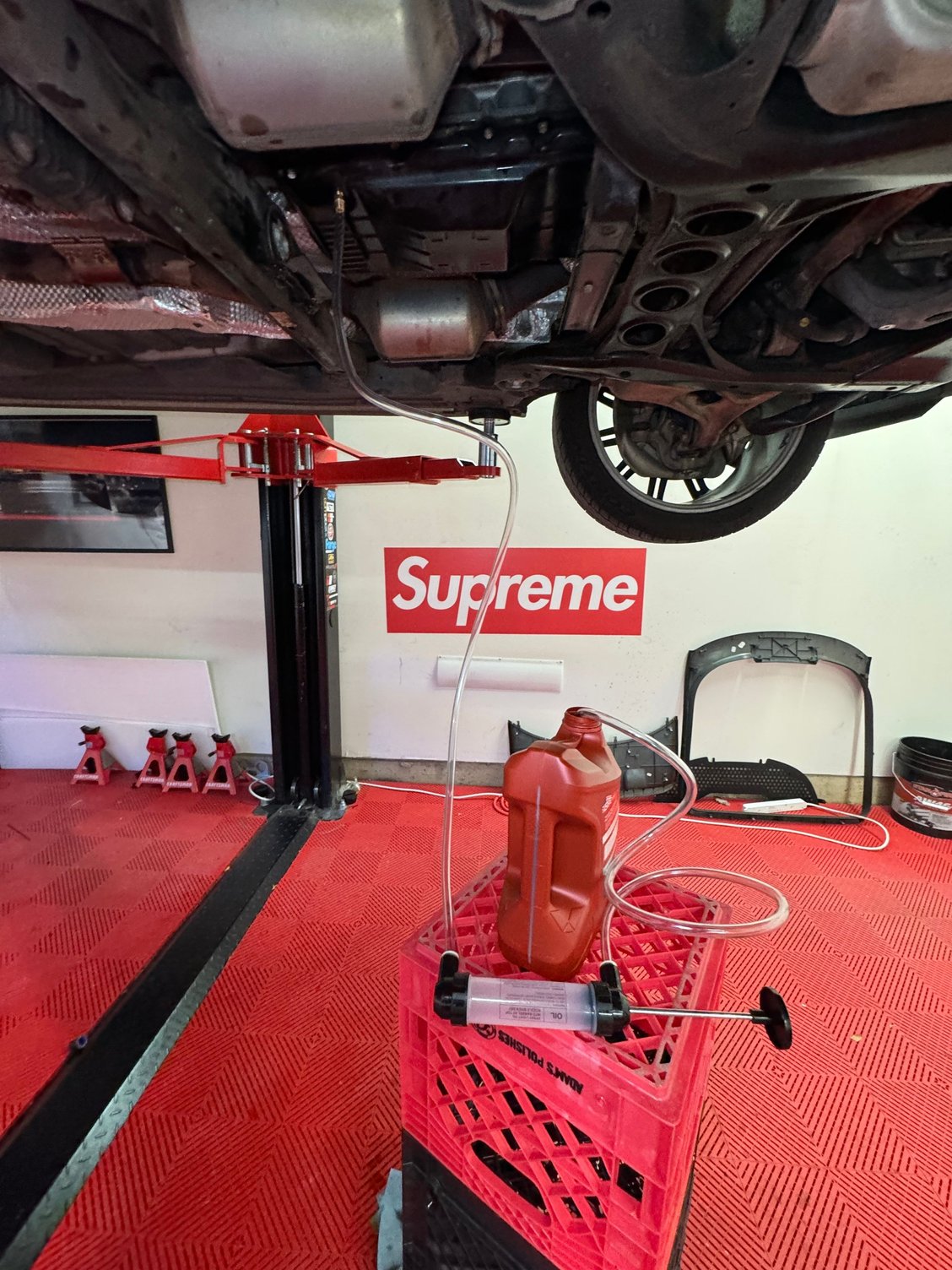

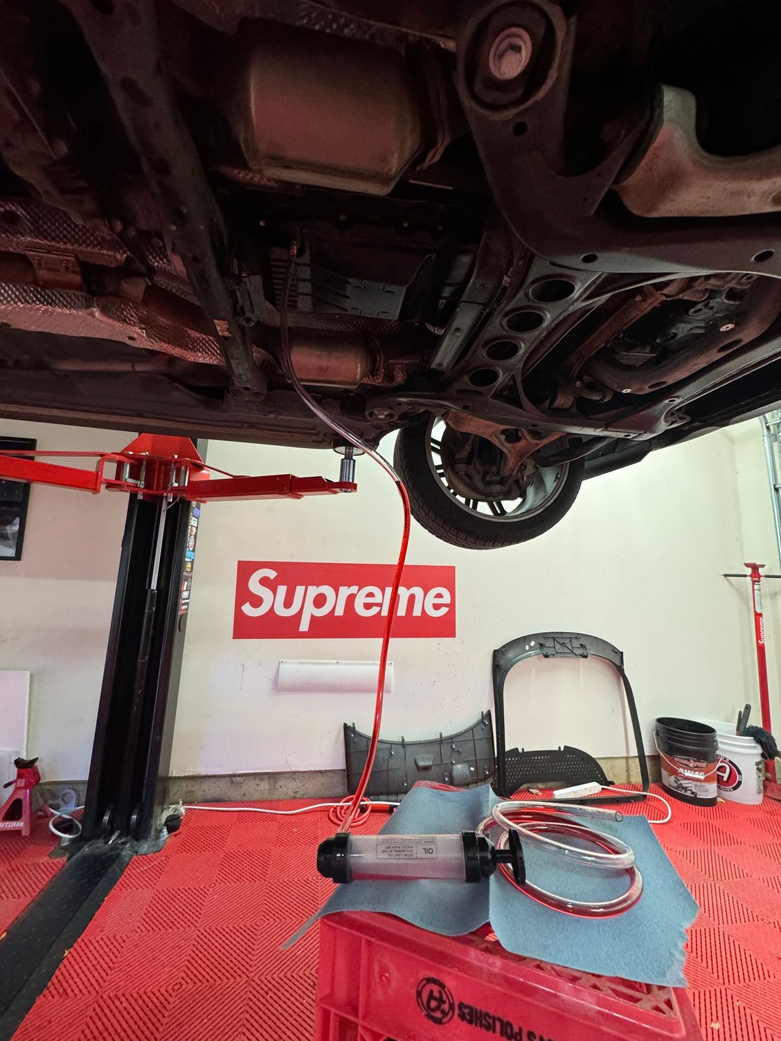

No need to buy an expensive machine a pump from autozone worked perfectly
I used a fitting from Lowes
This was the fitting I used and it worked perfectly
