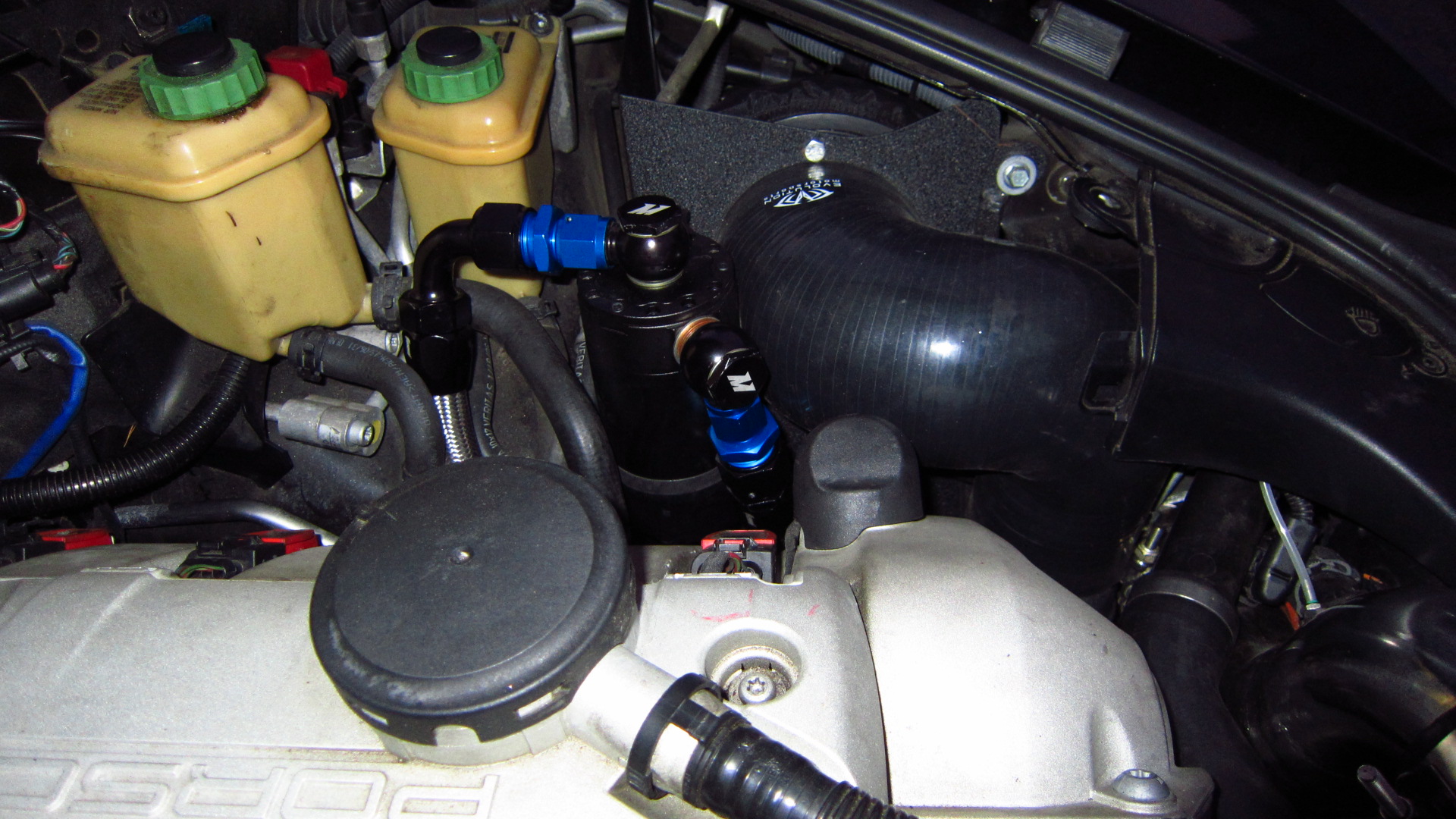

Have you looked into an air-oil separator or catch can setup? You might pick up a bit of timing and some power by getting that oil out of the intake charge. That mist is a mess and really induces detonation.
Good idea - a secondary air-oil separator inline with the stock unit; maybe if you could work in some AN stainless braided lines too that would be awesome. I may or may not be one-step ahead of you on this one.. unconfirmed

Far as the A/O sep. go's
A. Not fair that you didn't list it in your mods;-)
B. What brand, are you happy with it?
C. Is it a catch can or a/o and if the latter where do you have the drain plumbed to?

LOL... I didn't post it b/c it has been the most drawn out project yet. I was working on it for over 3 months (between other more important tasks) and literally just got done with it last week. It is too new to know how well it works.
It is a Mitsimoto baffled oil catch can with a threaded drain in case you wanted to turn it into an air/oil separator. I chose not to do the latter since I did not like the idea of welding into the oil pan in the Cayenne. The oil pan is hard to remove while on the vehicle and you introduce the possibility of warping the pan. So the easiest and most reliable option was to leave it as a catch can.
The design of this unit is pretty impressive; especially the fluid dynamics modelling

The Garrett air-to-air intercoolers are good, but they size their cores for primarily horizontal front mount applications. They have very few options for vertical side mount applications. So when all was said and done, I went with ETS cores since they seem to be able hold their own against the current OEM standard in the 911 world, the 997.2/GT2RS intercoolers.
Way to go man. You know you have been holding on doing the intercooler replacement for a while. I'm very excited to see what you will come up with.
Next in the list should be replacing the Turbos..
Old Jul 17, 2014 | 02:35 PM
  #30
TT VIPER's Avatar
Joined: Jun 2008
Posts: 138
From: Europe
TT VIPER is infamous around these parts
What are the dimensions of that intercooler? ETS is well known performance company and a strong player in the GTR league. Their products are very high quality.
