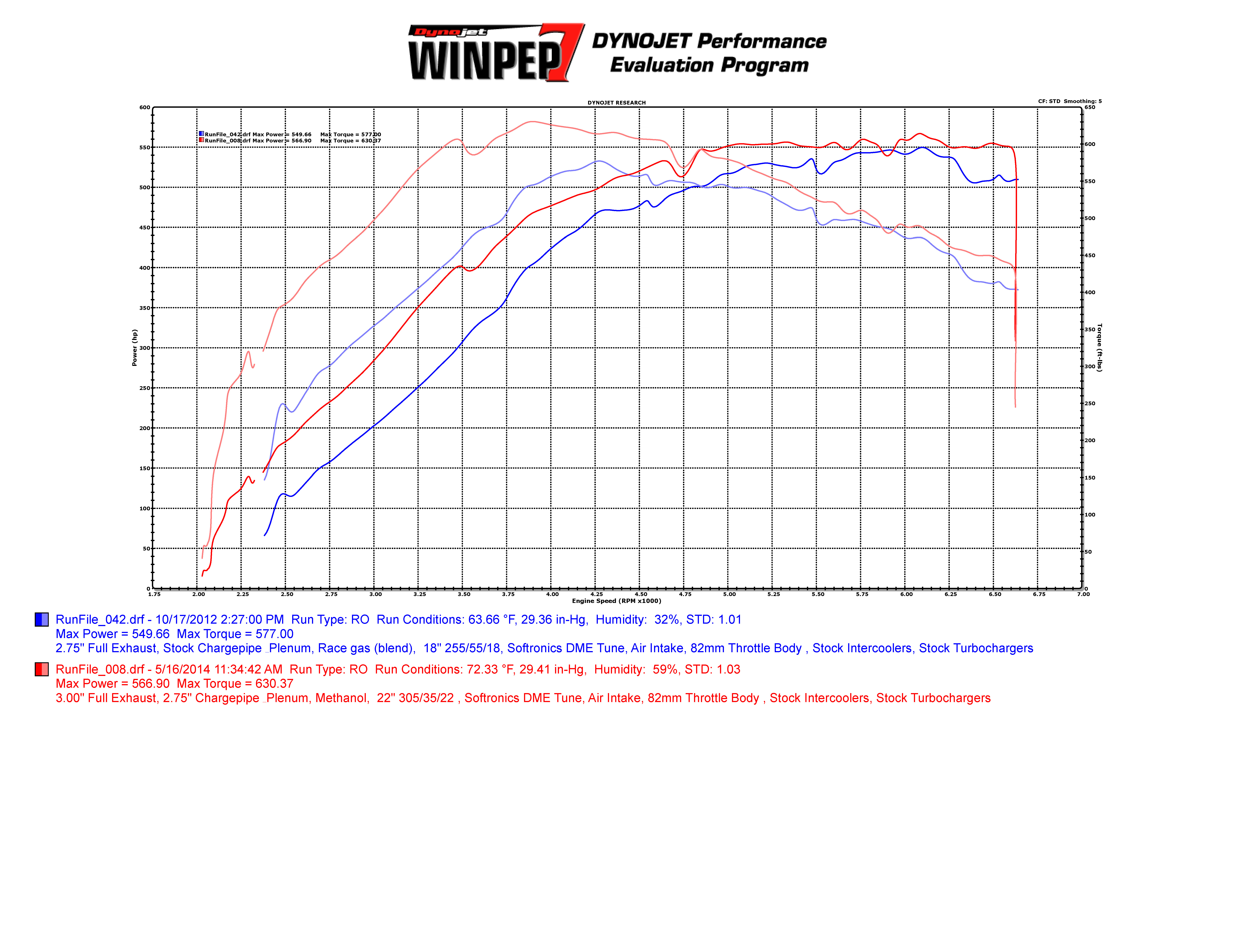

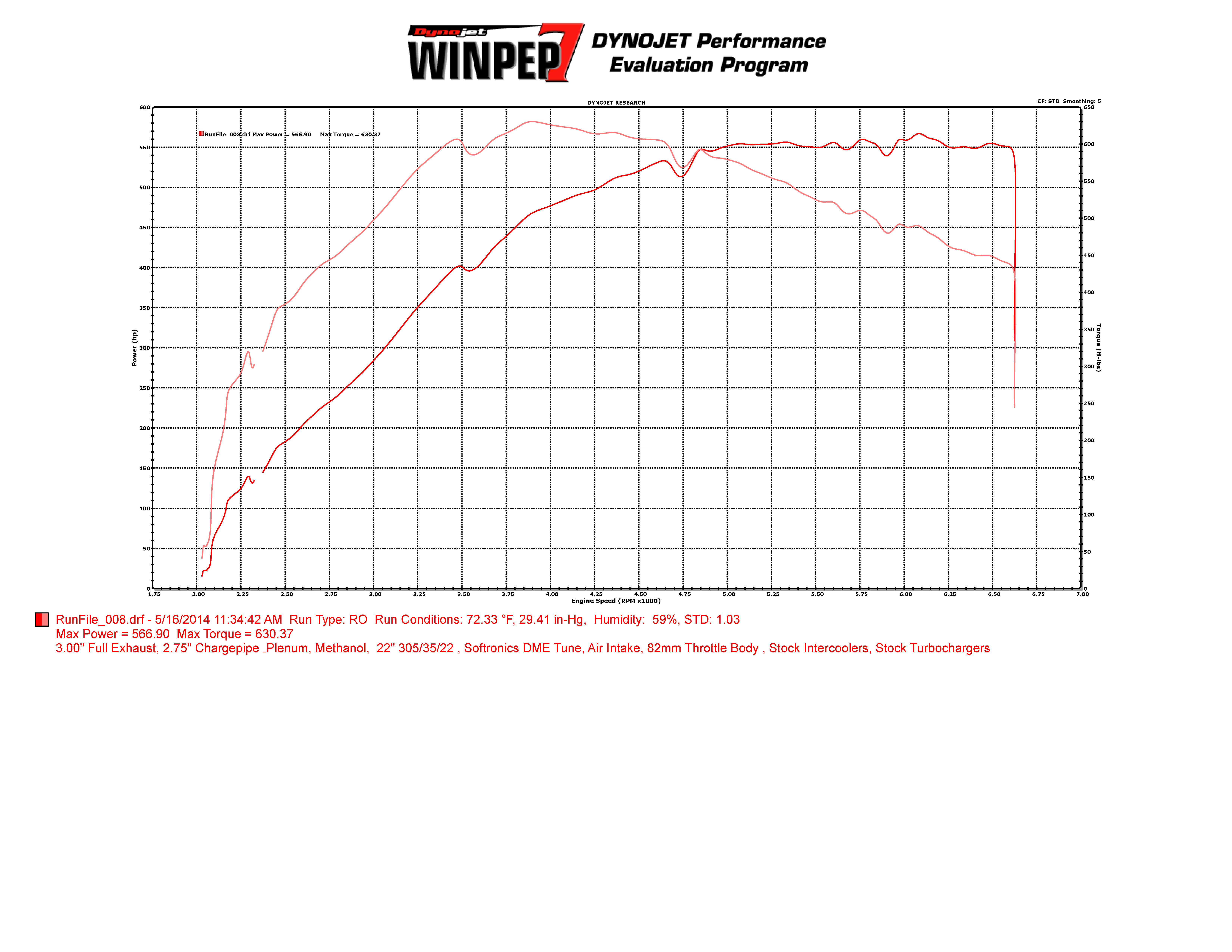

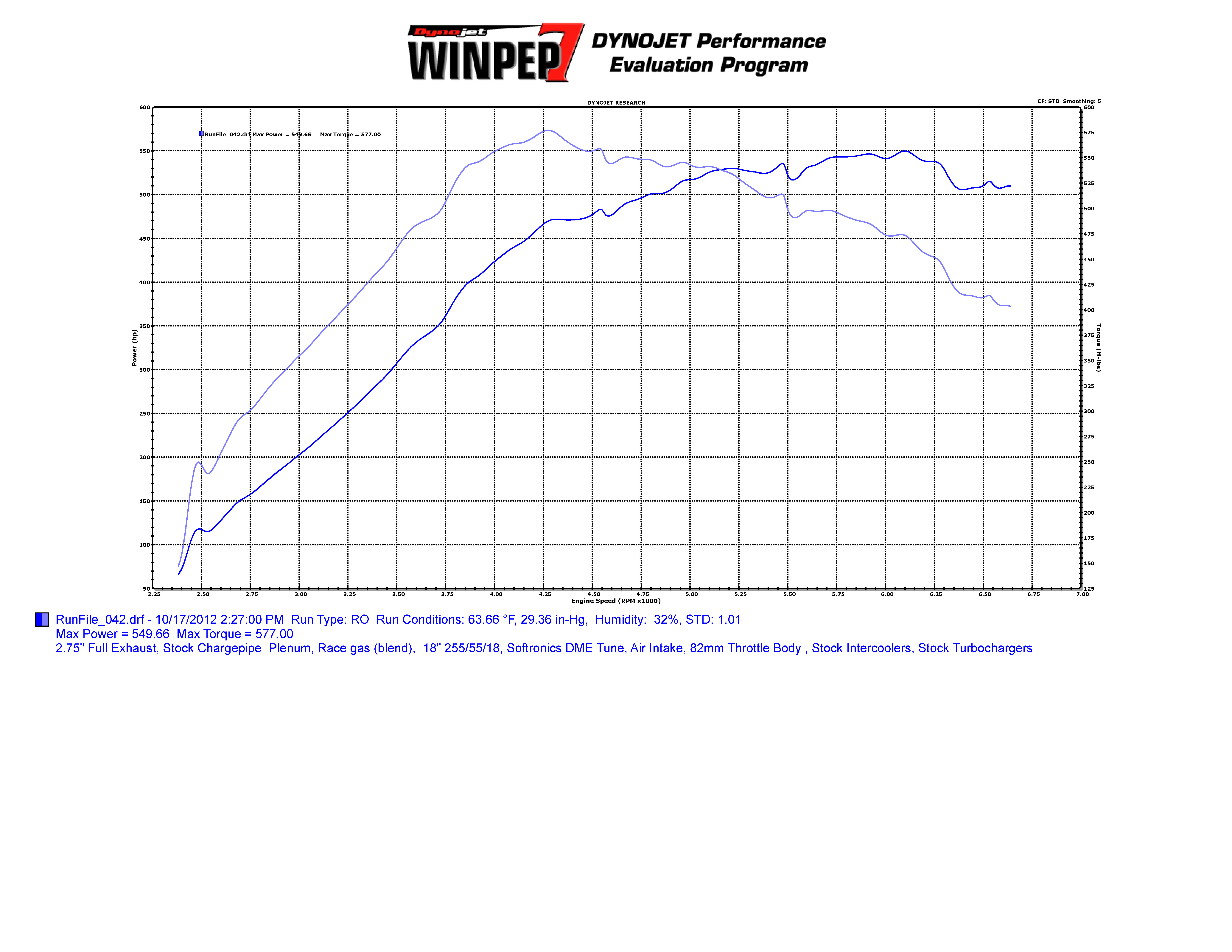

Finally had a chance to go back to the same AWD dyno last May, where I got 550 hp / 582 tq (about 675 hp / 710 tq) back in October 2012.
Back in October 2012, I had the following mods:
  • Softronics tune
  • EVOMS Intake
  • AP Diverter Valves
  • 82mm TB / Intake Manifold
  • 1-Stage colder IK22 plugs
  • Full 2.75" exhaust
  • 93 octane / 104 octane (blend)
  • Stock Intercoolers
  • Stock Turbochargers
Since then, I went to:
  • Stock Bosch plugs
  • Custom 2.75" Plenum and Chargepipe/ Y-Pipe
  • Methanol kit
  • Full 3" exhaust
  • Transmission cooler
When all was said, and the dust settled, I was surprised (yet again) at what this stock engine, tranny, intercoolers, and turbos could do.
She dyno'd out at 566 hp / 630 tq at the wheels. Taking into account about 22% for drivetrain loss and I am at:
Approx. 726 hp / 808 tq at the crank!
Anyone who says that going opening up the intake and exhaust on a forced-induction car, will hurt performance somewhere in the powerband, clearly has not see this comparison.
Here is an overlay of the dyno session in 2012 with the 2014 dyno session. After opening up the intake and exhaust even more, it made more power EVERYWHERE in the powerband!! The Red line is the 3" exhaust & YPipe and the Blue line is the 2.75" exhaust and stock YPipe
Special thanks to one of our vendors, Scott over at Softronics. I have ran many of his Cayenne 957 tunes to great effect and can highly recommend them! The proof is in the pudding!

Even though these numbers are phenomenal, I will be working with Scott to get VBox verified 60-130mph times. I am confident that we can get another Cayenne on the fastest 6Speedonline official 60-130mph list here.
I am not sure where I will end up, but I stand a good chance of matching or besting the "10.3 - Audi R8 5.2 FSI" (V10) entry. How wild would that be for a heavy almost 3 ton SUV? Anything can happen, but I have high hopes.
Also, Scott and I are working on a MAFLess tune right now and colder plugs. I will go back to the dyno and hopefully squeak a little more out. Wish me luck!
