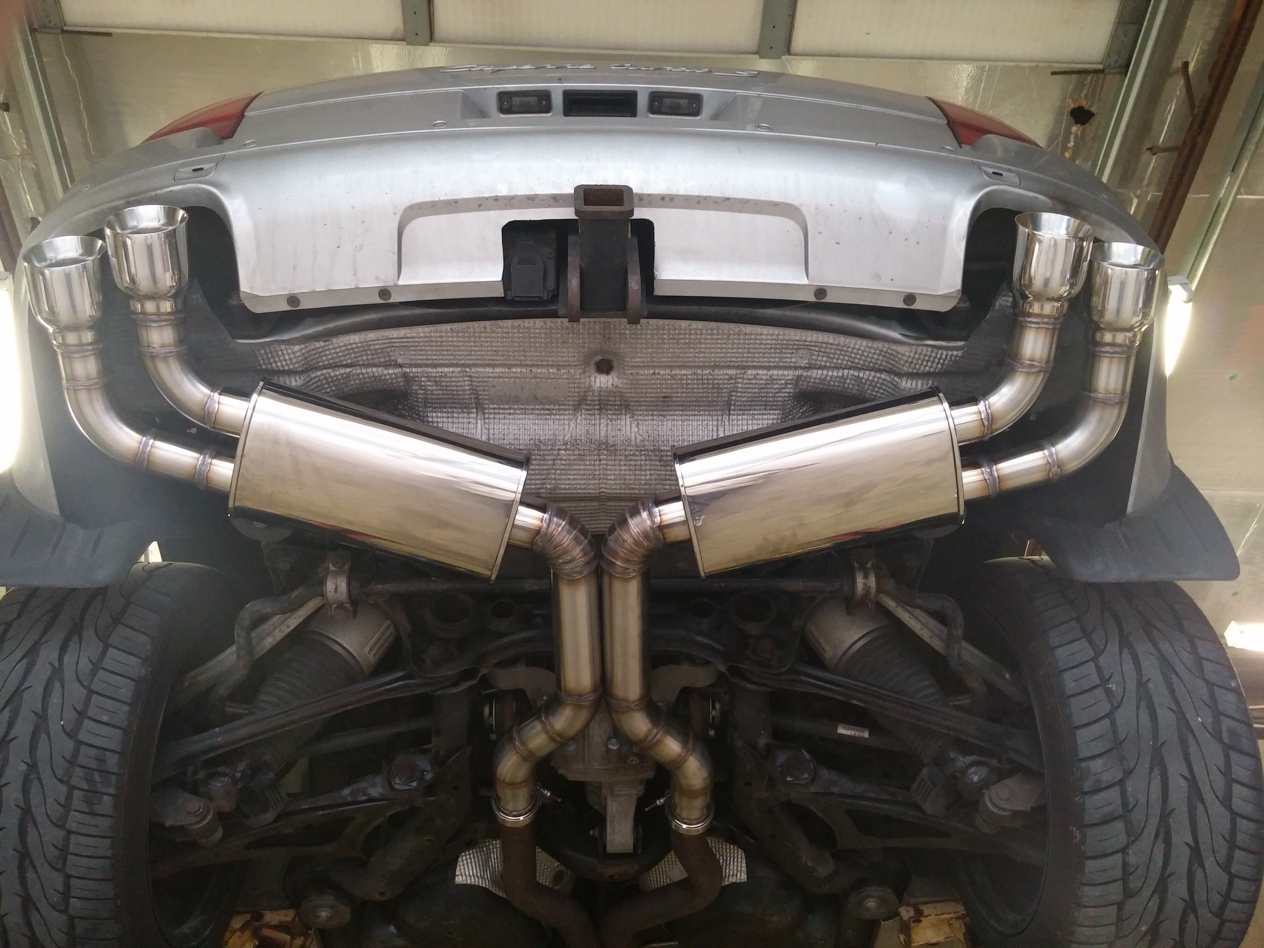

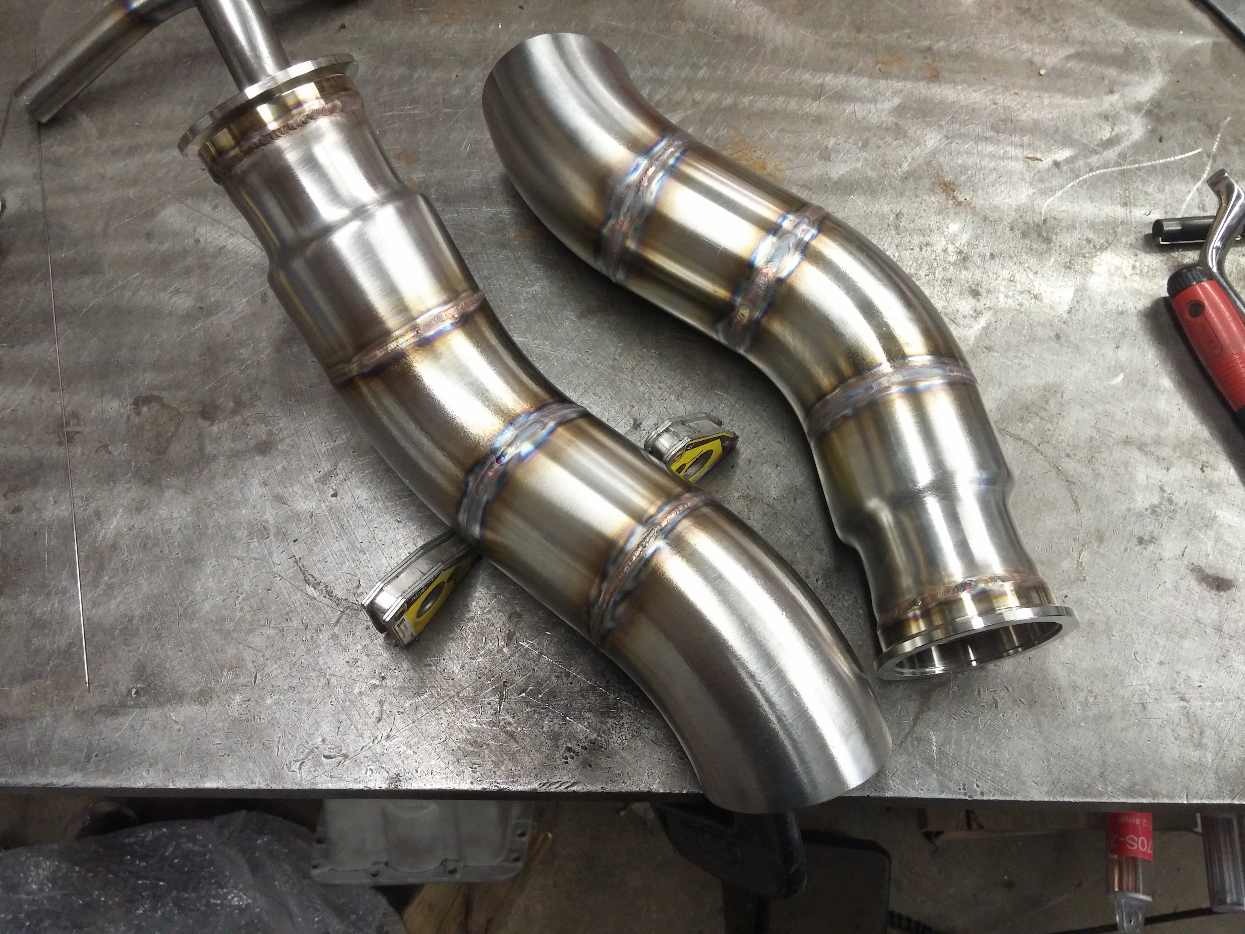

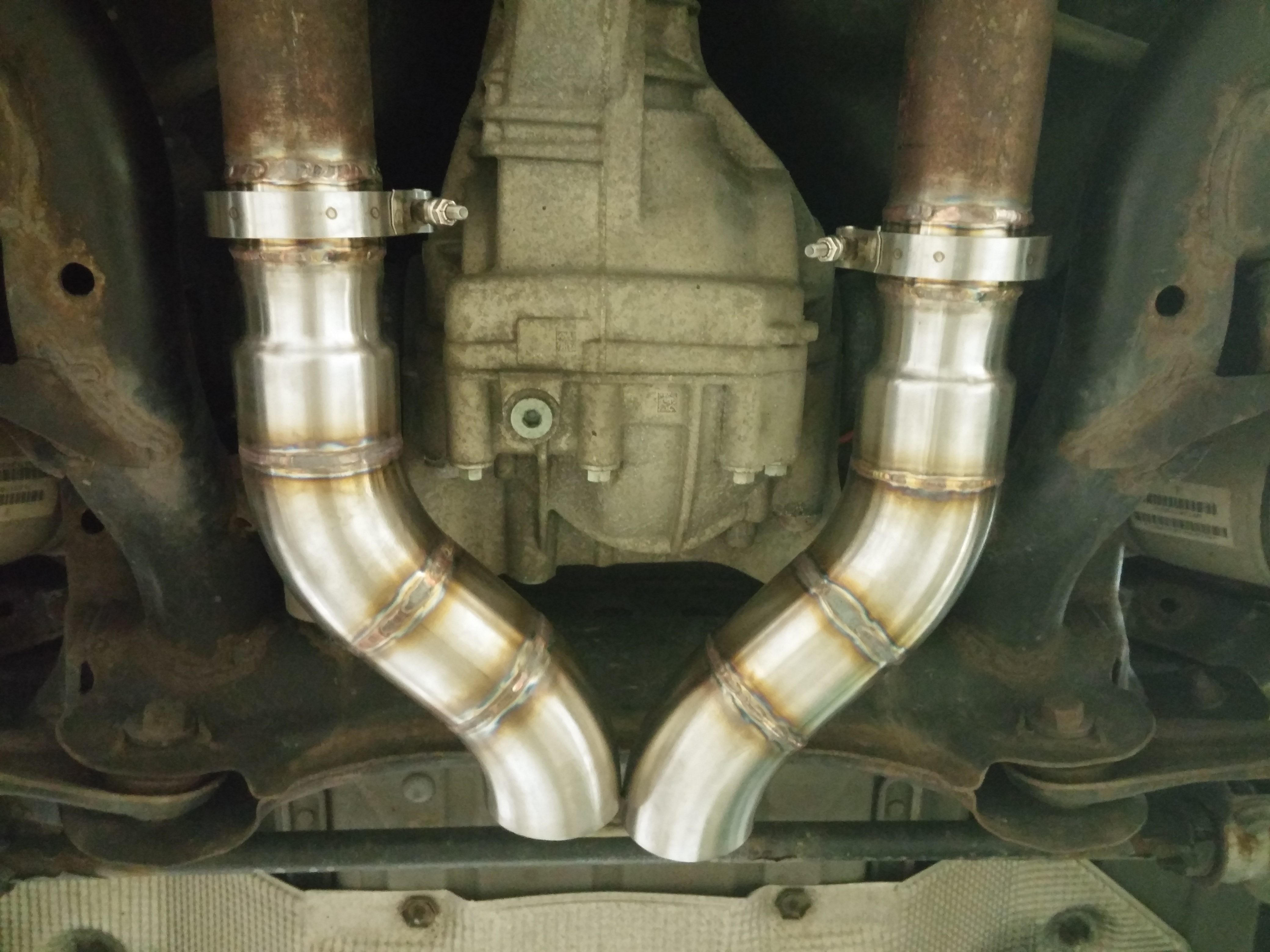

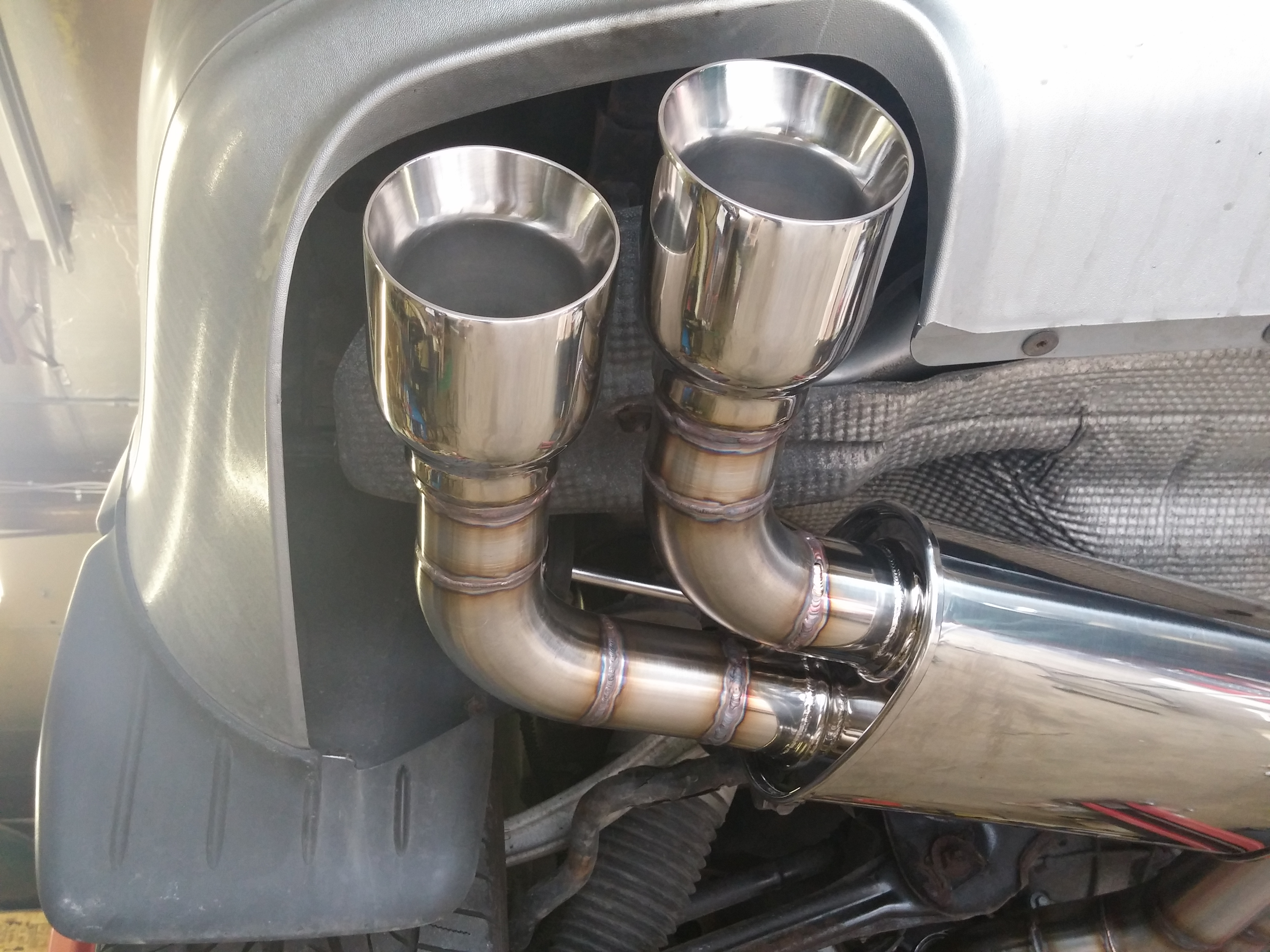

I've had my Cayenne for about 2 years now, and I finally got around to making a small exhaust for it and figured maybe someone here would at least like to see it....

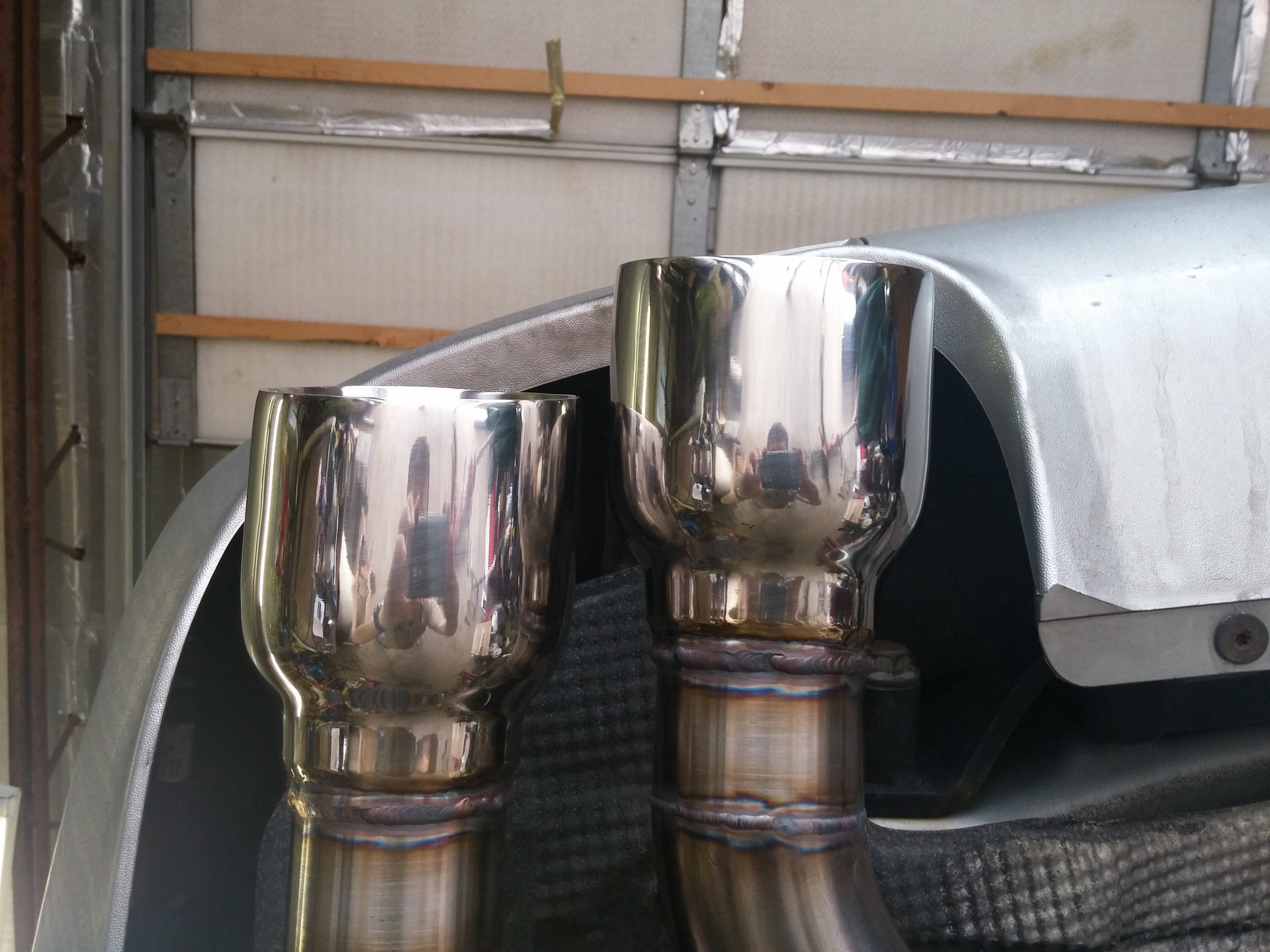

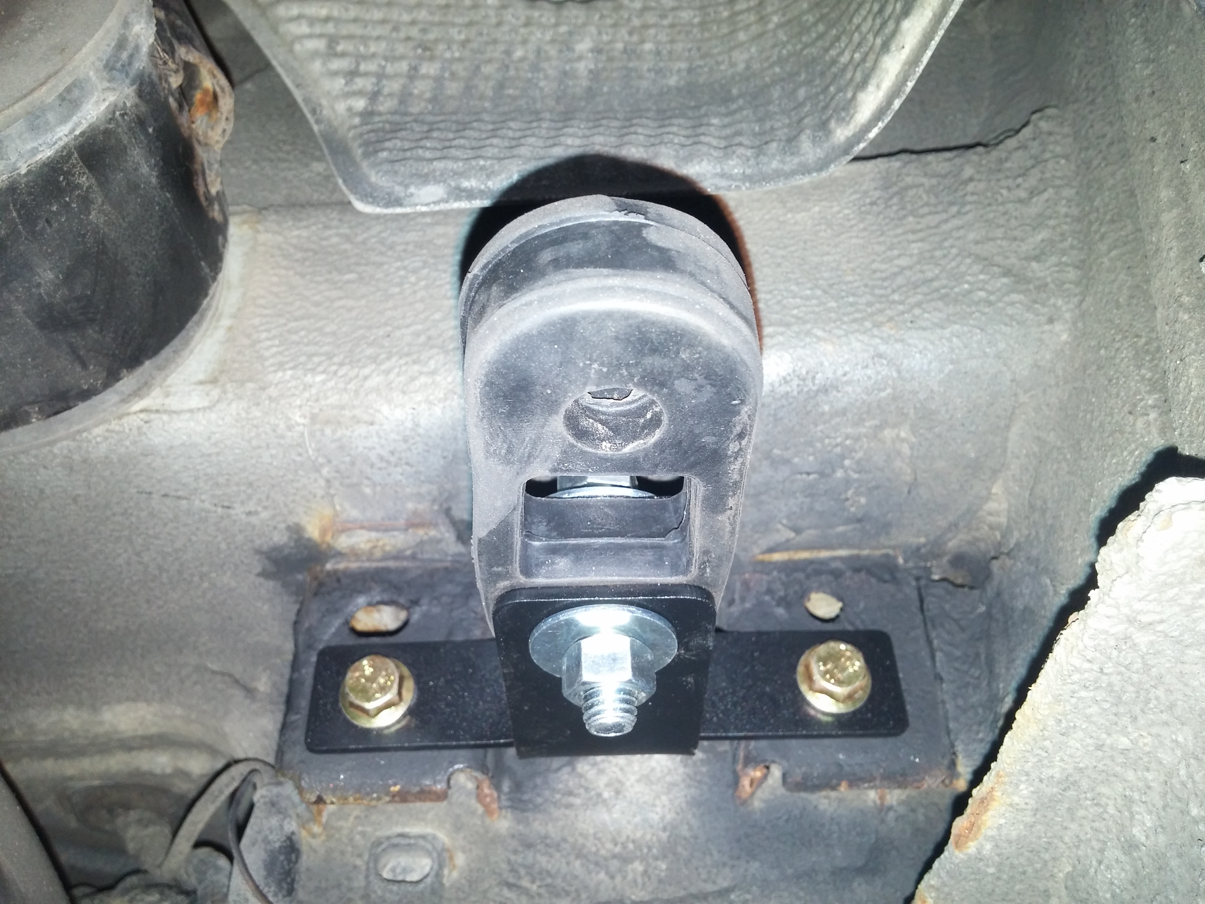

I basically cut out the rear muffler and welded on V-bands to attach the new exhaust, that way I can re-attache the oem muffler if I didn't like it or wanted to return to stock. It is made out of 304 ss in 3" after I stretched it from the oem 2.5". I used two Vibrant 3" in dual 2.5" out mufflers which are also 304 ss. Then finished it off with 4 4" double walled tips. I also made new hangers since the oem hangers were rusted pretty bad, and I didn't order replacements as I didn't realize how bad they were. I used 1/2 hangers, also 304, that I bent and welded directly to the mufflers.

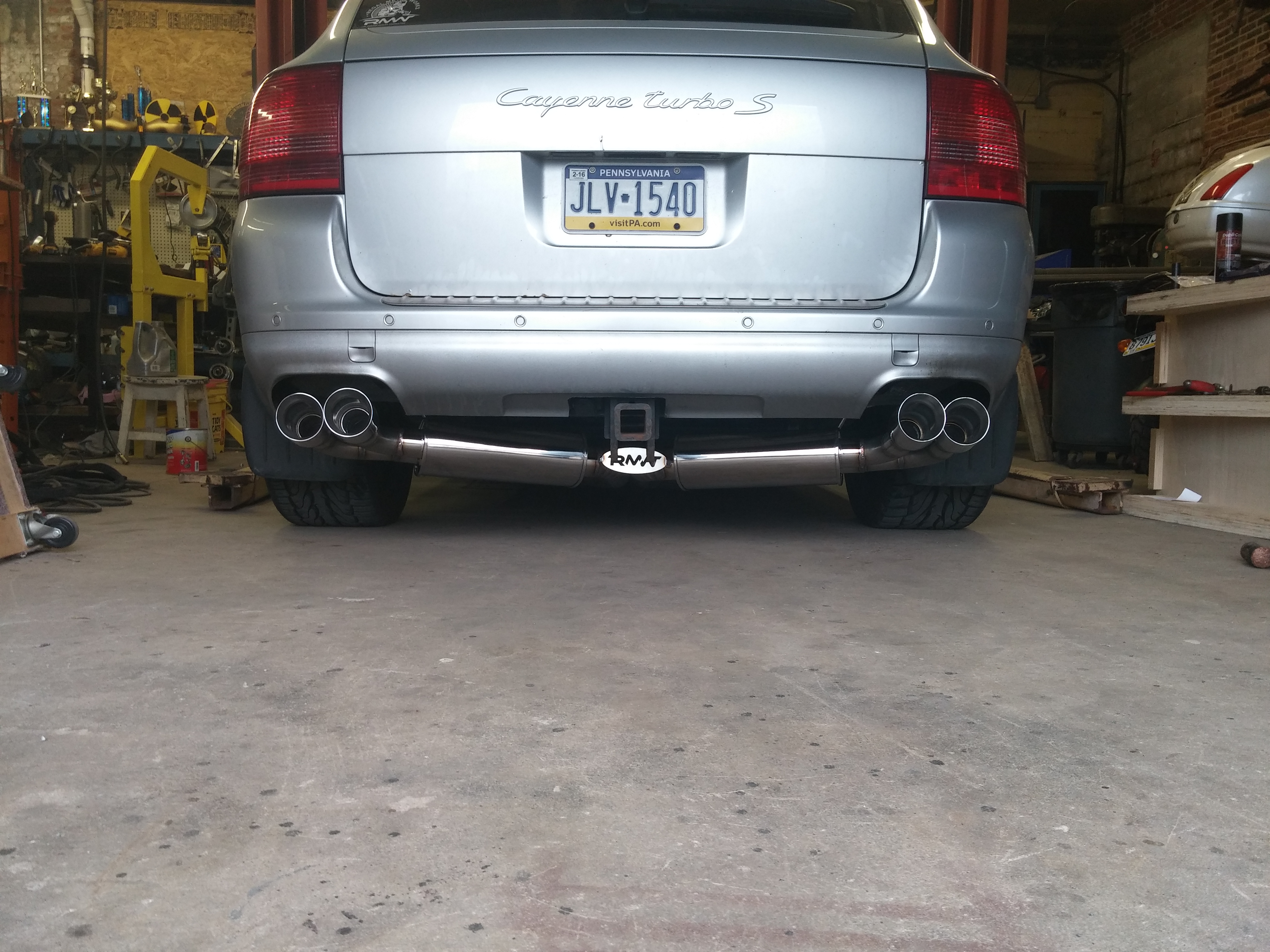

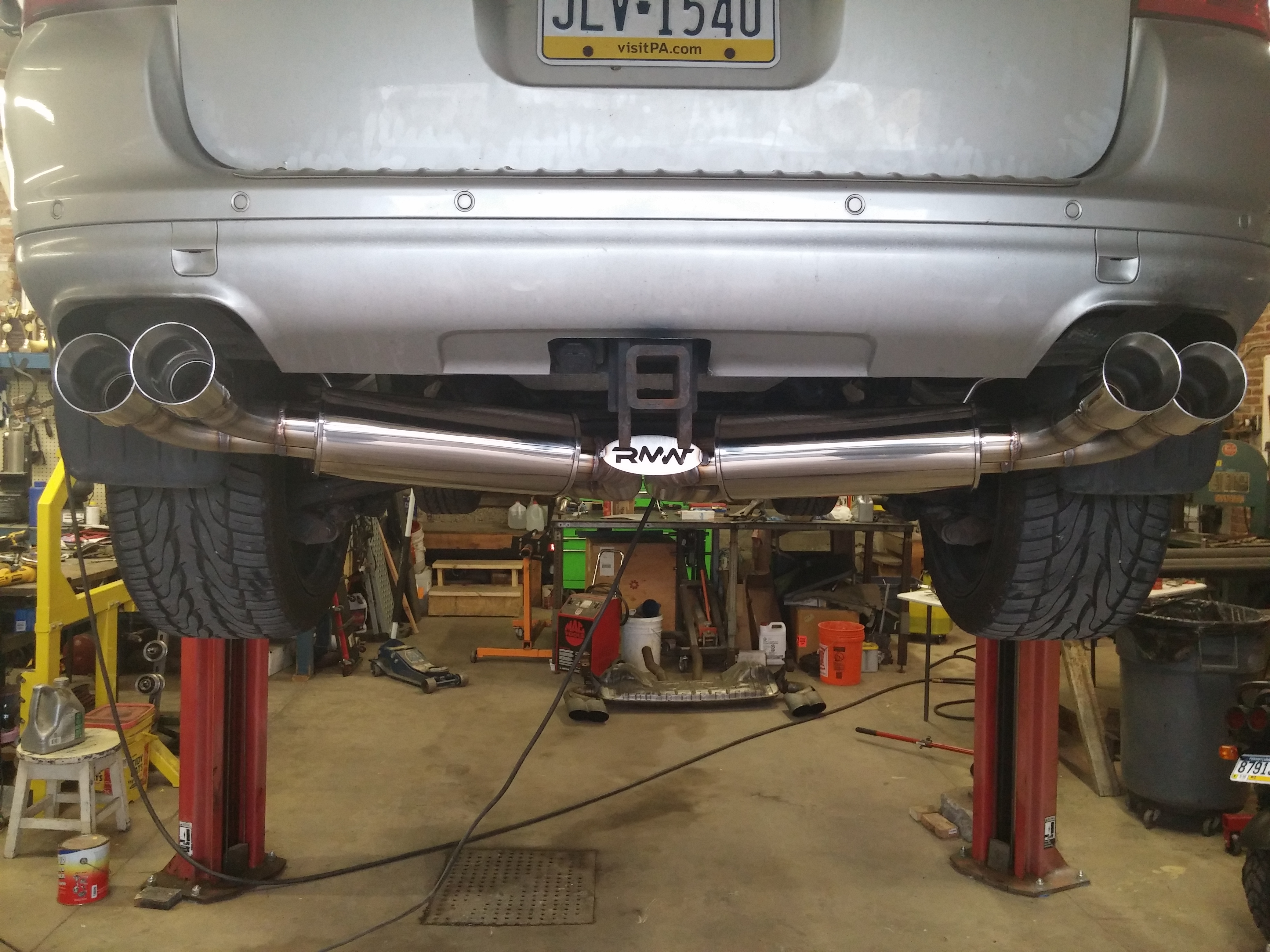

And here is how it sits....I plan on raising the entire exhaust another .5~1" by moving the hangers since it sits a little low. I also added my logo out of 304 and used it as a brace welding both the exhausts together so they stay at the same height.
Overall, I was expecting it to be obnoxiously loud, thus the v-band to easily swap back, but I was very surprised that it is very quiet, with a lot more rumble now. Highway speeds has no drone and it is still very quiet inside the cab of the vehicle.... This has not been my normal result on any of my other exhausts I've made over the years!

From the low level rear view I'd agree the center of it needs to come up a bit, but other than that it looks AMAZING!!!

Oh the tips can be found on eBay for $50 a set. They are made in china, but a decent quality. I had a few left over from a 996 exhaust job and really liked them, since I didn't have to take days making them.
