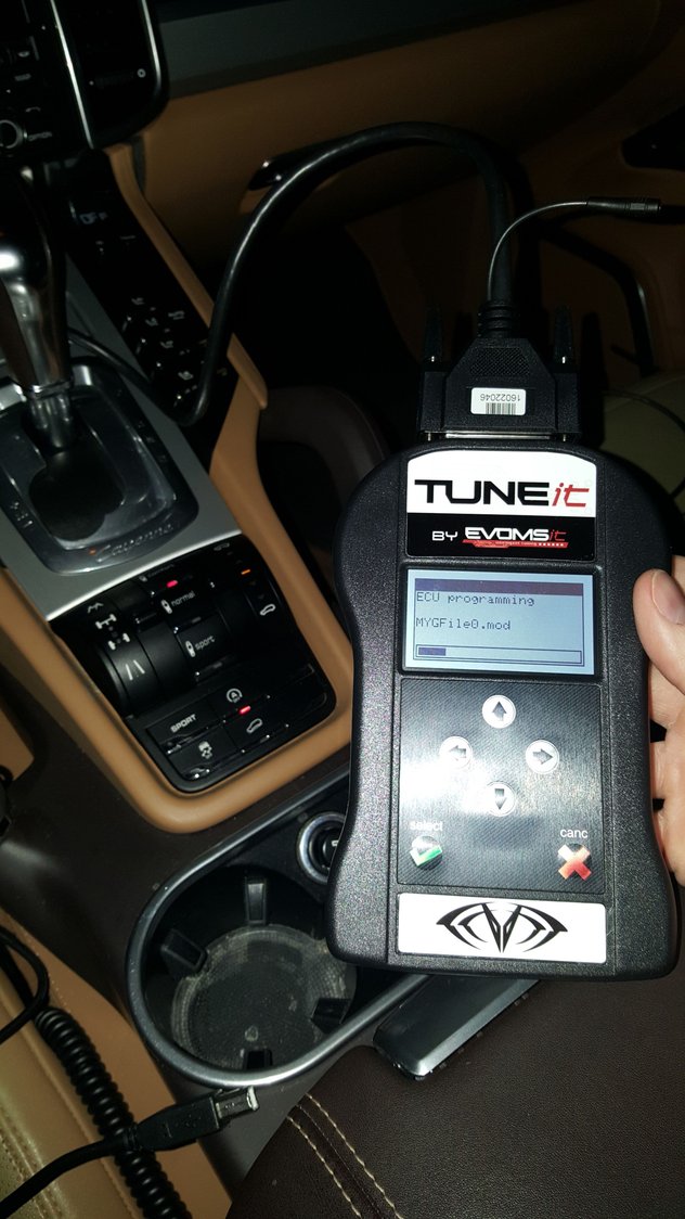

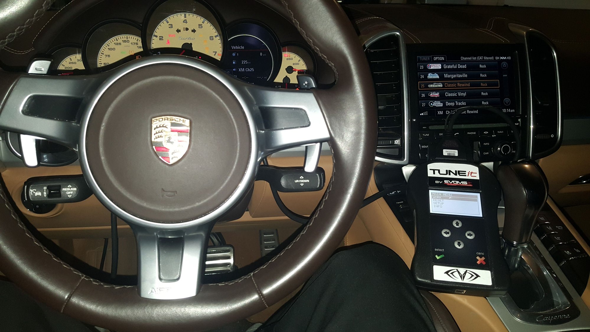

I worked with EVO yesterday and we got her tuned!!! It couldn't have been easier, this was my first time flashing and now that I've done it I know anyone could do it.
I'll give an overview below on those steps but first I've got to give some feedback with the performance gain!
The first thing I noticed was boost built much quicker! I've never seen my boost gauge jump so fast! The second thing I noticed was better throttle response. After a few turns I also noticed how the car felt more nimble, which is saying a lot for this heavy beast! The diverter valves are far more prominent..the list goes on.
I was only able to take a short 10min drive last night but have a 3 hour drive tomorrow so I'll be able to report additional findings and behavior beyond 4th gear later this week.
Flashing overview:
You'll get the following contents in the box
Once you've unboxed the contents you'll plug the USB drive in to your laptop and follow just a few instruction. These will walk you through installing a small application which will allow you to ID (read) and obtain your current file. (As shown below) Next you'll email this file to EVO and within minutes you'll have your flash.
The process to flash is much like the process to read. You'll connect the tunner to your laptop, select the file to transfer and you're ready to flash.
Once the tunner has the file you'll connect via ODB2 and flash away as shown below.

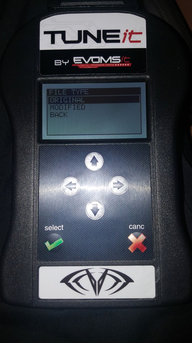

The other really cool part that I noticed is EVO includes the factory flash. (Pictured below) At any given time you want to flash it back to stock just hook your tunner up and choose "Original". These files are all stored on the device so no need to carry your laptop around, just toss the tunner in one of the compartments in the back.
