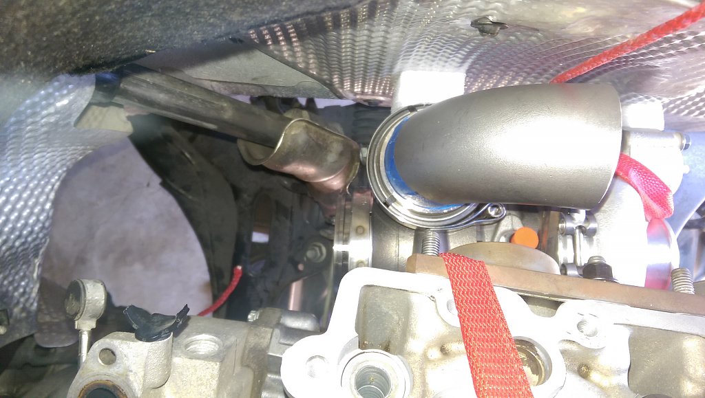

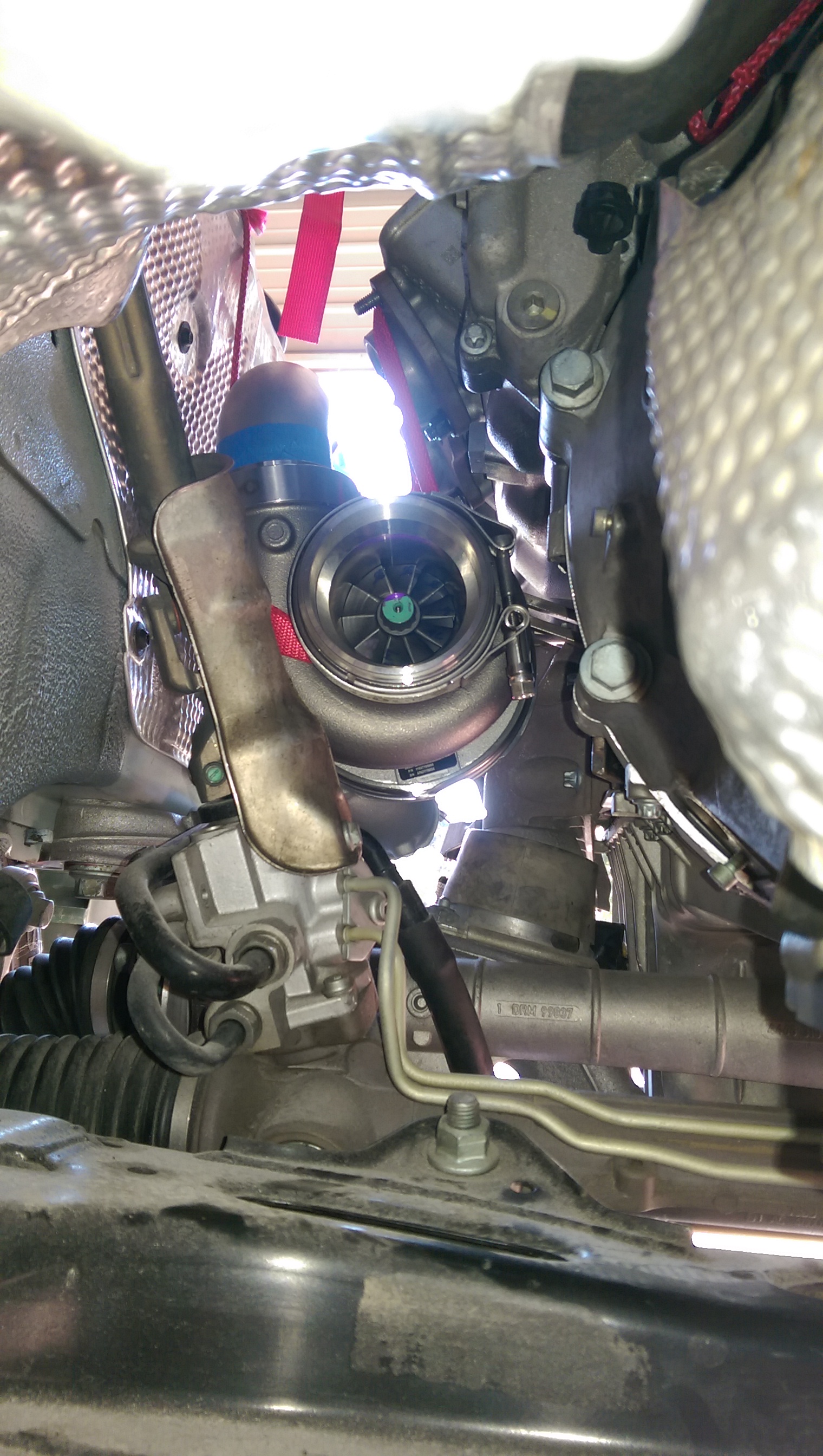

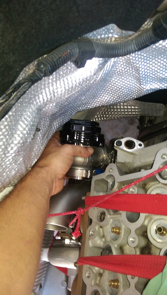

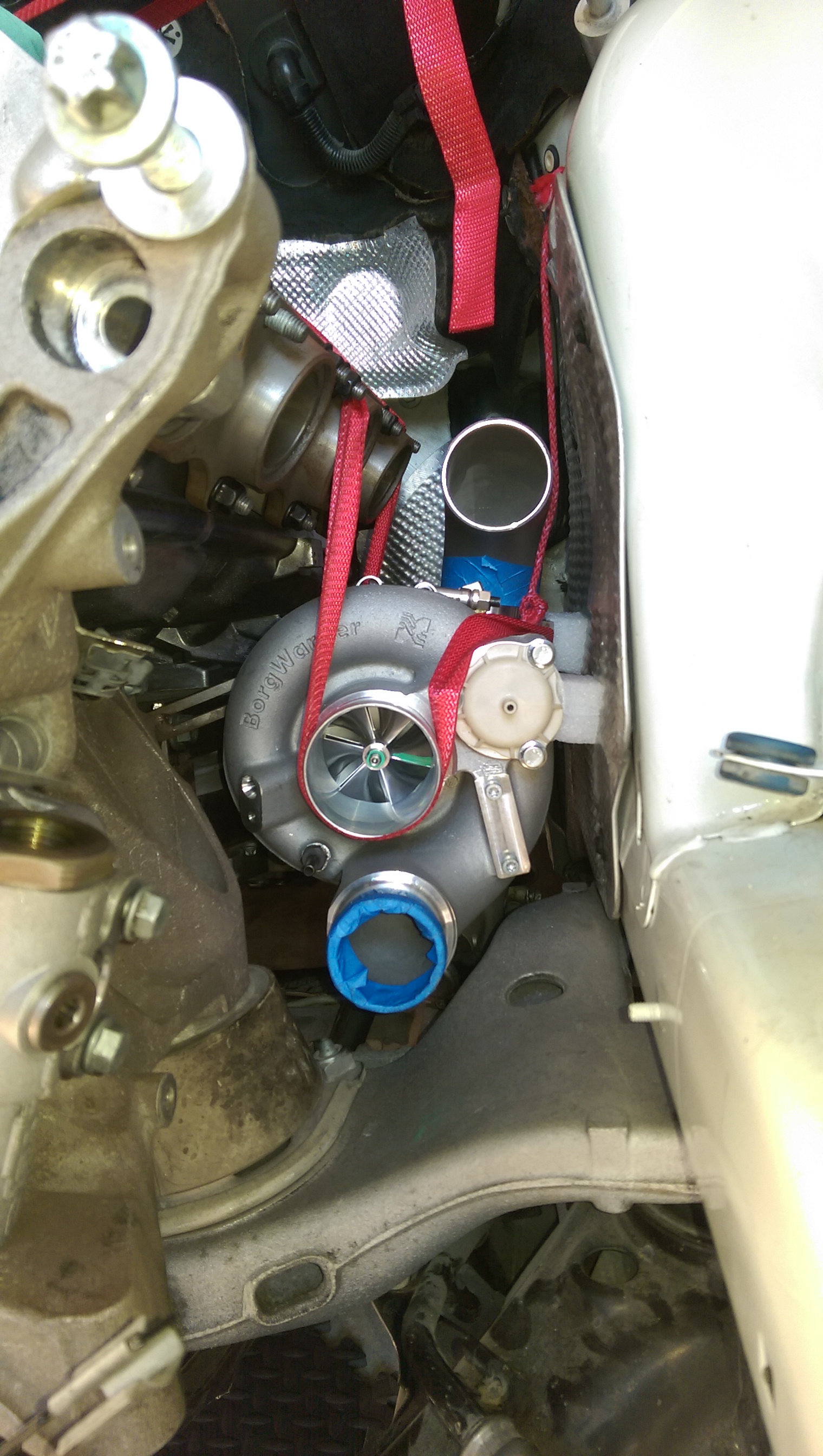

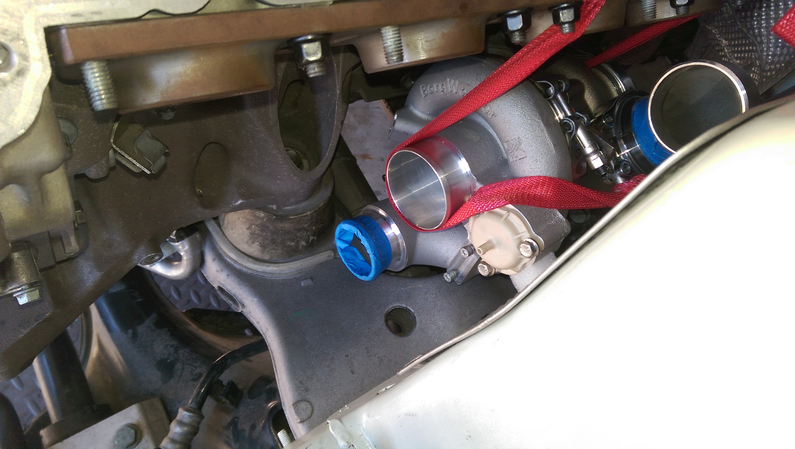

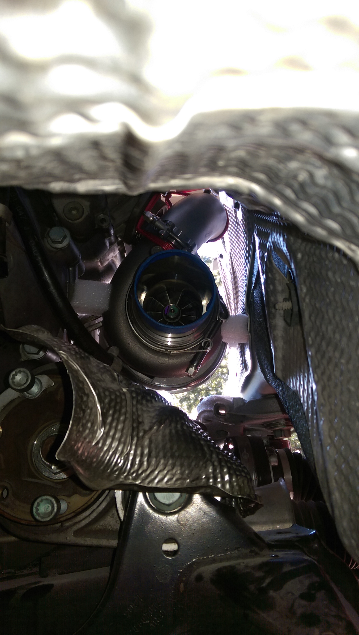

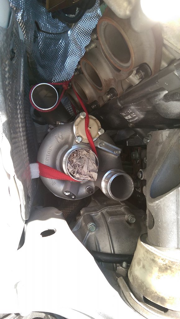

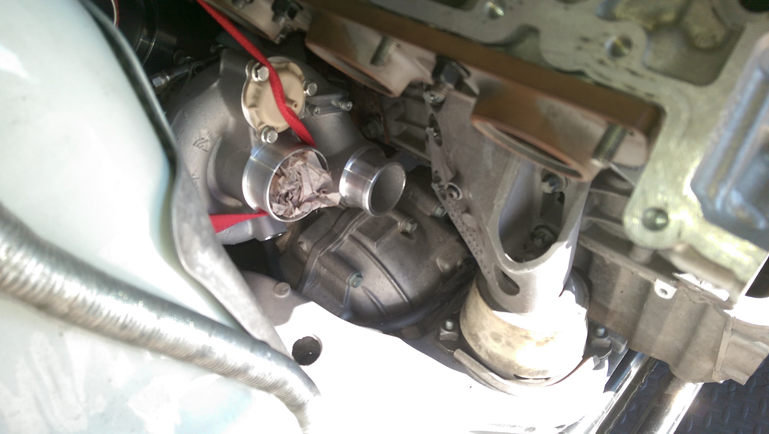

MY top normal/DIY picks for a stock CTT, in no particular order but generally you want to tune last.
Primary cat delete
Water/Meth injection (a form of intercooling )
BMC Air Filters
Diverter valves
Intercooling (air to air )
AS far as primary cats and larger turbos go together in the CTT, well, they don't. Matter of fact, there are some real issues with fitting larger turbos in the CTT.
Only HKS makes symmetrical turbos that would be applicible to the Cayenne. They are imported, based on the Garrett GT series, and prohibitively expensive.
The front differential in the CTT makes life really tough when fitting a turbo. So does the engine crossmember.
A normal straight non-symmetrical compressor housing doesn't work well in the CTT. Assuming you have a gt30 sized turbo or smaller, no matter where you place the turbo's axially alongside the engine, you cant achieve the balance of compressor outlet placement(consider you will have to weld a 90 onto the cover and its going to be one tight a** 90), turbine inlet placement, manifold design while still flowing well and complimenting thermal expansion to avoid cracking, fitting in the confined space, downpipe placement, wastegate placement with proper flow dynamics and servicability/installation/removal taken into consideration, being able to remove the turbo's with the engine in place, all while maintaining manifold/wastegate-design/flow symmetry, taking heat management into consideration, taking all the plumbing of the oil/water/scavenge lines, AND NOT CUTTING THE CAR!
I will achieve what I believe to be the best balance of ALL these requirements prioritizing compressor outlet placement, manifold symmetry, and wastegate placement while compromising none. It has taken a while and was just recently made possible by some compressor cover offerings from Borg Warners efr line.
EFR 7163's, 44mm mvr external Wastegates, Il have a dual in,single out FMIC setup and the EFR's have built in CBV's so there is no plumbing to worry about there. Check it out. It's gonna happen, for sure. And its gonna get finished, for sure.
