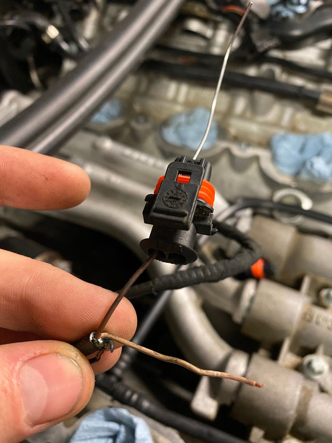

The problem was Code P0327 knock-out sensor low input. So I replaced the 2 knock sensors with new ones.
Reset the ecu and took it for a drive. After hitting 0.8 boost one the first pedal car went in limp mode. Read out the ecu and again the same code.
Then I dismantled half the engine again and started measuring the wires from the ecu to the sensors. Bank 1 sensor use pin 106, bank 2 107. Pin 99 is for both sensors ground.
The wire from bank 1 sensor pin 106 was disconnected inside the plug of the sensor. Couldn’t see the problem with my eyes. But did measure it.
Repaired the wire of the plug and reset the ecu again. Problem solved!!
