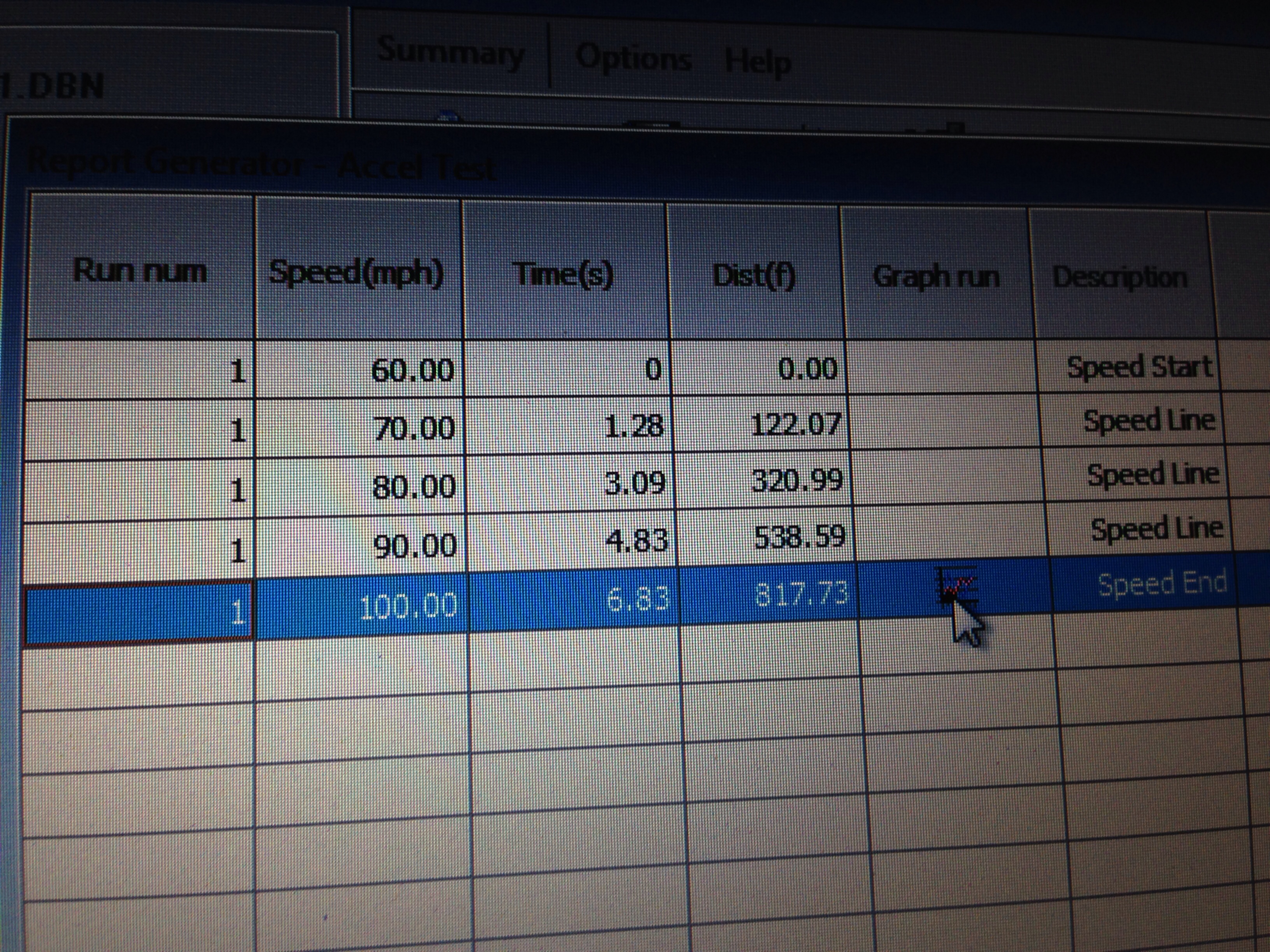

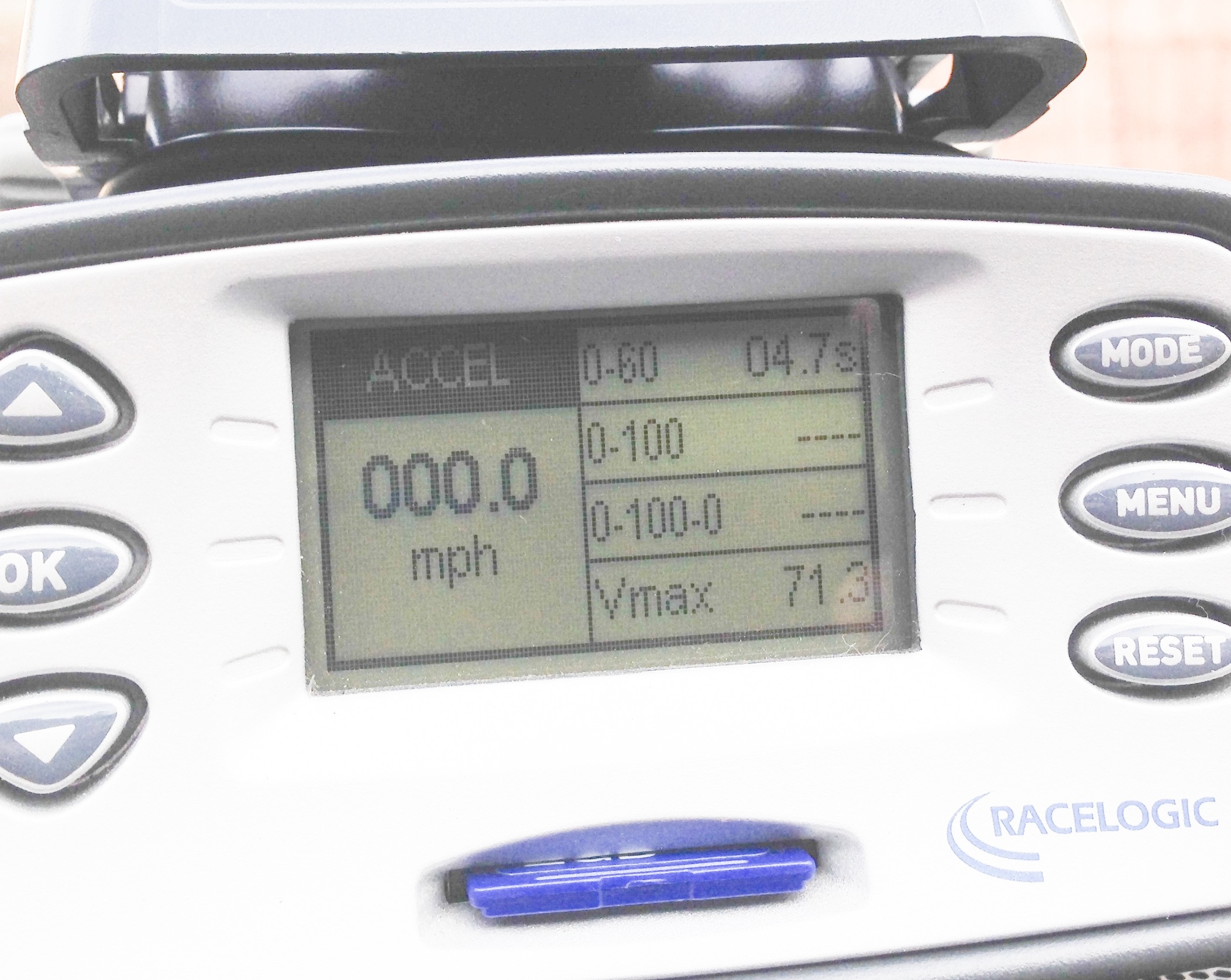

Cam, I just ran a 4.7 0-60 and an 6.83 60-100. Bone stock.
ID:	300799   Click image for larger version
