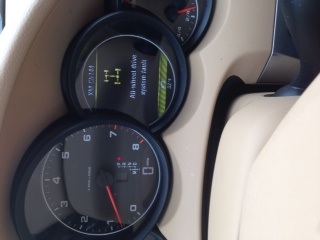

Below please see the TPMS fault screen shot. Just got a tire repair. Not sure if they did something with a sensor or I need to RESET somehow?
Every time I start my car I get this fault.
I appreciate your comments.

I'm familiar with system and resets but your picture isn't clear.
Can't read the script message

Oops. Sorry, the fault states " all-wheel drive system fault".
Tire pressure main Manu
Fill info - all four tires < +/- 3 psi (from 34 F/ 39 R setting)
Tire info- part load
Charge - all wheel, 18"

That error message does not usually relate to a tire issue. Admittedly it is no coincidence that it popped up after a tire repair but a TPMS sensor defect normally would not trigger that. Perhaps you tire guys messed up something during the repair. I suggest it be brought to an authorized P dealer who will plug in and see the error code its throwing

I would take it to dealer and not say anything about getting the tire fixed or someone else touched the car. not that removing a wheel would trigger that, but would just stay quiet so they cant bs you about something. as far as you know, an error light came on while driving saying you awd system is faulty. they have to fix whatever is wrong under warranty.

Yup. Did the scan at a dealership today; It's the transfer case servo motor defect - ordered parts. It will be repaired next week under warranty - thank god!
