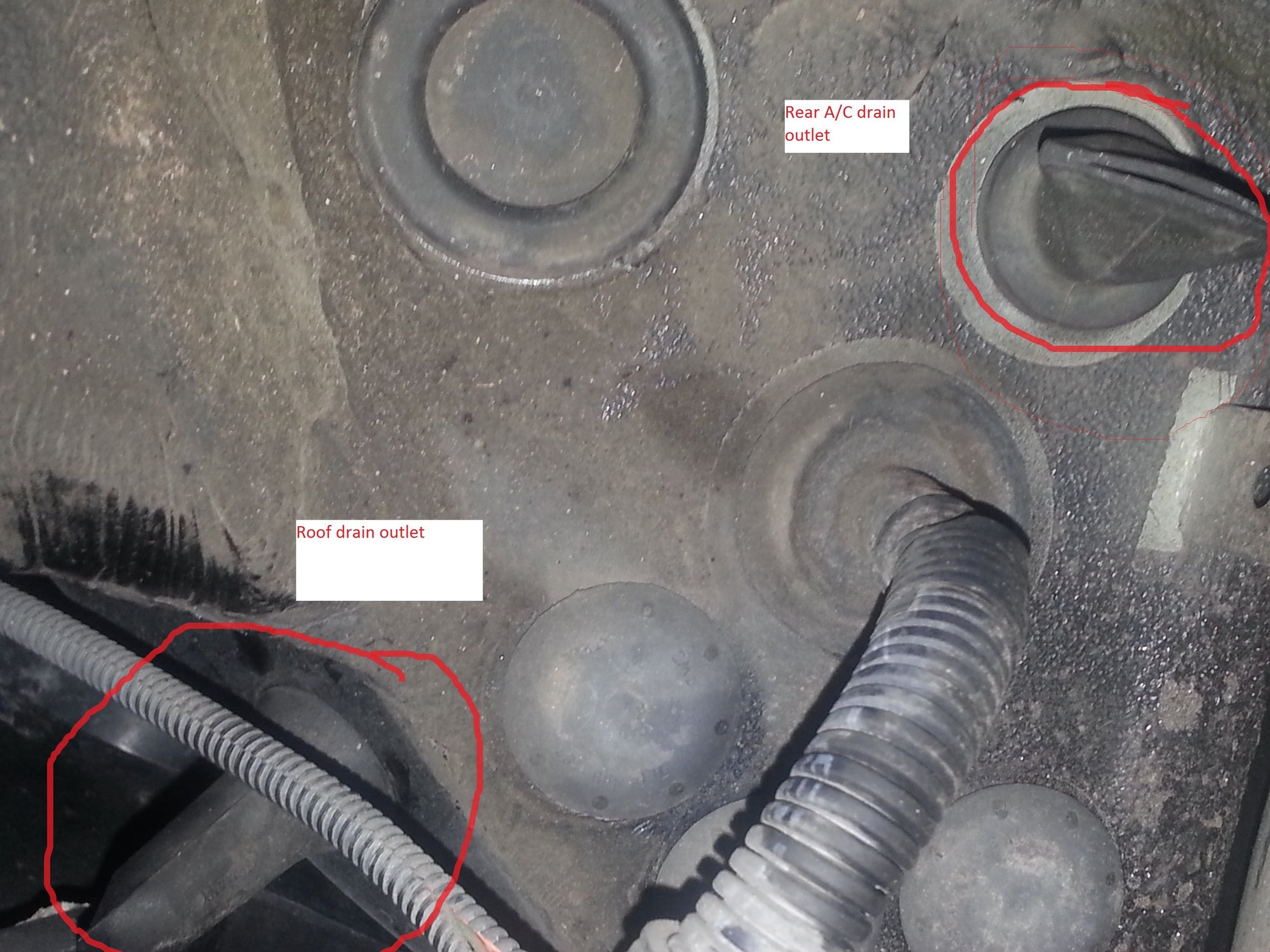

It was hard to get pics of but the drain eventually exits inside the bumper cavity just behind the rear wheel well. It is the one that comes out the back end and not out the bottom, that is the rear condenser drain. Forgive my quick "paint" job of identifying them in the pic.
