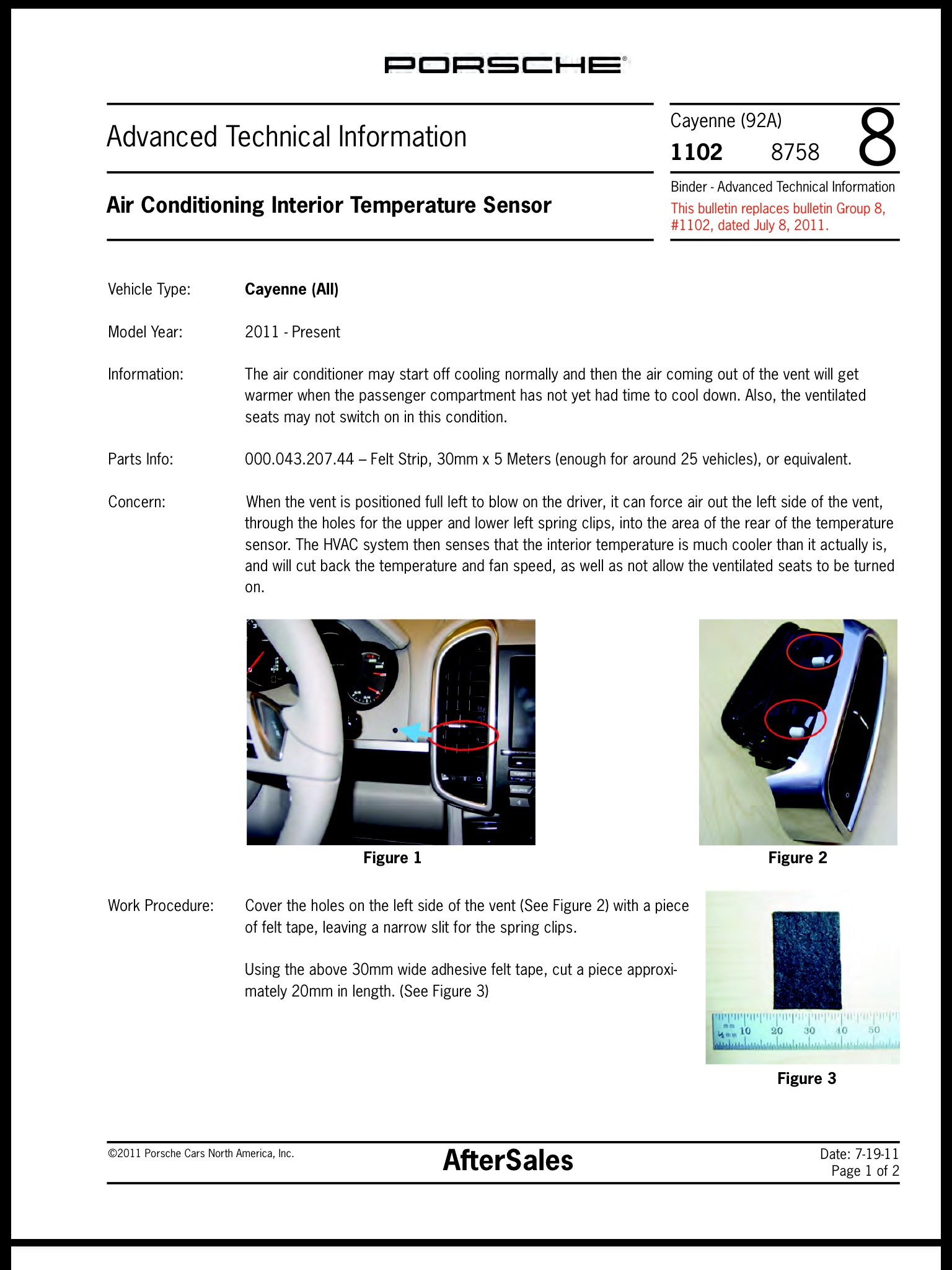

Update: HVAC issue
Originally Posted by JP911C4S
After 15-20 mins of drive, the drivers vents blow cold air (it was hot air when I first start the car) and continues to blow cold air. If crank up the temp setting, goes back to hot air for 10-15 mins then turn into cold air again.
I heard there are a bunch of servo-controlled motors behind/under the dash that control and regulate airflow.
Recently, I had "all wheel sys fault" and a dealer replaced the servo motor.
Do you think it's another servo motor issue? All inputs are welcome.
Damn, I just bought this car... ~37,000 miles. Hope it's under warranty.
Thanks!
For sake of clarity, I meant the repair itself should be under warranty; not all repair would be. Anyway, I got my service.
No faults.
Check all sensors and mechanical airway/vents - ok.
They were able to reproduce the problem; only the driver side center vent blows a cold air after 15-20 minutes - very puzzling.
They were going to replace the blower, then the foreman came and told a tech & service advisor not to. He told them he has seen this issue with several of new Cayennes (the temp drops 8 degF).
The service advisor call and wrote an email to the Porsche NA Tech Engineering to ask for help. It's been few days ... Nothing yet. Don't tell me this could be a design flaw...
Stay tune.

Yes. No more cold air. I found a Technical Bulletin on it (I don't have a copy). I gave it to the service advisor and he finally resolved it. Well, not completely to my satisfaction, however.

Originally Posted by scarneva
You wouldn't happen to know the TSB number, or the title?
See attached. Good luck!
