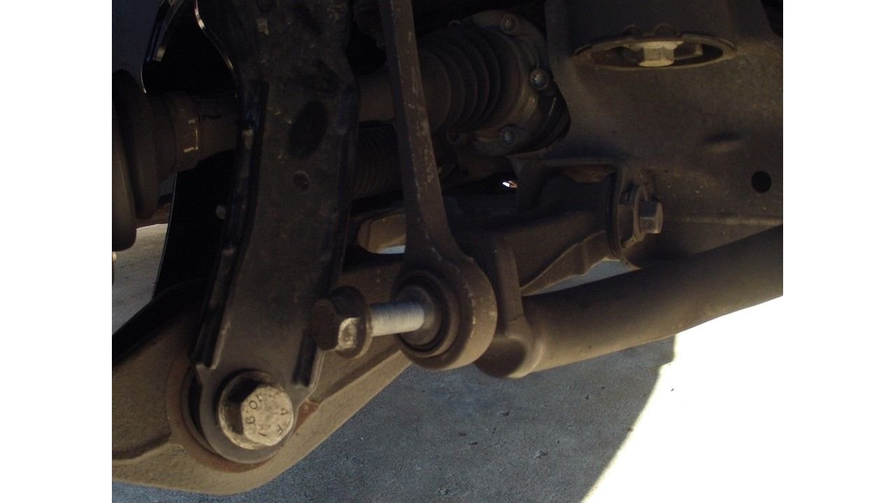

TIP2: When going back to dial in the damping after your first, second or third test drive, put the front of your Cayenne on jack stands, don't just lift one side at a time to make adjustments, because you have to fight the tension from your sway bar.
TIP3: You only have to remove the sway bar bolt, this will allow your suspension to drop enough for you to get your fingers in to make adjustments. Remember to tighten that sway bar bolt at 1g. That means wheels on, jack stands removed and vehicle resting on the suspension.

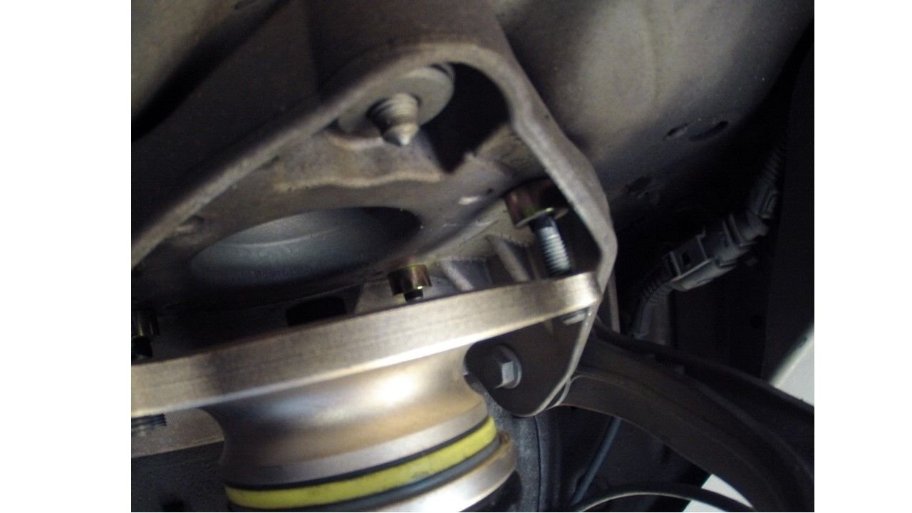

Easier way to adjust front damping setting
1. Lift front end and place stands in the proper area on each side of the vehicle
2. Remove wheels
3. Loosen qty 4 damper nuts from body studs
4. Now do the same for the other side
Since both dampers are connected to the sway bar, disconnecting each damper from the body will allow both of them to drop at the same time and it leaves just enough room to get your index fingers from each hand in to do your adjustment.
5. Dial in your desired adjustment
6. Assembly in reverse order and don't forget to torque.
Thanks for reading.
