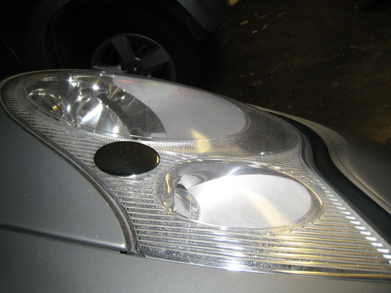

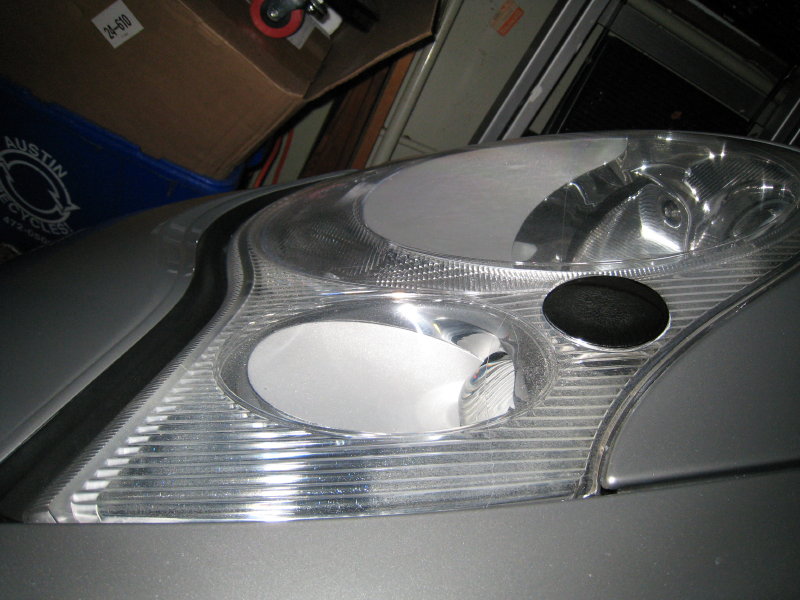

ok. no before / after shots, but i think i got decent unpolished / polished shots comparing the left and right sides.
below is the drivers' side headlight which i haven't yet sanded/polished. the rash is most visible in this picture towards the front of the lens cover by the rubber trim.
below is the passengers' side headlight which i polished. there's still some rash above the fog lamp, but 80-90% is gone. (those places in front of the lens cover where the paint looks marred are just reflections from the flash.)
