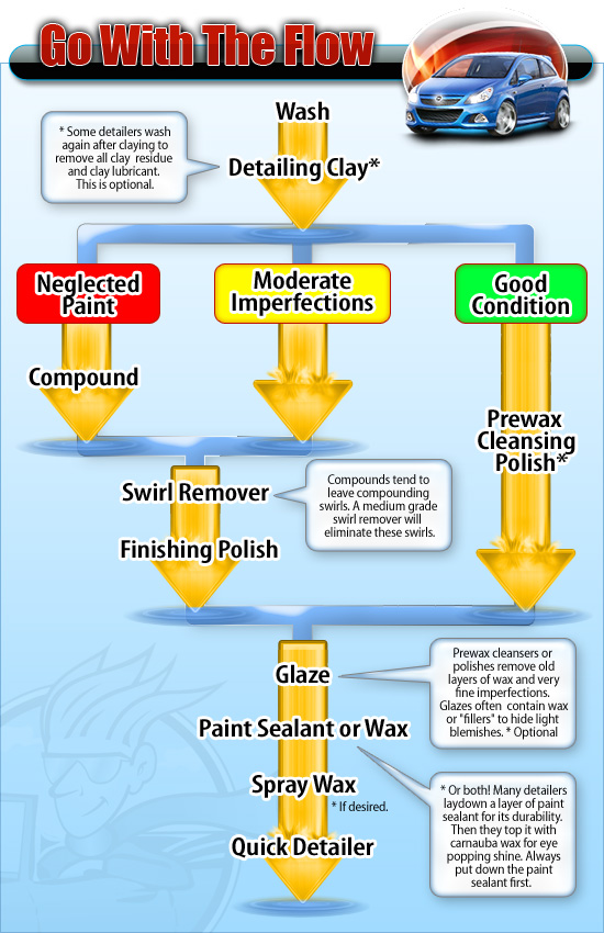

I understand that Clay is a must prior to Polish and Wash. However is a Polish and a Wash REQUIRED after a clay to restore the outer protective layers? Or can you simply just clay the car and call it clean after a final rinse?
This should help:
If you clay, then it's always best to polish right after. Clay does a great job of removing contaminants and cleaning the paint, but it doesn't do anything for bringing out gloss and depth of the paint. That's where polishing comes in. Then, polishing doesn't do anything for protecting the paint, that's where wax comes in. Go out of order, and the process will not yield optimal results. Make sense? Great question
A polish is not required after a clay one of the reason to polish a car is to remove imperfections that are in the paint. After claying the car I always apply a wax or a sealant to protect the paint.
Unless you're pressed for time, it makes no sense to bypass the most important step in maintaining your car, which is polishing. Polishing is what truly brings out the shine, depth, and brilliance of the paint. It's the pre-curser to a proper bonding of a wax. If you're short on time, or expectations aren't for optimal results, you can bypass polishing and simply wax.
Claying really is only necessary when you're ready to polish and wax. If you're doing maintenance, and in-between washes, all you really need is a good spray wax to keep the paint in pristine shape.
If you're claying, it's usually because it's time for the semi-annual, or quarterly detail depending on the use of the car. So, if you're claying, you're simply taking off contaminants that cannot be washed off. Things like light oxidation on the paint, tree sap, tar, rail dust, brake dust, etc.
Once contaminants are removed, the proper step is to polish and remove light swirls/scratches if any, then wax. If there aren't too many imperfections, a quick paint cleanser will do the trick, then you wax.
As with any detailing routine, it can vary between car, geographic location, and client time/skill.
