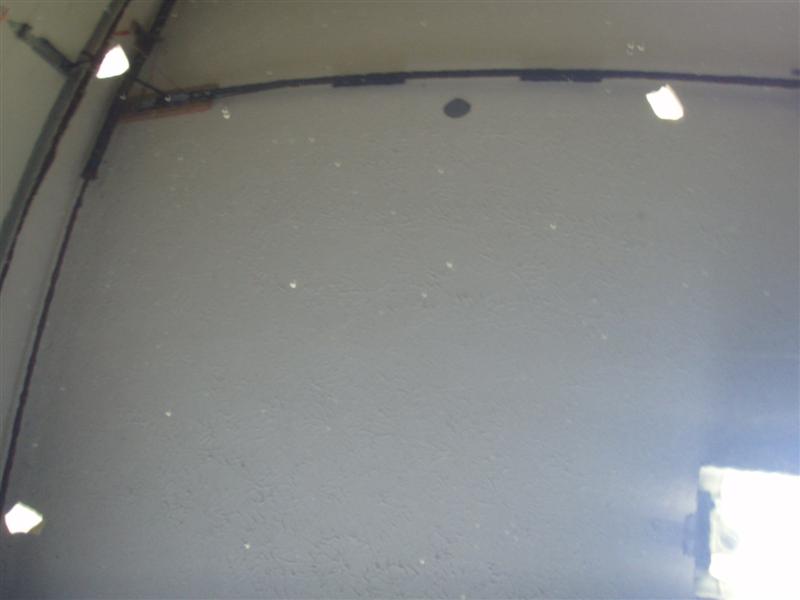

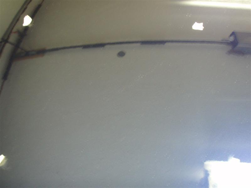

I purchased both products and had a go with them. IMO both products are good,,, not perfect. More of chip hiding, some come out very well . I tried the Langka first with mixed results. I think the Langka would work best with "real" stone chips. I did not have many. Most of my defects were very small. On to the Drcolorchip. This product worked well for me. I didn't have and clearcoat problems with it as feared. I accually got to the point that I enjoyed using it. Just smear the stuff on, I waited an hour then buffed off. Works well to hide road rash. I could not make an error with this stuff and the color match was very good. The car is a 996 tt with midnight blue metalic paint. One draw back is I am doing this in my garage under floresent lights. The color looks like a good match under the lights. I don't know what it will look like in natural light. Also the more you use it the better you get at it.
For my car, my skill level, color, type of defects the drcolorchip wins hands down. I am going to try the Langka on my S4. I have a couple of real chips on that car.
I learned that I really suck at taking pictures. Here is an attempt at a b4 and after shot.
