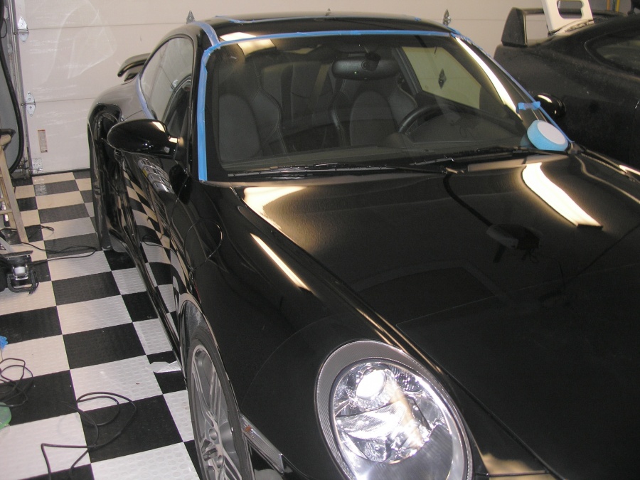

A work in progress...
Yes - it's 9 degrees outside
Yes - my garage is insulated
Yes - thank goodness for propane heaters
I love your level of enthusiasm...good job taping the trim. Looking good so far, make sure you take final beauty shots outside. Keep up the good work.
Thanks Moe.
I can't believe how freak'n cold it is this December...We're seeing January weather a month early. It's a little painful to detail a car in this weather, but thank goodness for propane...
More pics to follow.

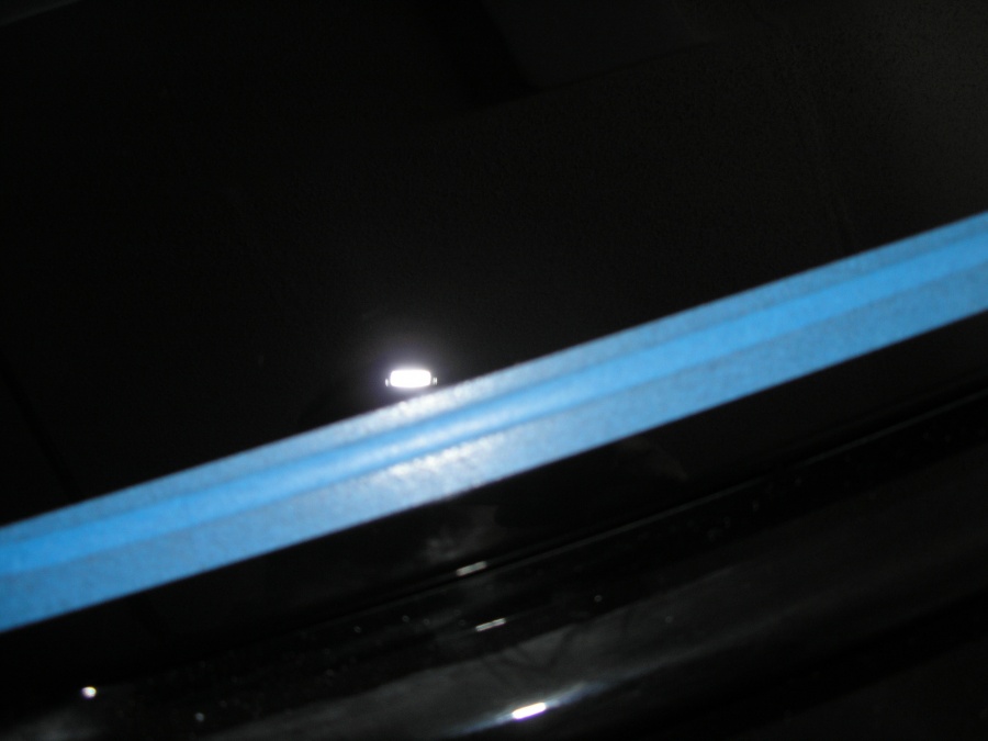

Reasons to a water deionizer (and the Flex)
Perfect example of why you should have both a water deionizer, and a Flex orbital polisher.
Before and after...
These are spots on my rear decklid using water filtered with a iron filter, Sodium exchange water softener, and finally, my CR Spotless DI resin which I had stupidly allowed to saturate to about 56 ppm tds.
The first picture are the spots after attempting to get them out with my PC and PO85RD.
Second picture are spots after 2 passes of my new Flex and PO85RD...once with a green pad (yes green and PO85RD!) and then a white pad.
