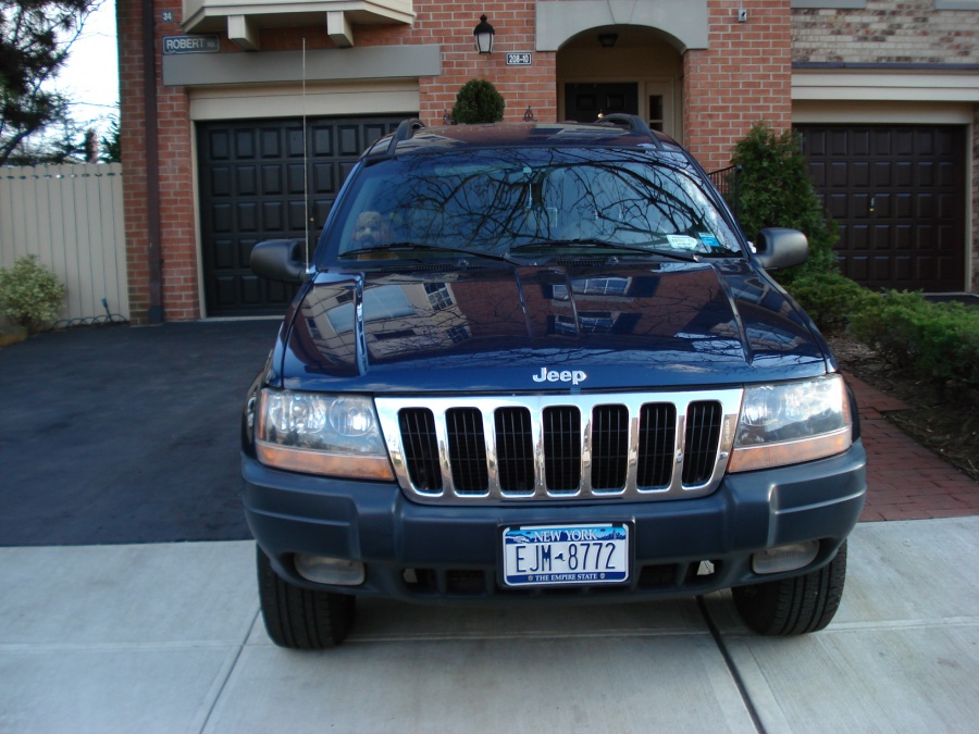

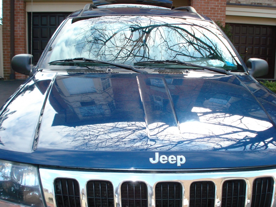

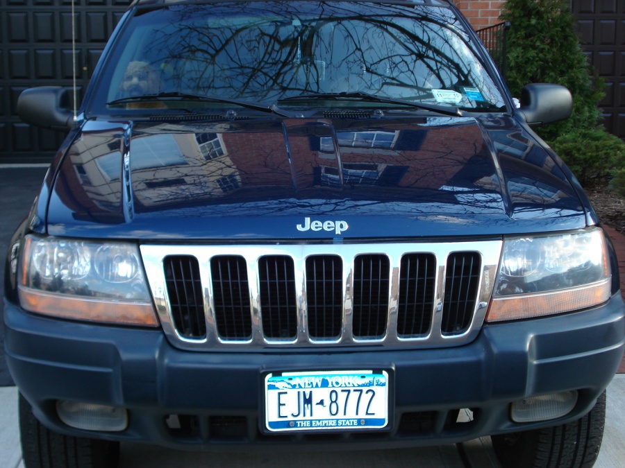

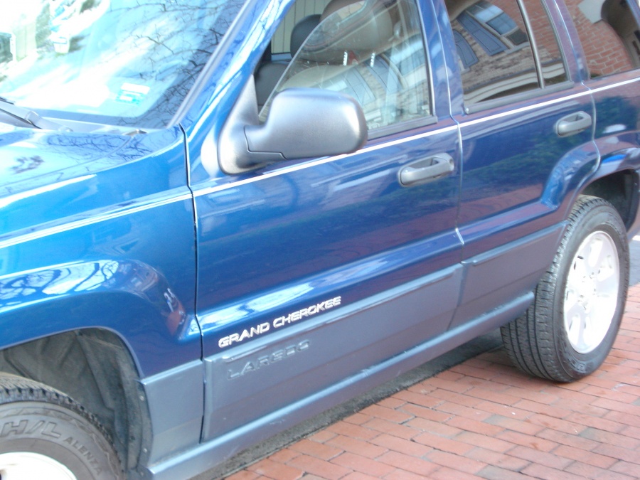

Before and After
i used the menzera and the flex (with the orange uber foam pad..)
i know the orange pad is a bit agressive, but this car needed some love..
.. i am very impressed.. first time using a machine polisher.. took me a little more than 3 hours.. tomorrow i will try it on the porsche.. or x5.. fingers crossed..
thanks gentlemen..

Yeah, that generally tends to be the case. So you play around with the aggressiveness of the pad and balance that with the aggressiveness of the polish. One thing to realize when moving on to another car for the first time is that the paint on different cars may not be the same hardness so a process that you find works for one car may not give the same results with another. Just keep trying and figuring out what works best for each. Then you will kind of "know" what to go to for each car.
The jeep looks great from what I can tell! Did you polish the whole thing, or just the hood?

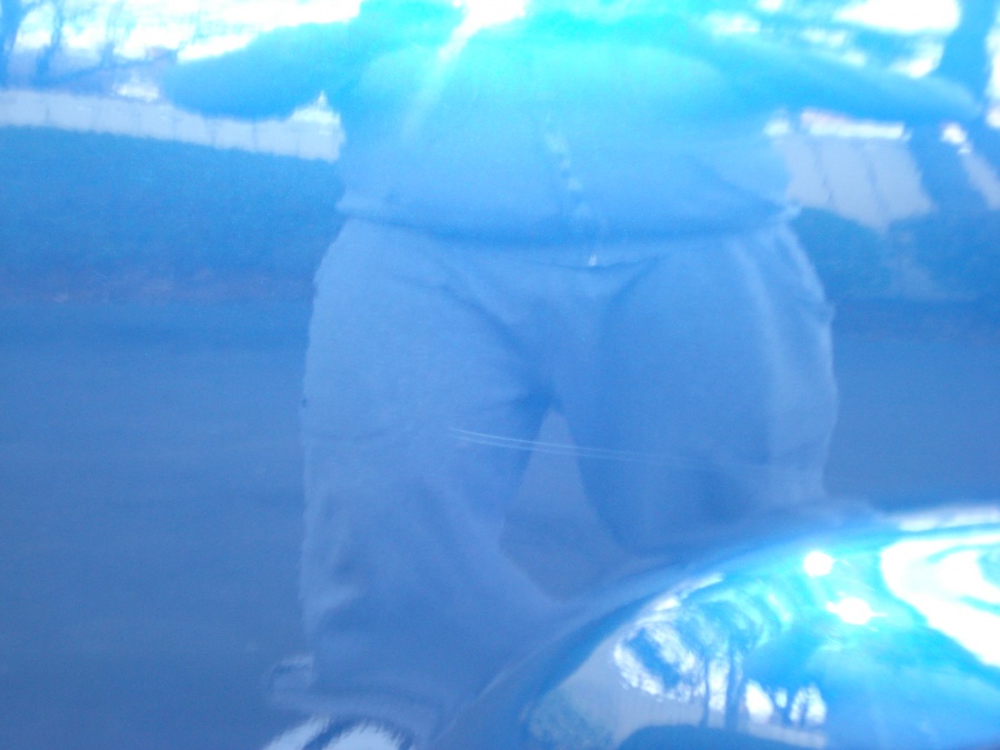

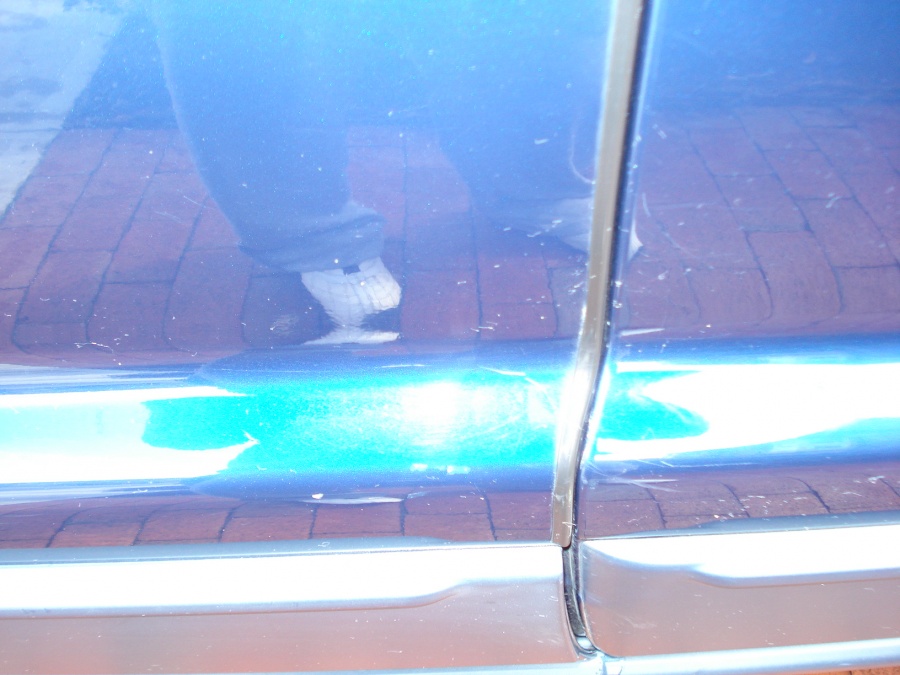

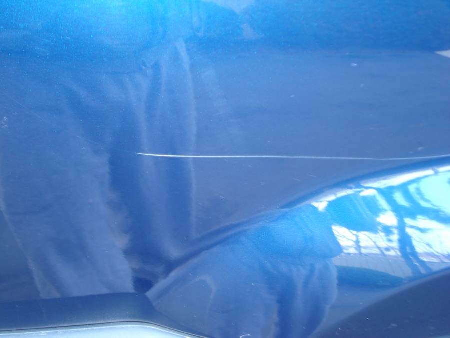

attached are the rest of the pics.. someone scratched the rear quarter panel like a month ago, and i really tried to get that scratch out.. i was able to get most of it out..
the flex was pretty easy to use but the vibration was pretty intense.. i thought it was going to come with the SoftVib handle but unfortunately i didnt see it in the pack.. of what i read most people dont like to use it.. any tips? and do you gentlemen know where we can get one?
