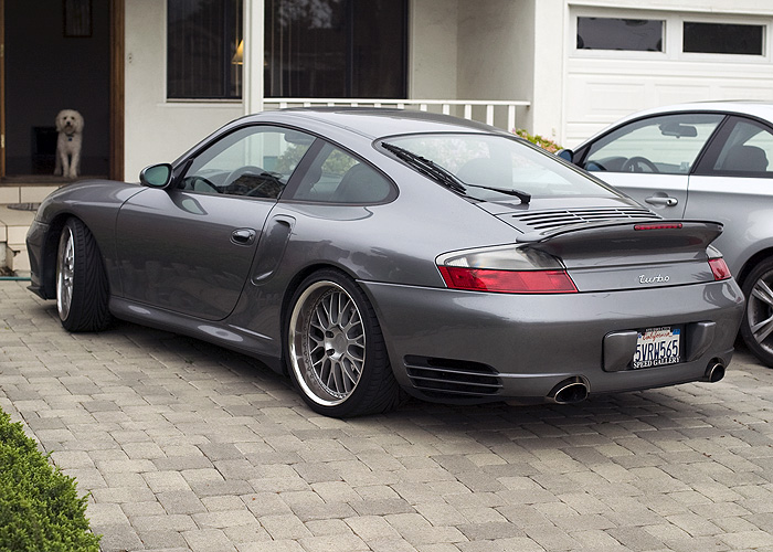

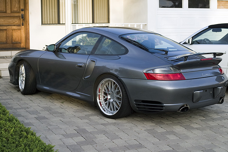

Little scratches came out in the polish phase unless you look really hard. It might not have been me, even. Anyway, all done. 10 hour project. Yikes I'm tired and my arms hurt lol. Here's before and after. It's hard for me to tell a difference in the pictures, but in real life it looks really sweet now. Hope it keeps looking good for a while with just a wash and wipe down. Thanks all for the help.
I can TOTALLY tell the difference!!!
The wing is up on the after shots!
Looks great. And to be honest, it does look a bit more glossy. Hard to tell without closer shots.
