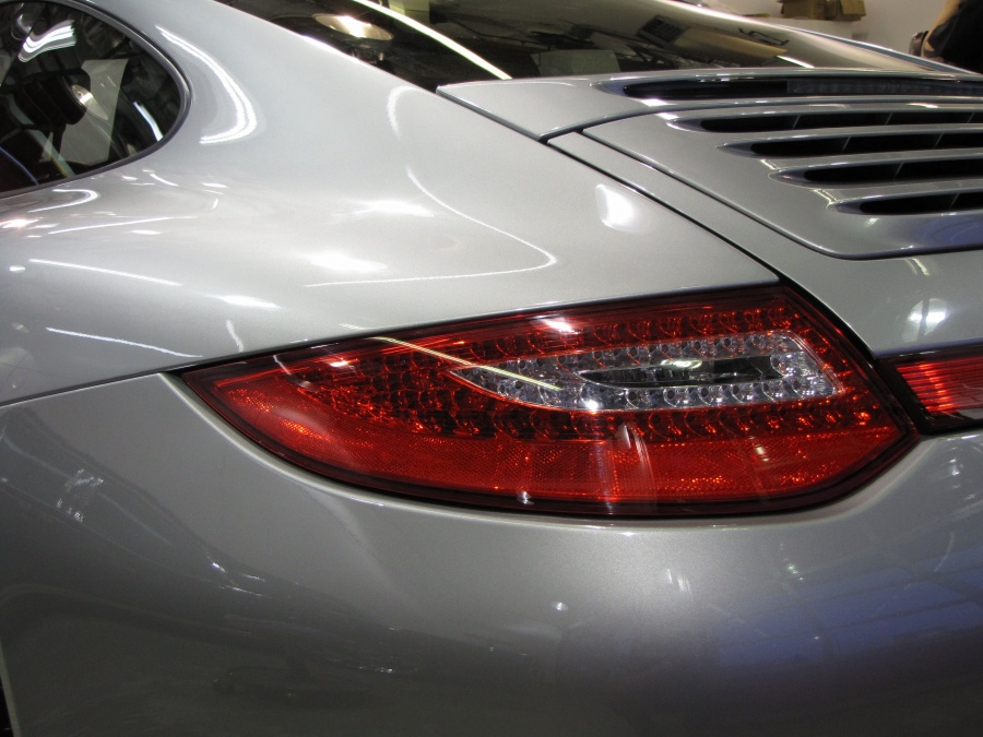

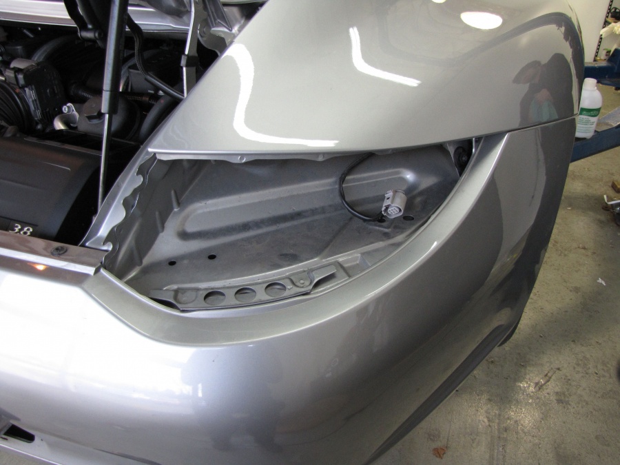

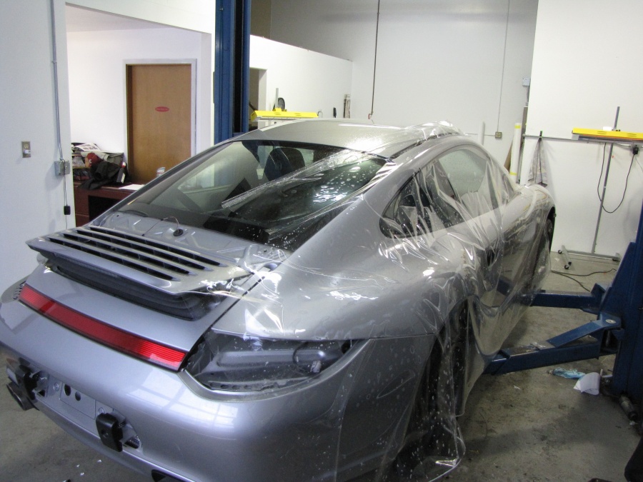

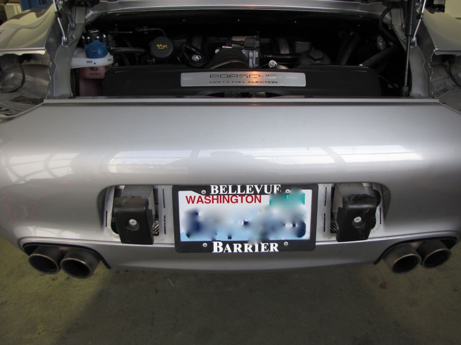

When some people buy a Porsche C4S, it never sees more than a few raindrops a year. This one however sees mountain passes, and even came in with snowtires installed. Pretty cool to see such a capable car being used for this. The best way to protect a vehicle like this is with Venture Shield. An 8 mill urethane film that protects from everyday rockchips and abrasions. Check out our custom installation.
At Metropolitan Detail we offer "Lifetime Free Film Wax", with a fully wrapped vehicle, this customer is going to take full advantage of this and have his car waxed regularly at no charge.
In these few first pics you will see we remove the roof rails, and the sunroof felt, this enables us to wrap the film inside the roof rails before they are reinstalled, and also into the sunroof, and the sunroof panel is wrapped seperately before reinstalling the sunroof felt. The rear bumper was removed to remove the bumperettes, as were the taillights, this enables us to wrap the film when installing film on the rear bumper.

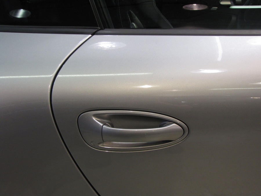

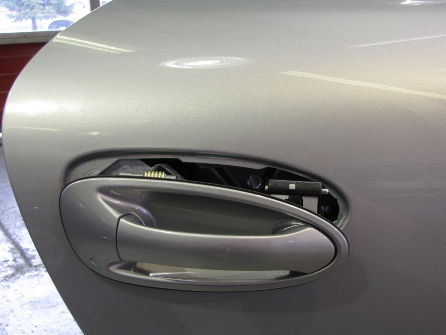

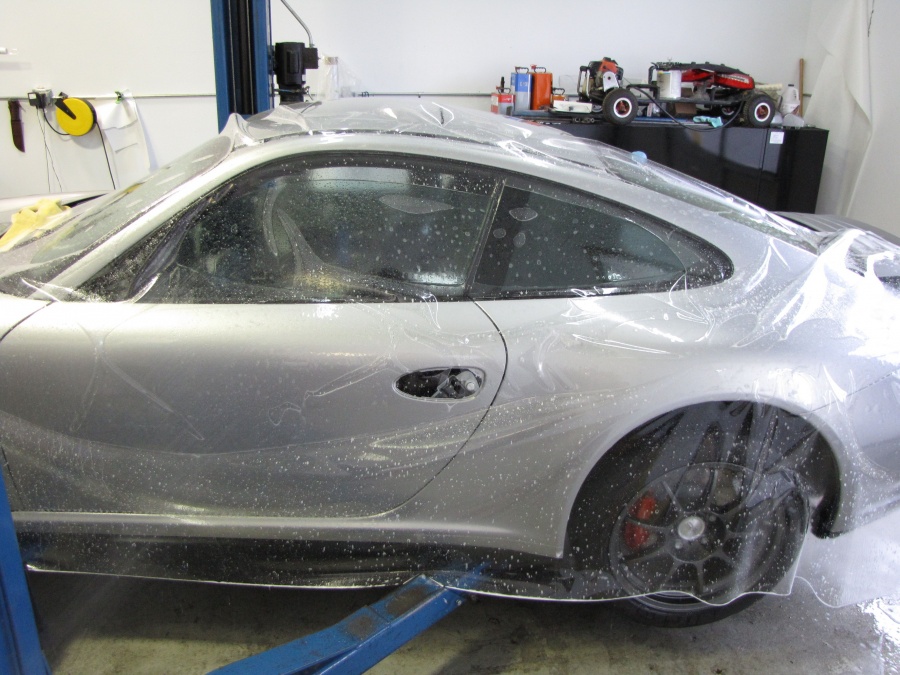

As you can see here, more removal of parts was necessary for the perfect installation. The exterior door handle and mirror were removed so the film would lay flat, and also wrap into the door handle before reinstalling. We also removed the rear reflector so the film could wrap into the spoiler area, and under the rear reflector. The rear spoiler was also wrapped.

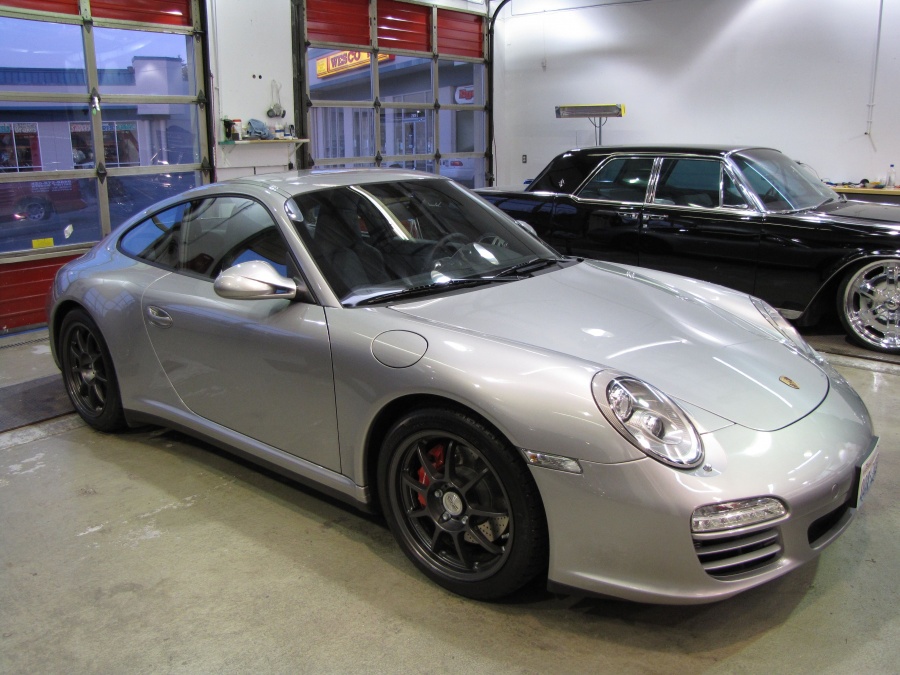

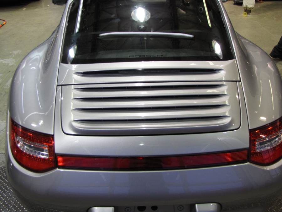

The finished product. You can see all parts have been reinstalled, and all film has been wrapped. Now just gotta wax the film and car will be finished. I will post pics of car after wax tomorrow.
