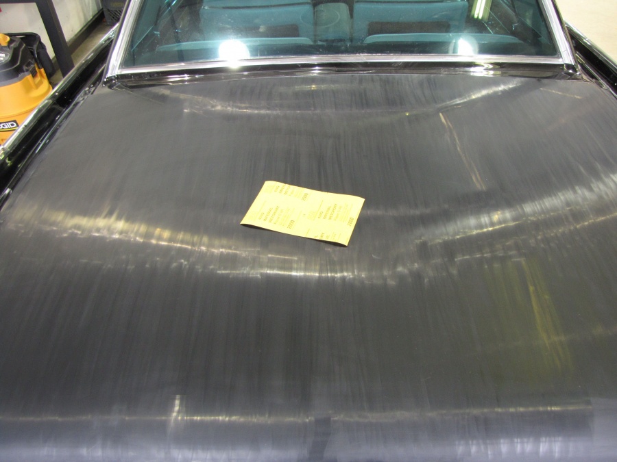

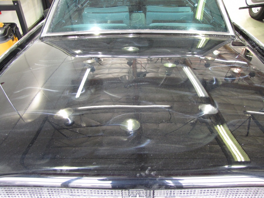

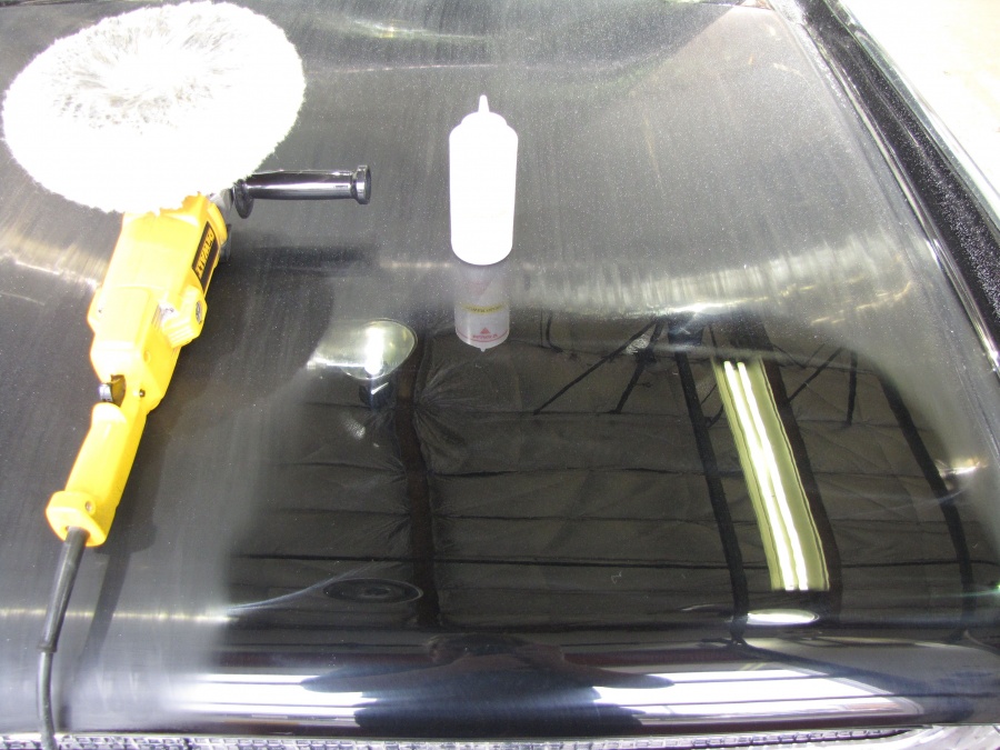

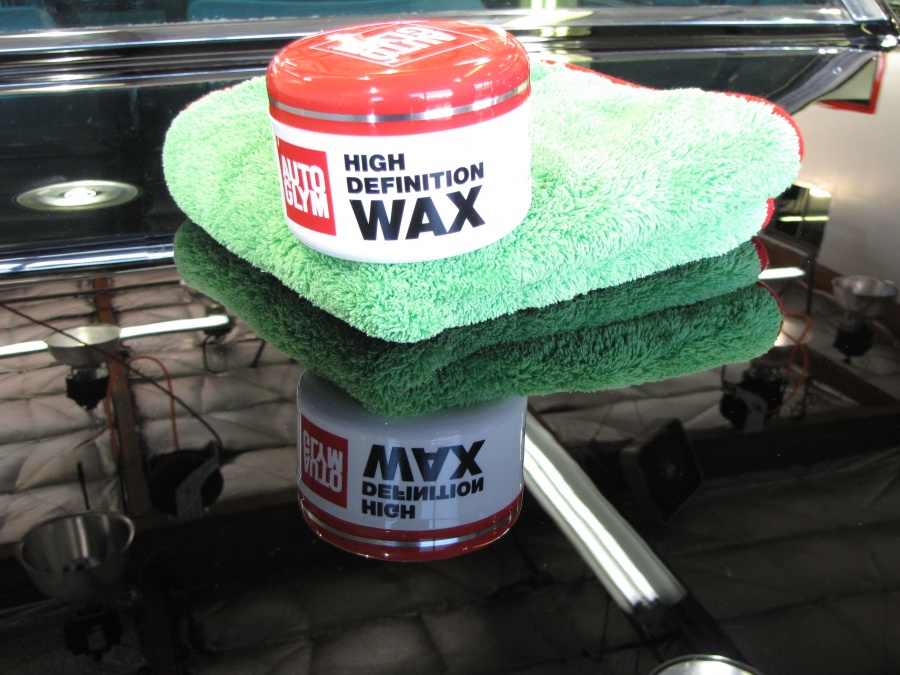

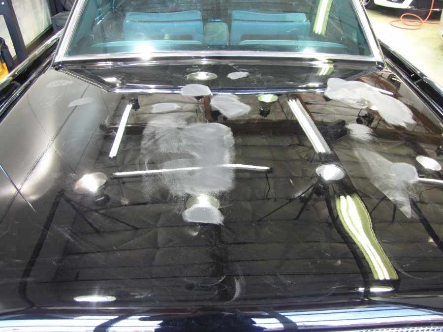

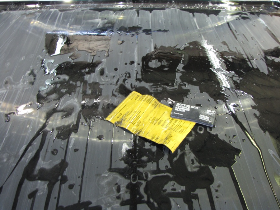

A good customer of ours has this beautiful 1961 Lincoln Continental 4-door. He has a small rust blemish on his trunk so he had the trunk resprayed. The paint was laid nicely with no dry spots, but I did have to nib out quite a bit of dirt. I nibbed the dirt with 1000 grit sandpaper and a D.A. I then blocked the whole trunk with 1500 grit wet and 2000 grit wet. I then polished out sanding scratches with a white "aggresive" wool buffing pad with Menz. Power Gloss, went to an orange CCS pad with SIP then finished with white CCS pad and Super Finish. Topped with Autoglym HD wax.

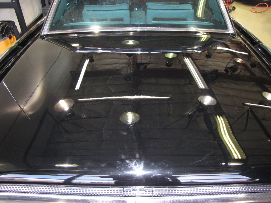

Included here are some after shots. You will notice that the reflections are vivid and clear after the orangepeel has been removed.

Great job as usual John...I liked the shot of the ceiling...doesn't look like much orange peel on that finish.
