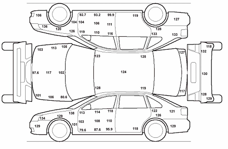

Here are the measurements for a 996 GT3 (ignore the rear doors.)
That's great! Thanks for the visual. That's about the typical reading you should see on a Porsche that hasn't had its paint thinned over the years by improper machine polishing. Those are great numbers to start with and you can usually get a good paint correction by removing a few microns,1-3, of clear.
