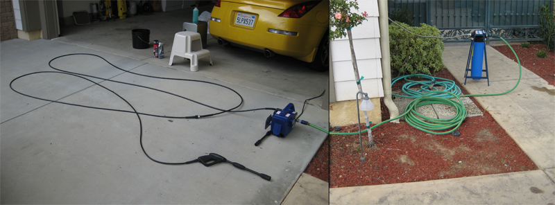

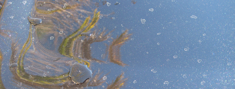

Old Feb 15, 2014 | 07:19 PM
  #28
LakersCentral's Avatar
Joined: Feb 2014
Posts: 9
From: So Cal
LakersCentral is infamous around these parts
I bought a DI-120 system a month ago (same resin capacity as the DIC/W-10). The first 3-4 washes were great (though the rain and sprinklers quickly ruined things). For the 5th wash, the meter on the CR system initially jumped into the hundreds, but only for a few seconds. Then it returned to 0. Still, water spots galore. I live in southern CA, and I know our water here is notoriously hard. However, I didn't expect to only get 4 washes out of it per resin pack!
Thanks for the recommendation on the HM Digital water tester. I plan on testing the water after its gone through my whole system (i.e. the water that's actually hitting the car). My system is set up as such: from the water spigot, into the DI-120, through a standard old garden hose, to an AR118 pressure washer (1.5GPM). The first (wash) pass goes through a foam cannon filled with a 10:1 ratio of distilled water and Chemical Guys foam . At all times, the water is passing through the CR system first.
As you can see, I've taken every precaution I could imagine to ensure no water spots. My foremost concern is not the number of washes I am able to get out of fresh resin (though its a close 2nd)... but rather why I'm getting water spots at all when the DI-120 TDS meter is showing 0!

Update: I bought an external TDS meter, and tested the water. My normal water was lower than expected, at 250. After going through the CR system, their "internal" meter read 75 (and was steadily rising at ~1 per 2-3 seconds). After traveling through my whole system (i.e. CR, garden hose, pressure washer), the external TDS meter showed 100. So either the internal CRS meter is off, or I'm somehow picking up 25ppm along the way. Next step is to pick up a new super high quality garden hose.
