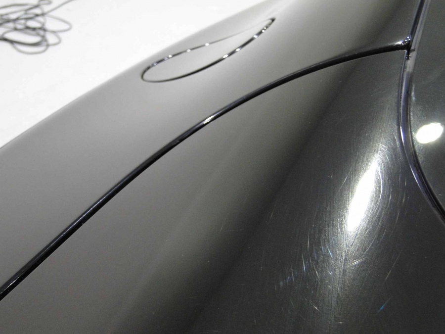

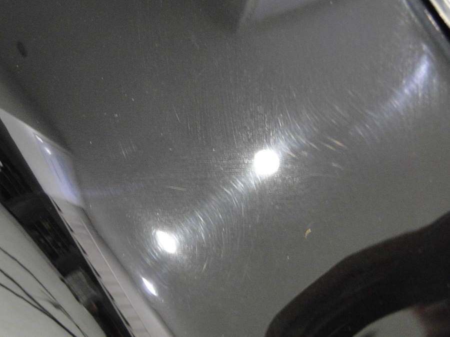

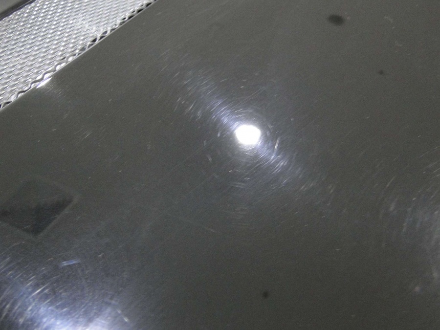

the cars paint condition before the job started
this was the cars condition before the job

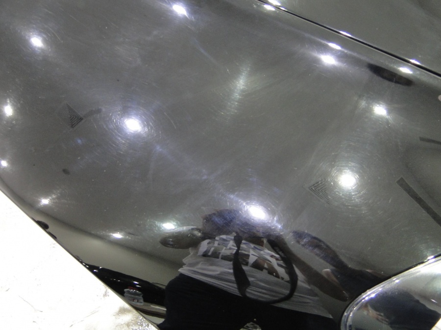

more pics

WOW!!! That's terrible. I can see why they compounded. Well, let us know how it comes out. Like I said, a reputable shop will do anything to make their client happy.

wow that car was in BAD shape..........

well i do live in a very dusty city cant help it they didnt compound it yet they used a couple of mild compounds and hd clense 1 thats all they did in the last 2 polishes .
this time they said they will use the scholl medium cut compound to remove all scratches . if still they didnt do a good job with the swirls and the buffing marks then ill ask for my money back .
in all cases am still intrested in the menzerna and the flex . ill try doing my other cars before the aston .
so the car is with them ill c whats the outcome
what causes the buffing marks ( holograms ) ?

This is a good example of why its important to wipe the paint down with some type of paint cleaner/ solvent to remove any oils which are hiding the remaining imperfections. If a detailer is not doing this then there may be temporarily hidden imperfections (holograms, swirls, etc.) remaining in the paint. (Yes this happens with Menzerna polishes too!)
Yes that paint needs to be compounded.
Holograms are typically caused by inexperienced rotary users and a failure to complete the polishing process correctly. Some types of paints are also more prone to holograms than others.
It blows my mind that it took them 6 days to do, cost you 2500, and all they used were mild polishes which did not correct the paint. And the fact that there are now swirls in your chrome trim and headlights tells me they might not have taped the car off.

Even worse? WOW! Those before pictures are the worst condition AM I have yet seen......looks like it was dragged with a towel over with sand from the desert still on it!!!!
Black looks great on this car, but silver does too and keeps the swirls down.
Good luck with it, a competent detailer can get this fixed but all this work will continue to take down the clear.

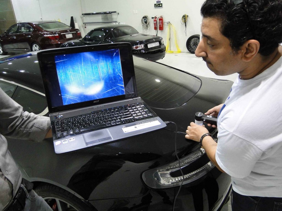

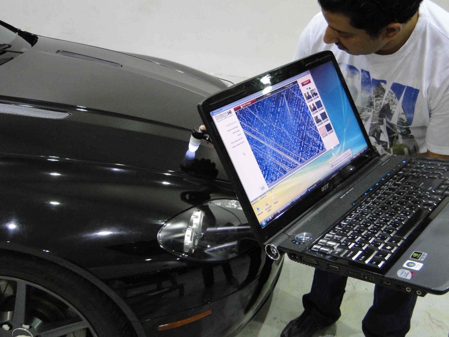

Does anyone knows what type of machine is that? (for the laptop) brand name and type?
Old Sep 11, 2010 | 06:11 AM
  #29
detailjohn's Avatar
Joined: Feb 2008
Posts: 1,460
From: Bellevue
detailjohn is a splendid one to beholddetailjohn is a splendid one to beholddetailjohn is a splendid one to beholddetailjohn is a splendid one to beholddetailjohn is a splendid one to beholddetailjohn is a splendid one to beholddetailjohn is a splendid one to behold
It is a USB Microscope. You can pick one up for about $100.
