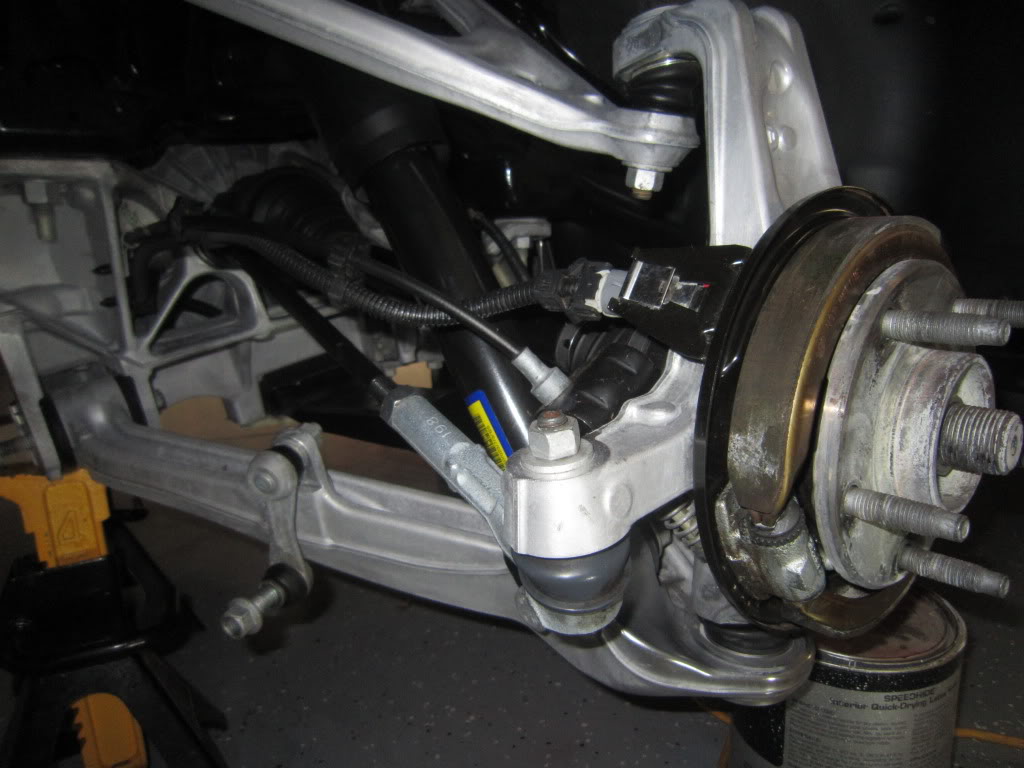

a) Undercarriage cleaning- thoroughly spray an undiluted citrus cleaner (P2IS Total Auto Wash) and let it soak in; remove by thoroughly rinsing with water. Fill pressure washer tank with citrus cleaner and spray undercarriage (do not use excess pressure as water may penetrate crevices and seams where it cannot drain, causing corrosion), let it soak and then remove with plain water.
b) Undercarriage Salt Removal - spray undercarriage with ValuGuard Proguard Magnesium Chloride Remover - VG-502 - An alkaline (pH 12) liquid concentrate, a blend of detergents that penetrates and disperses road and salt film, which after rinsing leaves the surface charged to repel dirt and soil. Low foam for better penetration into seams where Magnesium Chloride is difficult to remove
Cleans Magnesium Chloride residue from all surfaces and will help brighten aluminum surfaces without etching and also works well to remove bugs, tar, and asphalt. Designed to be applied by brush, moderate or high pressure spray, and can also be used in steam cleaning applications. Product is completely biodegradable
Do not allow to dry on vehicle. For cleaning tough areas like wheel wells, chassis, and very soiled wheels apply VG-502 at 1-1 mix to wet surface, allow to set for 3-5 minutes, Agitate as needed and then rinse with moderate to high-pressure water spray for a clean surface. Dry all painted and glass surfaces after rinsing to prevent water spotting.
