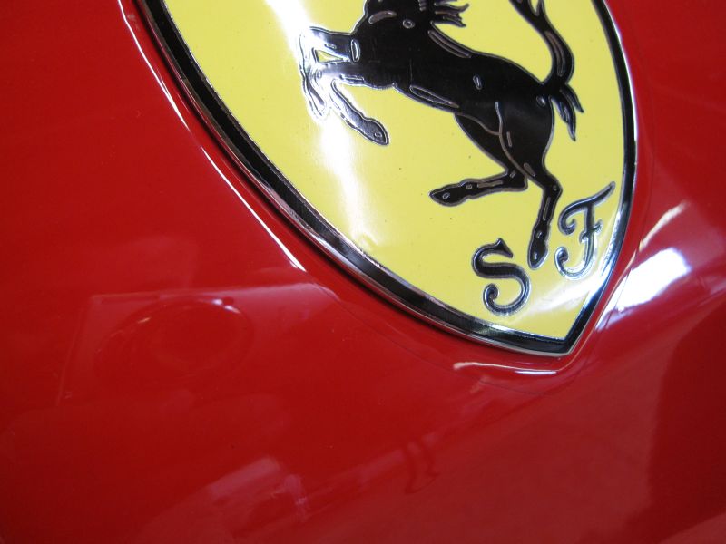

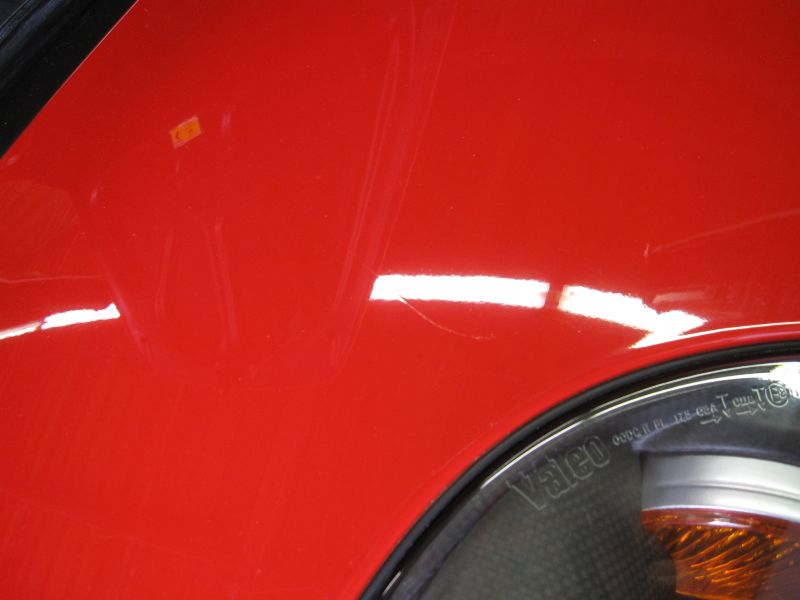

Issues with the film on the full fenders performed by the previous installer:
1. excessive dimples
2. silvering
3. excessive stretch marks

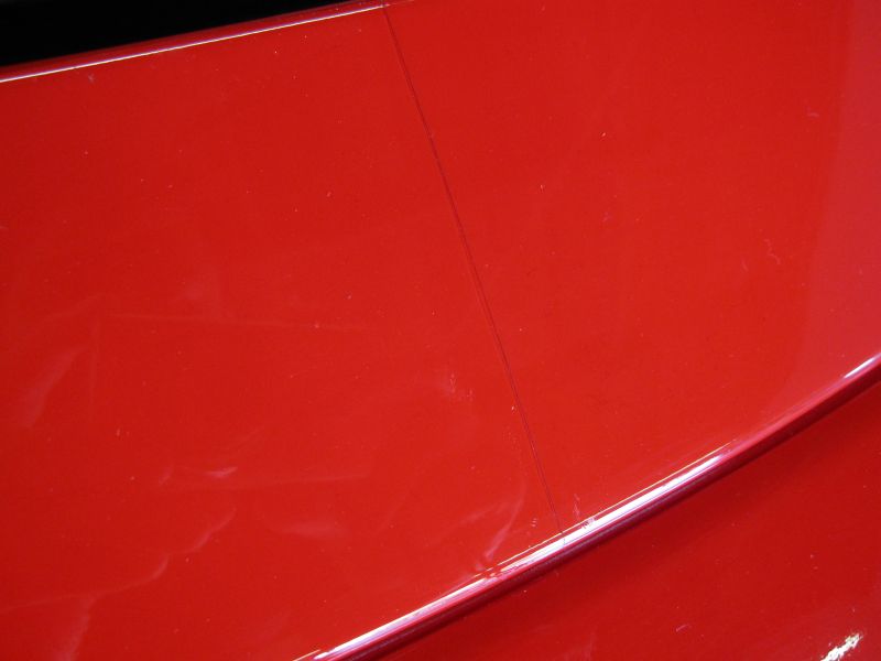

4. joint seam under the hood emblem
5. open gaps of 3mm-1/4"
6. edges were not wrapped
The customer was most unhappy with the stretch marks and dimples. The previous installer utilized a precut kit for the application and was a 2 piece application with a joint seam directly under the hood emblem.
We do want to note that the full front quarter panels on the F430 or Scuderia are very difficult, so it was no surprise to us that there were so many visible installation flaws.

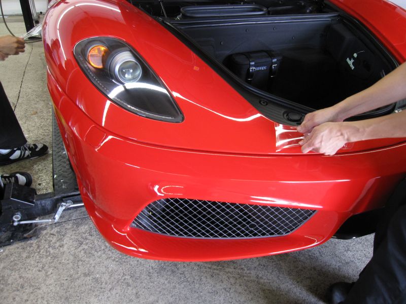

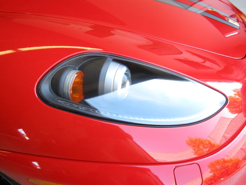

During removal, we noticed that some of the leading edges that were not wrapped were starting to show wear from rock chips. Fortunately for the customer, our application will consist of wrapping the edges wherever possible

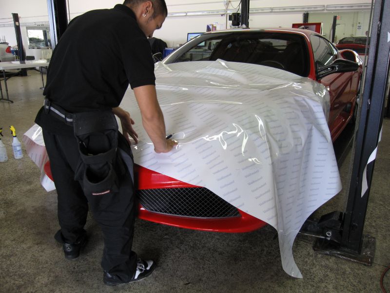

Here is the start of our install

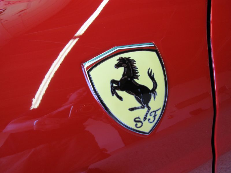

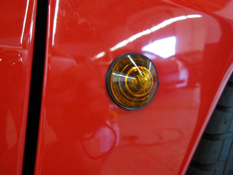

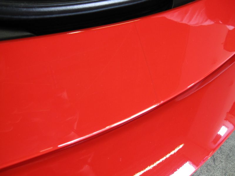

Some shots of the Scud completed and close up shots of our custom application to the previous installation (Precut)
